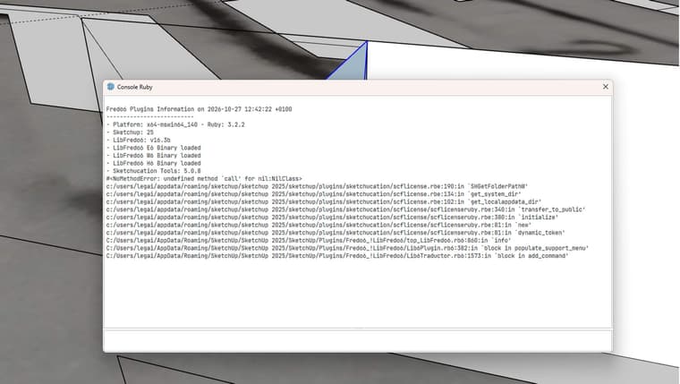

              goyatea Newcomers
              The installation did not work for me. I received an error message when I tried to use the add command. Any ideas?
                Rich O Brien Moderator @goyatea
                Please share the error message, your SketchUp version and Operating System
                • G
                  goyatea Newcomers
                  Ruby error message :
                  Fredo6 Plugins Information on 2026-10-27 12:42:22 +0100
                  • Platform: x64-mswin64_140 - Ruby: 3.2.2
                  • Sketchup: 25.0.571
                  • LibFredo6: v16.3b
                  • LibFredo6 E6 Binary loaded
                  • LibFredo6 W6 Binary loaded
                  • LibFredo6 H6 Binary loaded
                  • Sketchucation Tools: 5.0.8
                    #<NoMethodError: undefined method call' for nil:NilClass> c:/users/legai/appdata/roaming/sketchup/sketchup 2025/sketchup/plugins/sketchucation/scflicense.rbe:190:in SHGetFolderPathW'
                    c:/users/legai/appdata/roaming/sketchup/sketchup 2025/sketchup/plugins/sketchucation/scflicense.rbe:134:in get_system_dir' c:/users/legai/appdata/roaming/sketchup/sketchup 2025/sketchup/plugins/sketchucation/scflicense.rbe:102:in get_localappdata_dir'
                    c:/users/legai/appdata/roaming/sketchup/sketchup 2025/sketchup/plugins/sketchucation/scflicense/scflicenseruby.rbe:340:in transfer_to_public' c:/users/legai/appdata/roaming/sketchup/sketchup 2025/sketchup/plugins/sketchucation/scflicense/scflicenseruby.rbe:380:in initialize'
                    c:/users/legai/appdata/roaming/sketchup/sketchup 2025/sketchup/plugins/sketchucation/scflicense/scflicenseruby.rbe:81:in new' c:/users/legai/appdata/roaming/sketchup/sketchup 2025/sketchup/plugins/sketchucation/scflicense/scflicenseruby.rbe:81:in dynamic_token'
                    C:/Users/legai/AppData/Roaming/SketchUp/SketchUp 2025/SketchUp/Plugins/Fredo6_!LibFredo6/top_LibFredo6.rb6:860:in info' C:/Users/legai/AppData/Roaming/SketchUp/SketchUp 2025/SketchUp/Plugins/Fredo6_!LibFredo6/Lib6Plugin.rb6:382:in block in populate_support_menu'
                    C:/Users/legai/AppData/Roaming/SketchUp/SketchUp 2025/SketchUp/Plugins/Fredo6_!LibFredo6/Lib6Traductor.rb6:1573:in `block in add_command'
                  • G
                    goyatea Newcomers
                    • fredo6F
                      Somethings is wrong is the installation of Sketchucation Tools.
                      Could you
                      1. go to the Plugin directory: c:/users/legai/appdata/roaming/sketchup/sketchup 2025/sketchup/plugins
                      2. Delete the folder Sketchucation
                      3. Reinstall Sketchucation tools from the Sketchucation site
                      Please advise if this does not work.
                      • G
                        goyatea Newcomers
                        Thanks, it's working now.
                        First, I deleted it, then I modified the signature authorisation in the warehouse extension. It was a signature issue.
