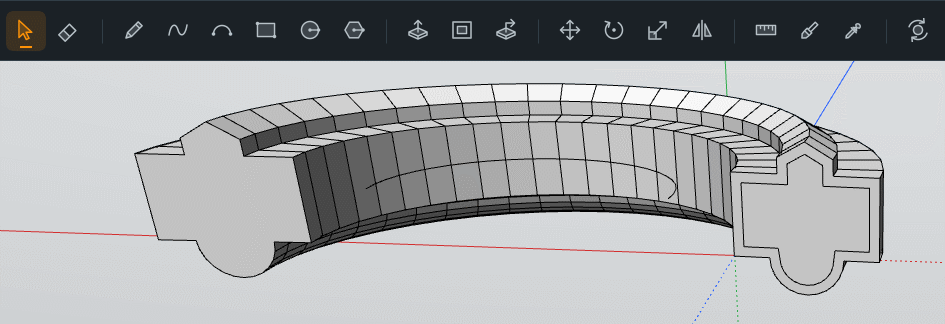

        I believe there is a little bug somewhere! πŸ˜‰
        There is just the last faces who are yet in place! πŸ™‚
        I have verified in hide them ! πŸ˜‰
        Very cool that you have keept original " */ " of the copy functions !
                I have verified in hide them ! ;)f
                @pilou You were right; that was a bug! Sweeping a face along the bar's own path now cuts a clean tunnel: the far end opens up instead of keeping that last face in place.
                A sweep that stops inside the solid still gives you a recess. Can you try it again on your model? Keep those bugs flowing. I'm drinking from the firehose.

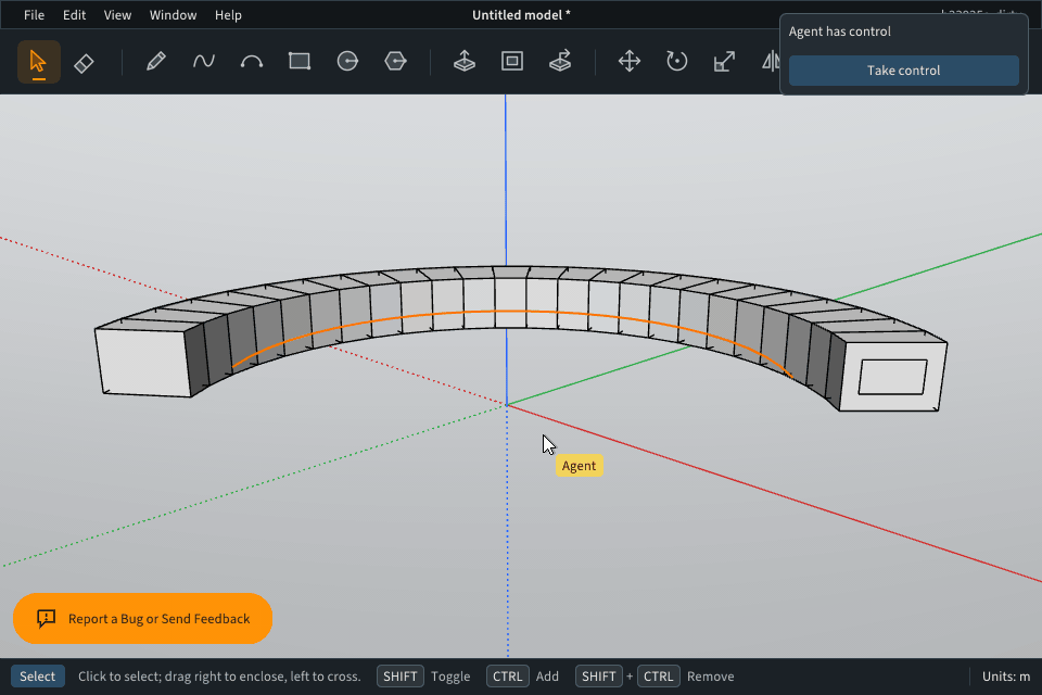

                  @pixelcruncher How the heck do you draw something like this. I am currently feeling really stupid and am not doing well. The object in the model looks kind of neat but I cannot understand how you drew it.
                      @ntxdave said:
                      How the heck do you draw something like this? So far, I am not doing very well when trying to draw objects that are not all that complicated. Is there some place I can go to learn how to use the drawing tools better?
                      Not really; you are on the bleeding edge with us. This software doesn't have documentation yet πŸ™‚ But a lot of your SketchUp skills should translate over. Note that it's all still very alpha, lots of bugs to bite you. But many eyes make all the bugs shallow.
                        Before you post i have verified on a more simple one ... that was a repetive bug! πŸ˜‰
                        Here modified by hands!
                        So I must return to your last version! πŸ™‚
