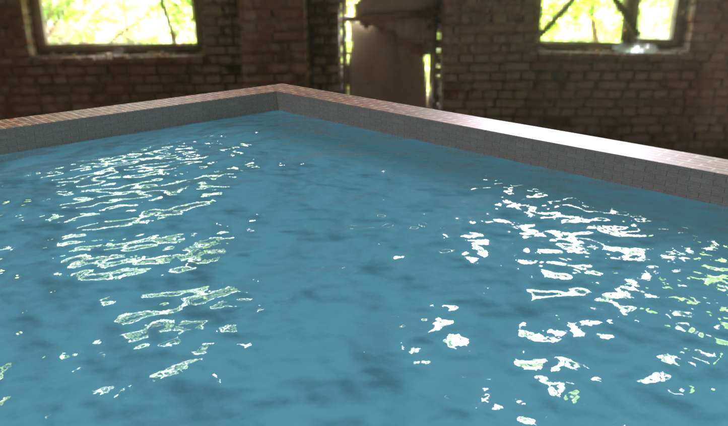

                          • KrassK Offline
                            Krass
                            here a test with PBR mode/color/no roughness/ and this normal map

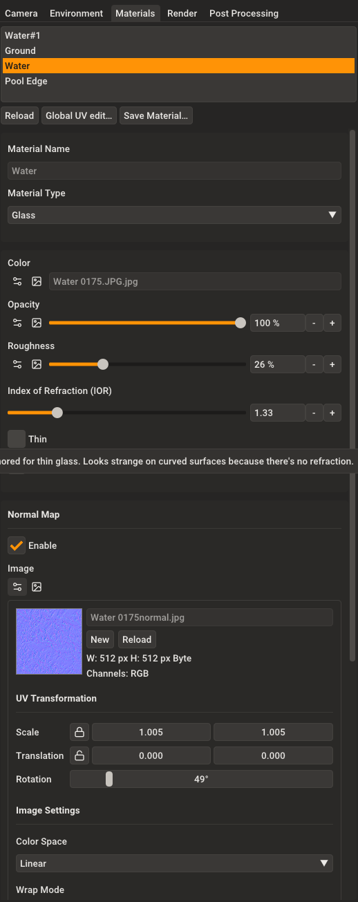

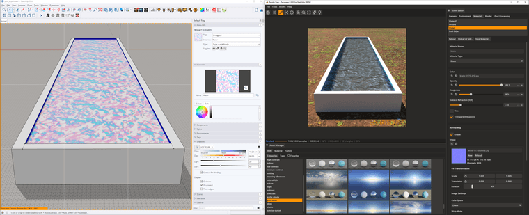

                                @Krass That's some nice looking water! And a great workflow.
                                I did a similar experiment. I used a glass material with an index of refraction of 1.33 (the IOR of water). I used a water texture I found online.
                                Here's how I set it up in SketchUp and Rayscaper:
                                And there are the details of the glass material:
                                I found the water texture here: https://www.cadhatch.com/seamless-water-textures
                                One of the upcoming releases, I will try to add a water material. It's such a common item in Archviz that I think Rayscaper should have one.
                                I hope this helps!
                                Cheers,
                                Thomas
