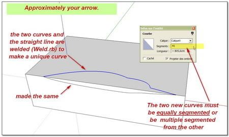

        Hi Ushumgal, hi folks.
        See this SU file for ideas.
        Arrow head.skp

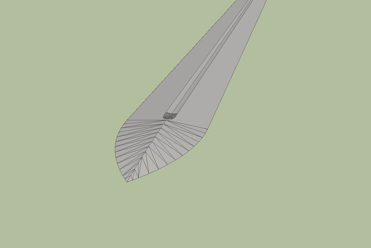

              Hi,
              there is method i used to model a sword. Maybe useful for you and very simple.
              Karlheinz
              Speer.skp
              Klinge.skp
              • U

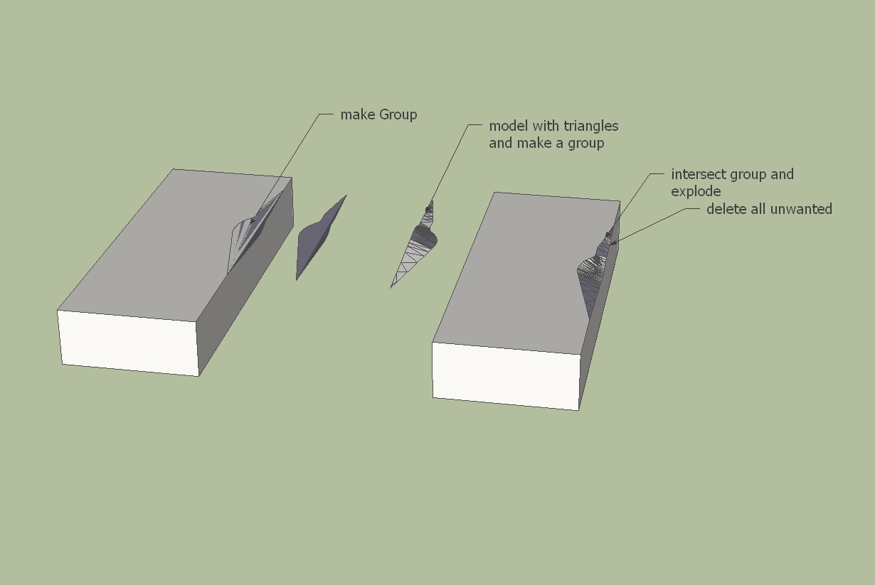

                  • charly2008C
                    charly2008

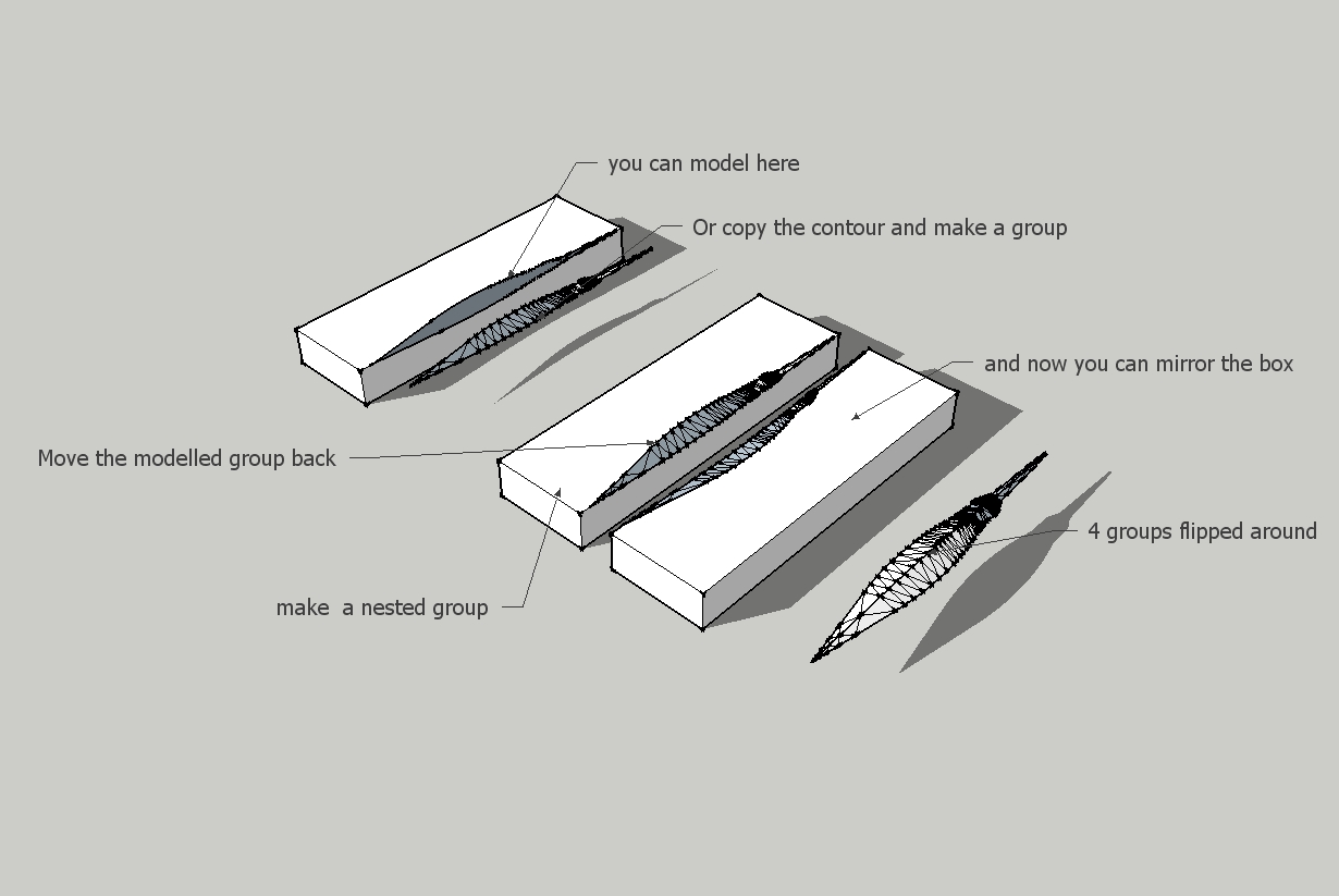

                    Hi ushumgal,
                    i copied the the Contour and made it a group. Then i modelled as i explained the triangles at each endpoint of the curves. Below is a better example.
                    Karlheinz
                    Speer.skp

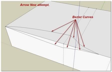

                              @ushumgal said:
                              What I would like to do now is to remove the center line and have a cavity that curves from one line to the other so that when I mirror the block, there will be a clear arrowhead-shaped depression in the middle of it, deep along the center line and tapering to the surface at the edges. Of course, when I simply erase the center line, it just leaves a hole right now. Is this what the skin plugin is for?
                              @gaieus said:
                              No, TIG, arrow heads are not circular like that. 😉
                              You can start however with a lathed shape like in TIG's example model the "positive" (the arrow head) however - then remove half of it and use the scale tool to "flatten" the piece a bit.

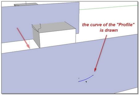

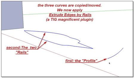

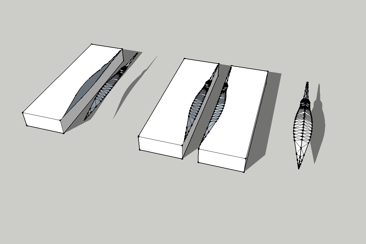

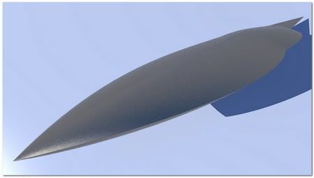

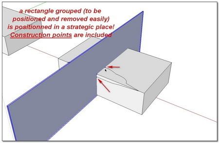

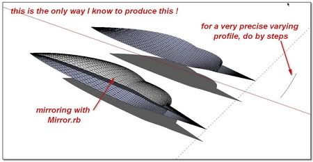

                              Hi ushumgal
                              As I can understand, you need round spoon shapes (I don't know better how to express 😆 )
                              Here is a way with
                              TIG_Extrude Edges by Rails
                              I Have also used:
                              RickWilson_Weld.rb
                              Fredo_BezierSpline
                              TIG _ Mirror.rb
                              In your mould work, a boolean tool seems very useful
                              Whaat_BoolTools (commercial)
                              http://i274.photobucket.com/albums/jj245/Spendauballet/SketchUp/Arrow001_th.jpg
                              http://i274.photobucket.com/albums/jj245/Spendauballet/SketchUp/Arrow002_th.jpg
                              http://i274.photobucket.com/albums/jj245/Spendauballet/SketchUp/Arrow003_th.jpg
                              http://i274.photobucket.com/albums/jj245/Spendauballet/SketchUp/Arrow004_th.jpg
                              http://i274.photobucket.com/albums/jj245/Spendauballet/SketchUp/Arrow005_th.jpg
                              http://i274.photobucket.com/albums/jj245/Spendauballet/KerkyThea/arrowKT001_th.jpg
                              http://i274.photobucket.com/albums/jj245/Spendauballet/KerkyThea/arrowKT002_th.jpg
                              😉 simon

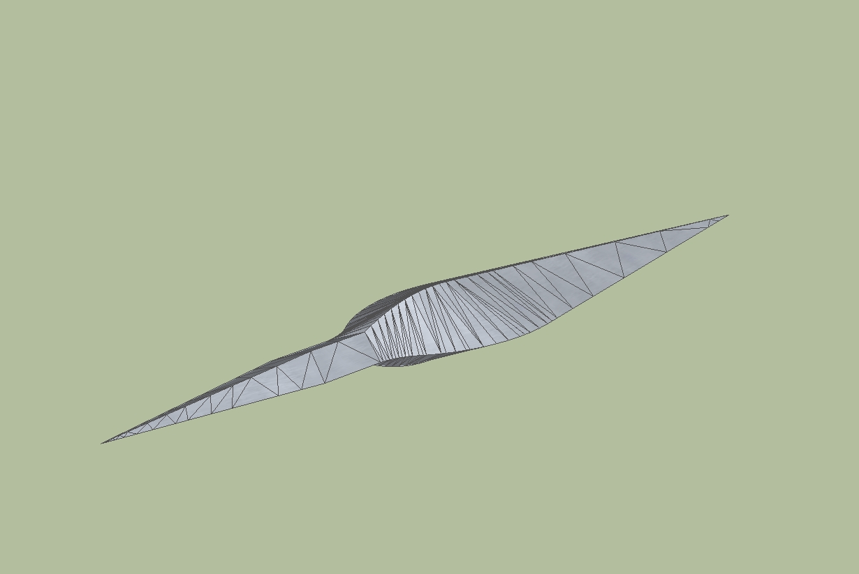

                                    @ushumgal said:
                                    Thanks for the links to the plugins, Simon...TIG's extrude edges by rails is amazing!! I'm having some success with it, but I do have a question. I divided the arrowhead into 3 segments (which all have somewhat different sections). When using this tool, how do you merge one segment into the next?

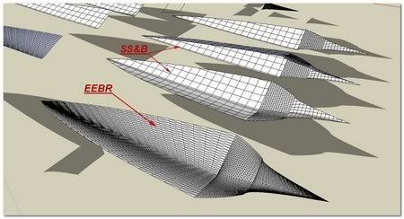

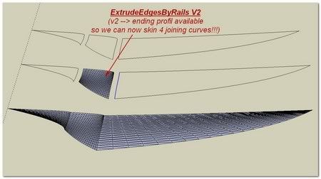

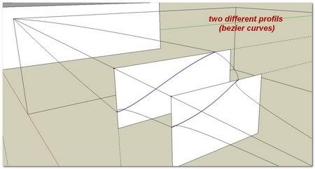

                                    Tig has is own explanation about that: Here
                                    But In fact it was very uneasy to skin the middle segment with EEBR for it was not possible to skin directly 4 joining curves.
                                    I said "IT WAS" because ExtrudeEdgesByRail V2 is out and this limitation has now expired 🎉
                                    Segmented arrow:
                                    http://i274.photobucket.com/albums/jj245/Spendauballet/SketchUp/Arrow2nd_001_th.jpg
                                    http://i274.photobucket.com/albums/jj245/Spendauballet/SketchUp/Arrow2nd_002_th.jpg
                                    http://i274.photobucket.com/albums/jj245/Spendauballet/SketchUp/Arrow2nd_003_th.jpg

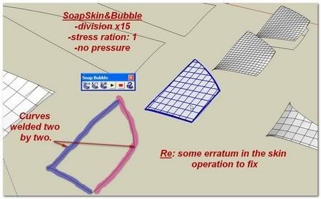

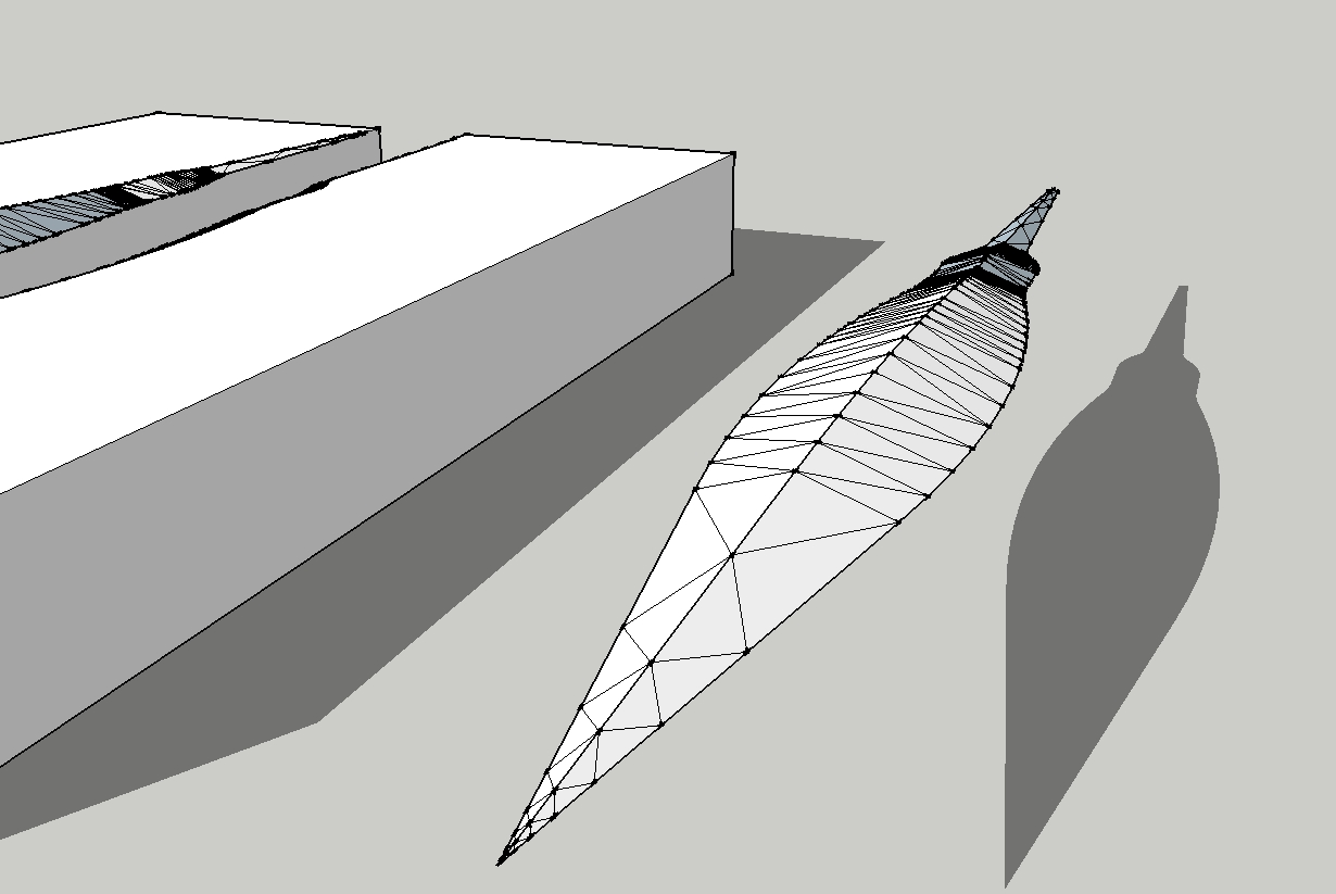

                                    You can also use Soap Skin & Bubble
                                    Which add the possibility to inflate or depress the skined faces.
                                    The process need to be initiate with Weld operation for SS&B works with two joining curves. Some small fails may happen and need to be repaired. Something a bit difficult for newbies.
                                    http://i274.photobucket.com/albums/jj245/Spendauballet/SketchUp/Arrow2nd_004_th.jpg
                                    The two different skins:
                                    http://i274.photobucket.com/albums/jj245/Spendauballet/SketchUp/Arrow2nd_005_th.jpg
                                    I see you are doing skins manually to join your curves (good thing). This can be made with plugins. Unfortunately, powerful ArchitectBoy's Skin.rb (& see also& skin thread) only skin separate curves, but Rick Wilson Curve Stitcher does it very simply
                                    (you can throw a glance on my little skin reminder here even if it must be updated)
                                    ++simon
