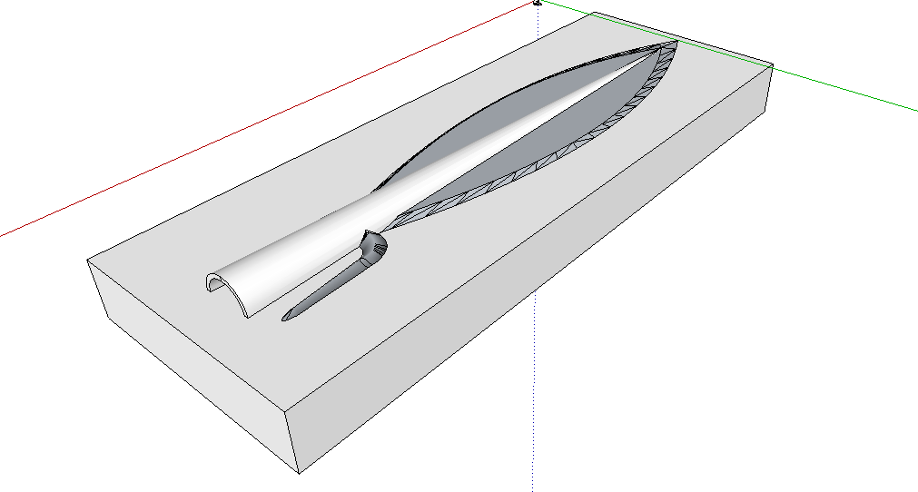

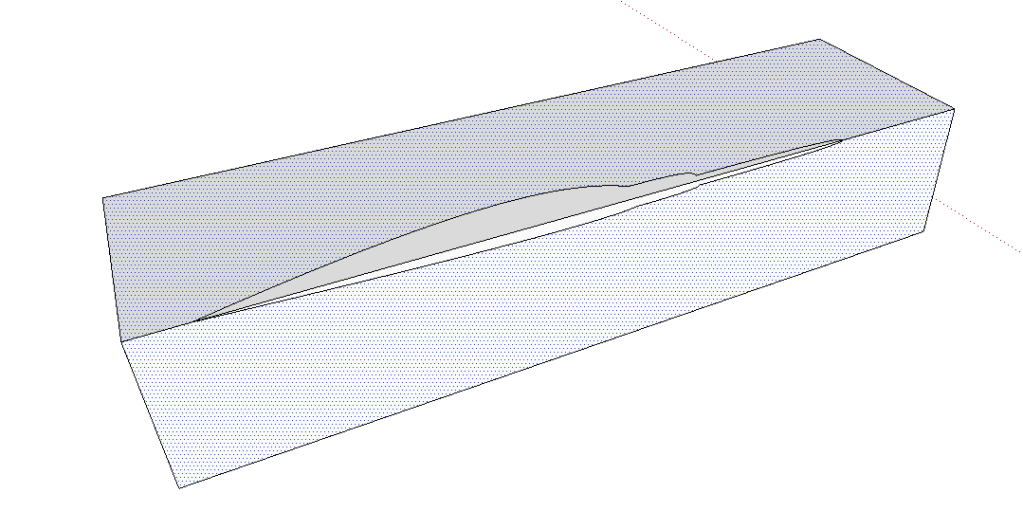

      The holidays slowed me down, but now I'm back at it and I have made a number of very sexy arrowhead models (in the process of which I learned a LOT about SketchUp!). Now I have one remaining problem...I'm following the instructions that Jean provided. Using a complete model of an arrowhead, I draw a rectangle around it and drag it down to become the block forming half of the mould. Now I should intersect and then delete the arrowhead itself, leaving a cavity in its shape. But whenever I try this, it never seems to work. Should the arrowhead be a group? And I try intersecting both the arrowhead and the block with the model, but I still end up with a mess when I try to delete.
      Anyone have any ideas what I am doing wrong?
      [See images of before and after I delete the arrowhead below.]
      http://i1015.photobucket.com/albums/af276/tupsharru/bilobateinblock.png
      http://i1015.photobucket.com/albums/af276/tupsharru/bilobateinblock_deleted.png

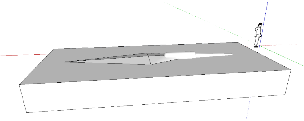

      One more question: I've made a sexy arrowhead, but now I need to embed it in a box and then delete it to leave the cavity. Does that involve making a group, like in Karlheinz' example? If someone could point me to a tutorial for this bit or give me a quick walkthrough, I'd be much obliged!
      http://i1015.photobucket.com/albums/af276/tupsharru/arrowhead_in_block_c.png

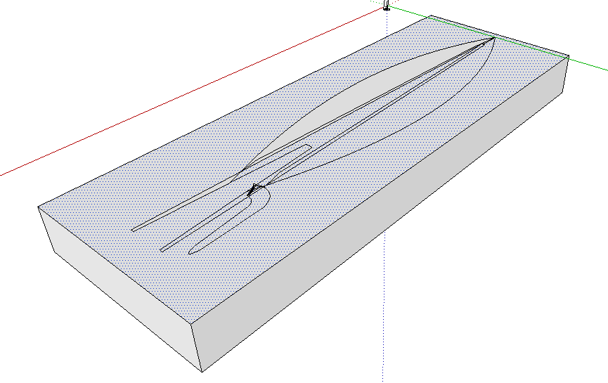

      Hi, I realize this is probably a veeery basic issue, but I nevertheless can't seem to find a solution. I am trying to make a 3D model of a mould used to cast arrowheads (exciting stuff form my dissertation... πŸ˜‰ ). From reading I've done about Sketchup, I figured the best way to start was to divide the mould down the middle and model only one half and later mirror it (which I have yet to learn how to do) in order to ensure that it is symmetrical.
      So, I started by creating half of the mould block, and then drawing the outline of half of a typical arrowhead on the top (with one edge as the center line). Then, on the side I did the outline of the profile of the arrowhead.
      What I would like to do now is to remove the center line and have a cavity that curves from one line to the other so that when I mirror the block, there will be a clear arrowhead-shaped depression in the middle of it, deep along the center line and tapering to the surface at the edges. Of course, when I simply erase the center line, it just leaves a hole right now. Is this what the skin plugin is for?
      Please forgive my extreme ignorance; I'd appreciate any suggestions you may have!!
      http://i1015.photobucket.com/albums/af276/tupsharru/mould_c.png
