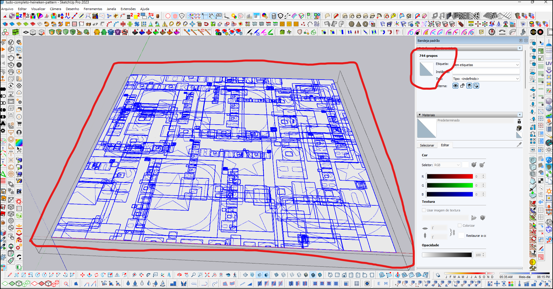

    • How to extrude multiple face groups at once?
      Hi everyone,
      I’ve imported a complex vector pattern into SketchUp (originally from Illustrator), and now I have over 744 groups — each one contains a flat face.
      I’d like to extrude all of them by the same amount, but doing it manually one by one would take too much time.
      I’m currently trying to use Fredo6’s Multiple Push Pull plugin, but I’m running into issues:
      When I select all the groups and run the tool, it starts the process, runs for several hours, and then only extrudes about 7 or 8 shapes. It completes the operation without showing any error message, but leaves most of the geometry untouched.
      Is there a proper way to use this tool with grouped geometry?
      Or is there another plugin or workflow that can batch-extrude face groups more reliably?
      Each group is properly closed and contains a clean, planar face.
      Any help or tips would be greatly appreciated — thanks in advance!
