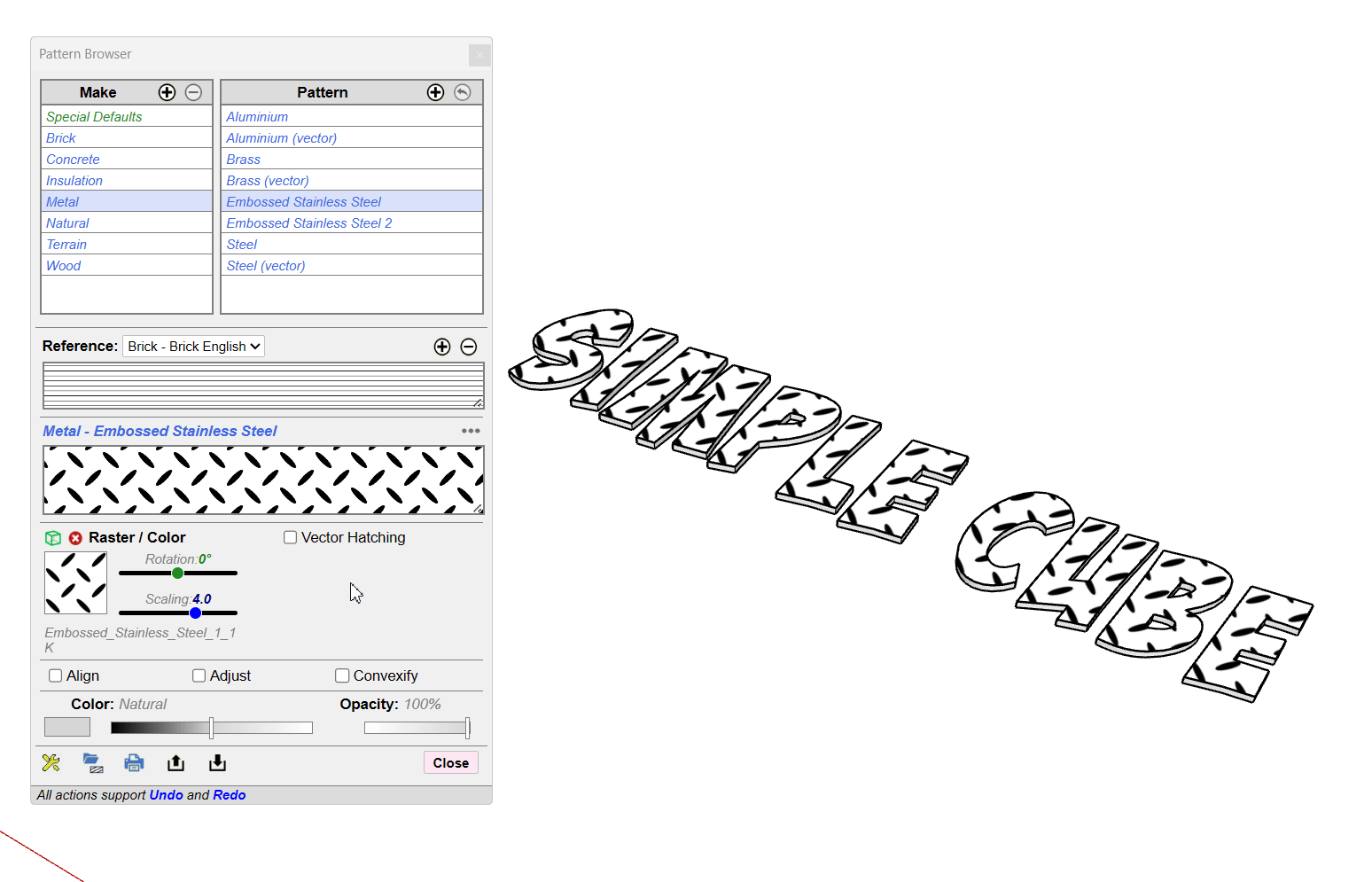

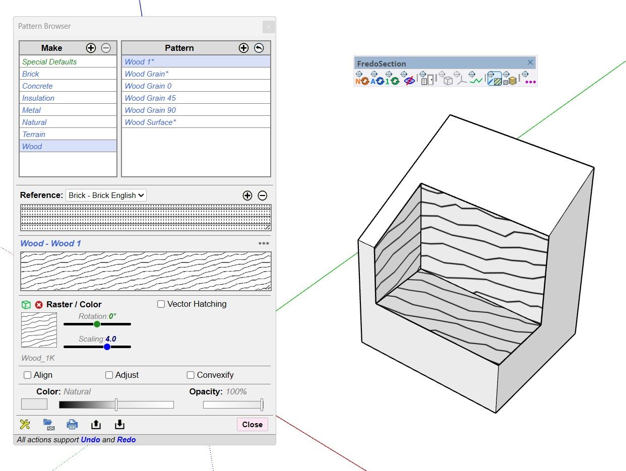

      Hi!
      I'm a long time SKP user, currently on SketchUp 2026. Since they improved the speed both of SKP and LayOut I decided to switch to SKP totally, also with drawings. I found a plugin FredoSection that seems exactly what I need to make my drawings look professional as if from CAD.
      I installed the SketchUcation manager, then installed both the LibFredo and FredoSection. The plugins toolbar shows up, I can create box sections, browse patterns, but the main thing doesn't work. No matter my method and complexity of the model, the plugin does no computing (as decribed in manual) and creates no section faces to add the pattern to. I can toggle section lines of and on, add plugins own box or line sections, but my components are just simply cut and empty.
      I tried what I found on the forum: reinstalling the plugins (both SketchUcation and Fredo), fixing SketchUp in run as administrator, double clicking.
      On FredoSection page there is info that there will be license from April 2026 and if it worked I would gladly pay. I don't know where though, there is no link or anything.
      I'm on the verge of turning to Skalp, but it is pricey and there is no trial period and I worry the problem will be the same.
      Any suggestions?
