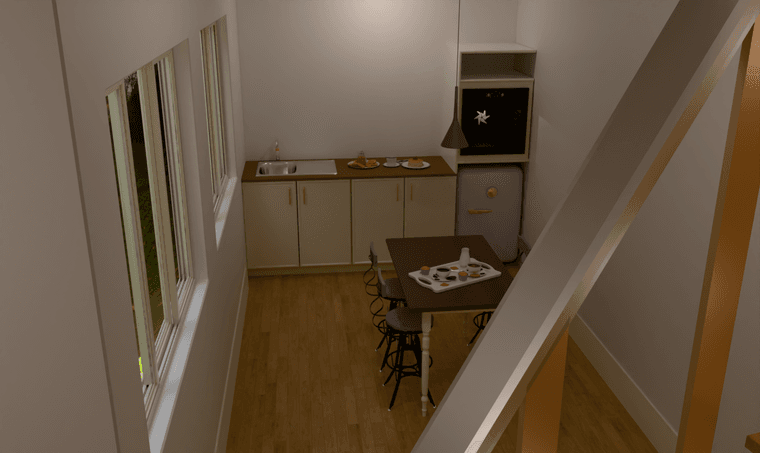

      Mike Amos @Mike Amos
      Mike-Amos View too.
      Kitchen area, note missing colour/items 2d export versus render.
      Mike AmosM Rich O BrienR 2 Replies Last reply Reply Quote 0
        Mike-Amos
        May have needed a restart which cures some content glitches.
          Is the container(group/component) painted or the raw geometry? What does Entity Info say regards the selected container?
              Mike-Amos
              I know, inconsistent.

                      Post artificial light death, I have this.
                        OK, auto exposure OFF (It will get there) and set at 7.5. I also fixed the blind which was rather abused. I have confirmed to my own satisfaction that when items and finishes/colours go missing, a restart of Rayscaper will fix the problem. Also, do not use cleanup for the whole model, elements in turn. Otherwise you will have your Rayscaper lights deleted.
                        10 2500s 2015 x 1202 1412211 tri 8m 13s GPU  env 0.80 Backplate Auto Exposure off Exposure 7.5.png
