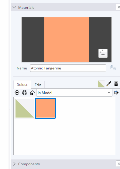

        • ntxdaveN Offline
          ntxdave @Rich O Brien
          @Rich-O-B Thanks @Rich-O-Brien , I have been doing some more exploring and have finally made some real progress in what I have been trying to do. I have been able to create some new materials to use and have them store when I can now use them in new models.
          You suggestion has given me even more things to think about. Now what I need to figure out is that if I duplicate a material but want to change the orientation (horizontal vs. vertical), how do I do that in SketchUp. My current process has been to rotate the image used for the texture and then use it to create a new material.
          During this process, I have learned that I can use the color wheel to modify a material and then save the modified version. Wish there was a way other than using the color wheel. Would like to be able to set the RGB colors.

            Dave R @ntxdave
            @ntxdave said in Create new or adjust materials:
            You can set the RGB color values if you just change the color picker.

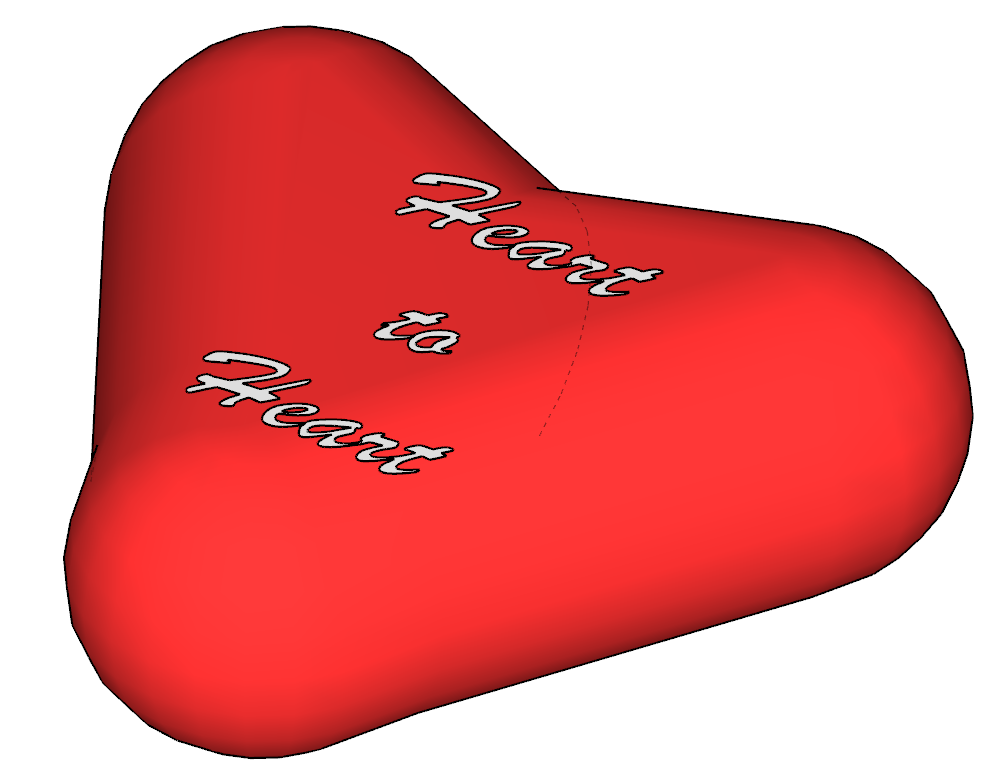

                    Another issue: although I have learned about creating textures, I need some more help with a couple of different issues:
                    • I need to "smooth" or erase some lines on the heart.
                    • I am want/going to enter some text and maybe an image to one of the faces of the heart. In the example below, I use the 3D Text editor to create the text. Is this the best way or is there another/better way to place text and an image to the face of the heart?

                      Dave R @ntxdave
                      Remove the internal faces between the two flat surfaces. Then you should be able to soften the edges on the surface. Those internal faces will have to go if this is a thing you plan to 3D print, anyway.
                      There's nothing wrong with using the Editable 3D Text extension to create the 3D text although you could also use the native 3D Text tool here, too.. The only benefit to using the extension would be if you want to edit the text after creating it.

                      • ntxdaveN Offline
                        ntxdave
                        @Dave-R Thanks once again Dave, as you will see int the image below, I got the issues addressed. πŸ‘ πŸ‘ πŸ‘
                        Now I need to work on the shape of the heart.

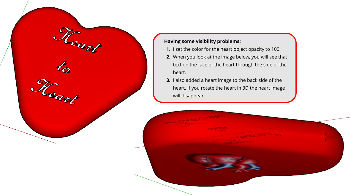

                              • ntxdaveN Offline
                                ntxdave
                                OK guys, I am having some more problems. If you look at the image below, I think I have outlined my problems.
                                Yes @rich-o-brien I do have an F1 key but I am having some new problems. I hope someone can give me some pointers.

                                • S Offline
                                  sashapepperspray
                                  did you by any chance press k on the keyboard, it looks like back edges are showing
                                    You appear to have Back Edges turned on. K is the default keyboard short. Tap it and the Back Edges should turn off.
                                    Are you rotating the object or orbiting the camera?
                                    What problems? F1 is a hard coded shortcut so you can change that one.

                                      • ntxdaveN Offline
                                        ntxdave @Dave R
                                        @Dave-R said in Create new or adjust materials:
                                        I will give that a try the next time I start up my laptop. Is that for the heart or the other objects? I have been having a little problem trying to place the 3D text at the right Z level.
                                        I was rotating the and I also orbited the camera,

                                        • ntxdaveN Offline
                                          ntxdave @ntxdave
                                          OK guys (@dave-r and @sashapepperspray), I went and got my laptop and fired up the model. I clicked on the heart object and then clicked on the K key. Guess you guys were right. I can no longer see the text through the model.
                                          The only problem I am having now is that when I rotate the object (actually the camera), the image on the back side of the heart comes and goes. I guess I need to make that a separate object instead of pasting the image to the back surface of the heart.
                                          Gave it a go and all seems to be OK now.

                                            Dave R @ntxdave
                                            So you mean orbit the camera?
                                            Sounds like Z-fighing. Make the image of the heart a texture and apply it to just the back face of the heart. Turn on Hidden Geometry so you can paint the back separately from the rest.
