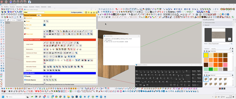

          • alexpacio2013A Offline
            alexpacio2013 @fredo6
            @fredo6 said in Why is the green section under my custom toolbars no longer visible in the Lord of the Toolbar menu?:
            Traductor::ChromiumWdlg.dialog_info_reset 'LOTT_master'
            Yes, with your script it works but if I close SketchUp I have to launch your ruby script from the console.
            I don't have two monitors but I have one that is 3440x1440 wide.YawJC6h2uy.png

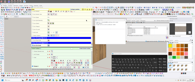

              @fredo6
              And anyway, even with your script it works on the second opening of the Master toolbar manager panel. At the first opening, the Custom toolbar panel is not present.

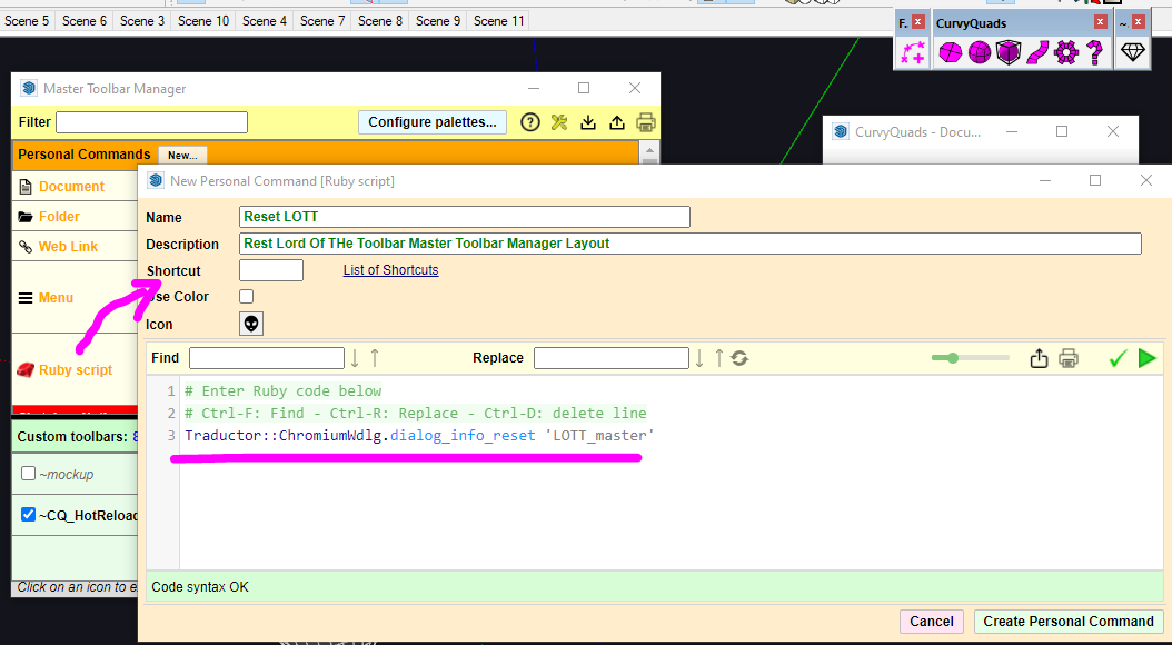

                      panixia @alexpacio2013
                      @alexpacio2013 you could try to create a ruby custom toolbar button with that command, usually that's the equivalent of launching a command from the console itself.
