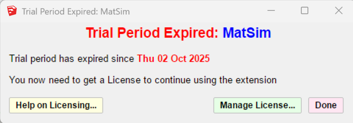

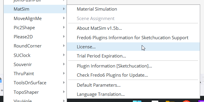

      As of October, the Fredo 6 Matsim extension became payable. I acquired a license, but I can't activate it. I installed the license file in the directory where all my SFC licenses are. However, the menu of the extension has no option 'License...', like the other Fredo extensions have.

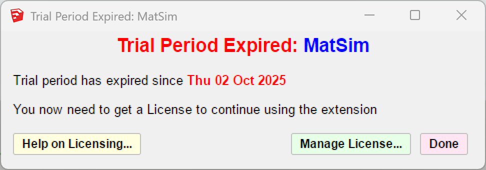

      If I select the application icon in the toolbar or the menu option, I get the following window:
      Screenshot 2025-10-03 022955.png. Clicking on the 'Manage License' button, doesn't do anything.... The window just closes....

          As indicated before: the Mat Sim license file that I received via mail is installed in the same directory where the equivalent license files for the other Sketchucation extensions are stored. When launching the MatSim extension, the popup dialog as shown in my earlier message pops up. Clicking on the 'Manage License...' button just closes the dialog box, and nothing else happens...
            Have you tried removing MatSim .rb and it's folder from your Plugins directory and installing a fresh version?
            I'm not seeing a missing License... entry on my device

              WHat does happen if you click on the Manage License button on the Expired notification?
              • I Offline
                i5963c Extension Creator
                As said in my previous posts, clicking this 'Manage License...' button does nothing, it just closes the dialog and nothing happens. But, I'm currently trying the suggestion to uninstall/re-install. Not yet there. I describe what's happening via another post.

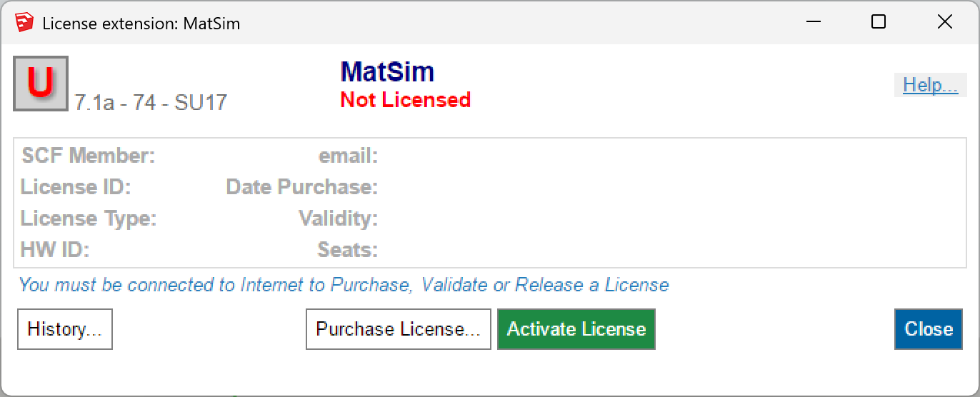

                  Yes, I just did that. Now, I indeed see the License option. But, if I click it, I get the following screenshot:
                  Clicking the 'Activate License' button in this dialog allowed me to select the license file that I received via mail after acquiring the license, and everything works again now. So, the issue can be closed nowπŸ‘ .

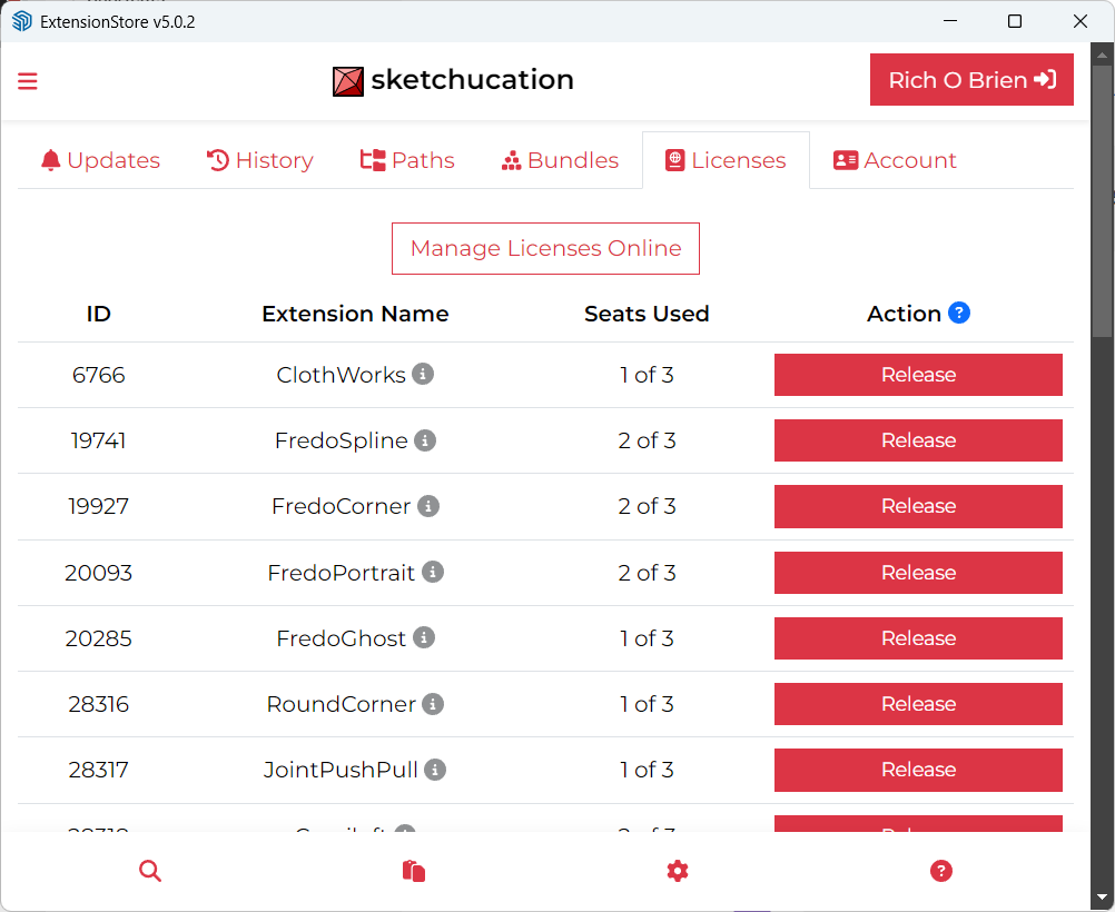

                    You can also now license from directly within Sketchucation Tools using the Licensing Tab
                    Sketchucation Tools Licensing Tab
