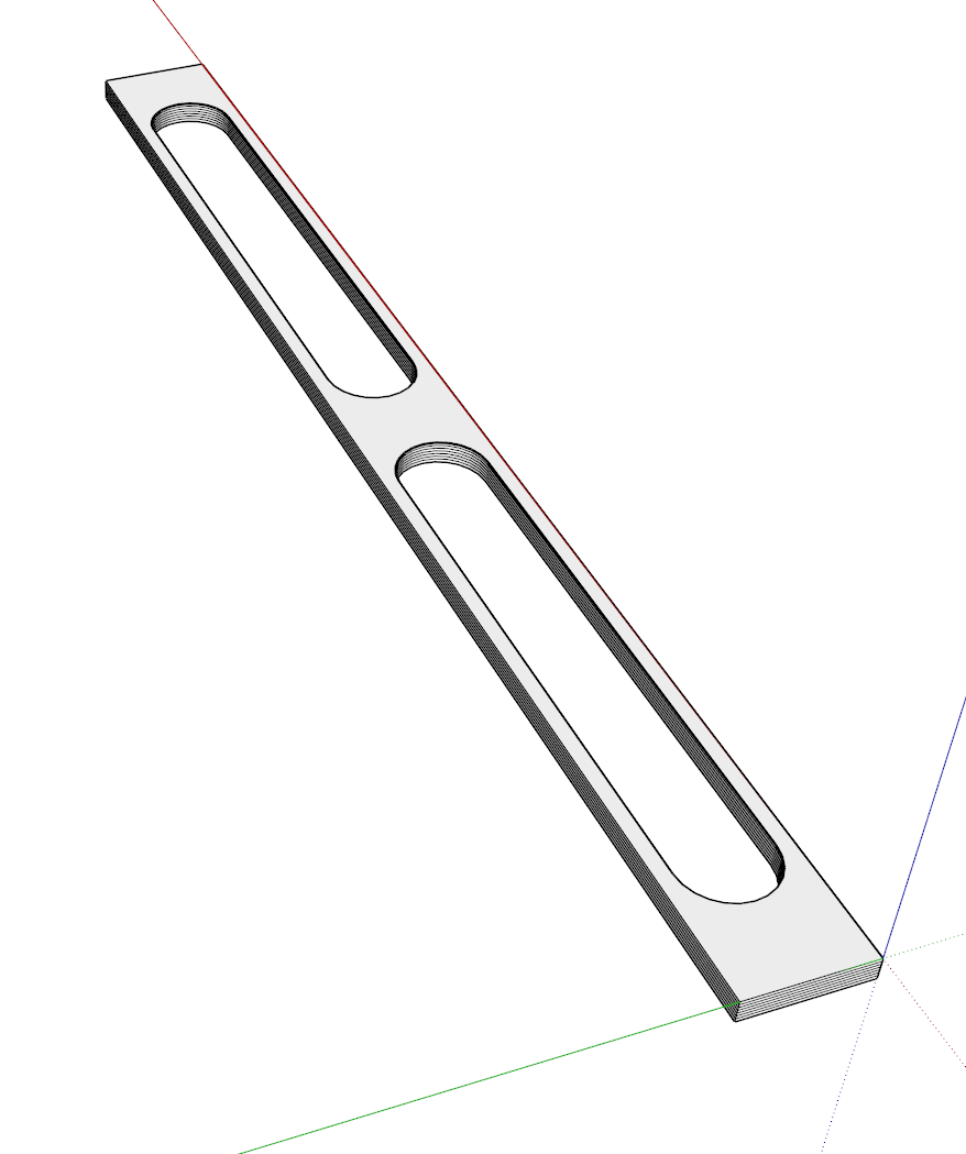

      so, after how many years of this functionality seeming to not be working, it seems like it's still not working.

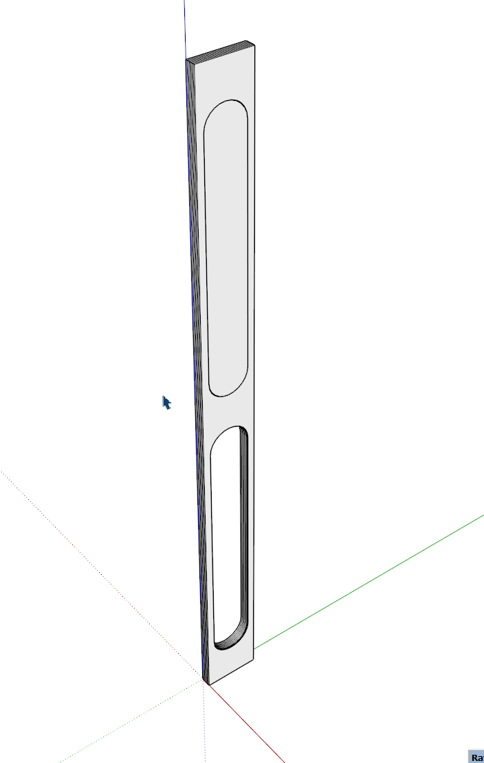

      a simple component with a pair of cut opening components (back to back). the first set of the copies - works as expected. second (and other copies) nada, zip. the components are there but the cutting is missing...
      so, are cut opening components not support in dynamic components?
      i've seen people recommend a paid-for tool (VisuHole) but that doesn't seem to be workable in a dynamic component.
      attached is the component. routed absorber frame.skp

        as an fyi - i make make a component, then my cutting component, manual add it to the face on the primary component, it cuts. then a copy (m + ctrl to copy) that one also cuts. so something is wrong with the dynamic component use because the same copied set of attributes (whichever one says this one cuts) should be carried to the next copy(s) as well..
        acomponent.skp
        something to do with depth... with the flat version - cuts on a flat component - ok. one depth versions, first one cuts, second does not.
        non-dynamic - copies cut as expected...
        acomponent-nodyn.skp

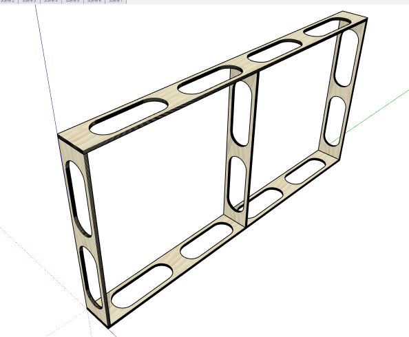

                turns out cutting things which subsequently need to be rotated is not reliable... 😞 so back to using individual components to create it...
                i was hoping the cutting components in an array would do it, but then it's getting confused on rotations and trying (or seeming to) glue itself. changing to "any" didn't do it either, and left weird disconnected geometry on angles vs the 90Β° i was trying to set. anyways, this is what it looks like after i created with with sub-components to build the board...

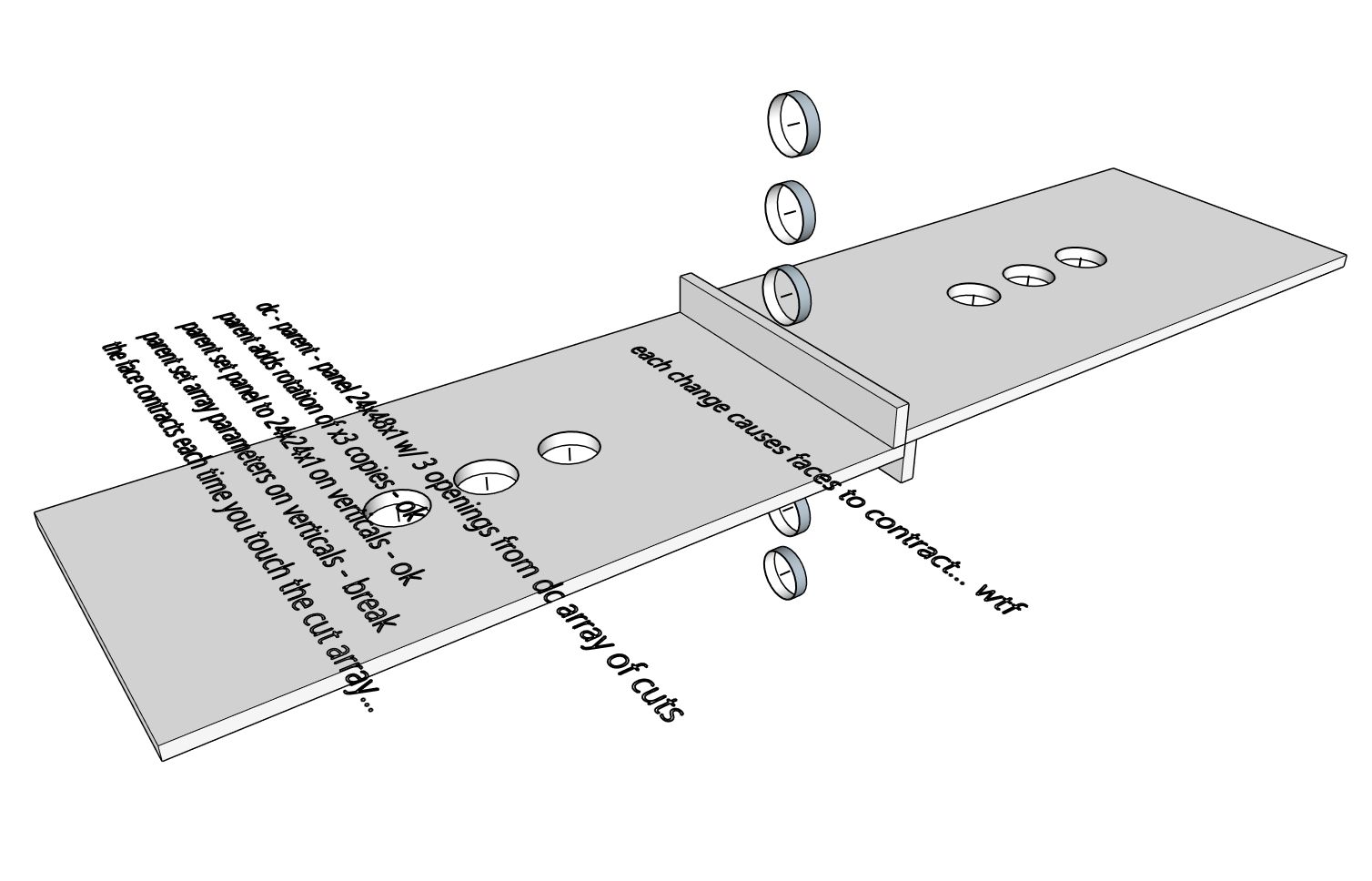

                      so, with the array approach, it's holding steady on simple (no edge) geometry rotated, but the face shrinkage continues to exist. anyways in case anyone is interested in the DC - cut openings phenomena...
                      example of why we cant have nice things.skp

                        as said before, rotations should be isolated with an extra level
                        this has always been the issue with DCs
                        example-of-why-we-cant-have-nice-things.skp
