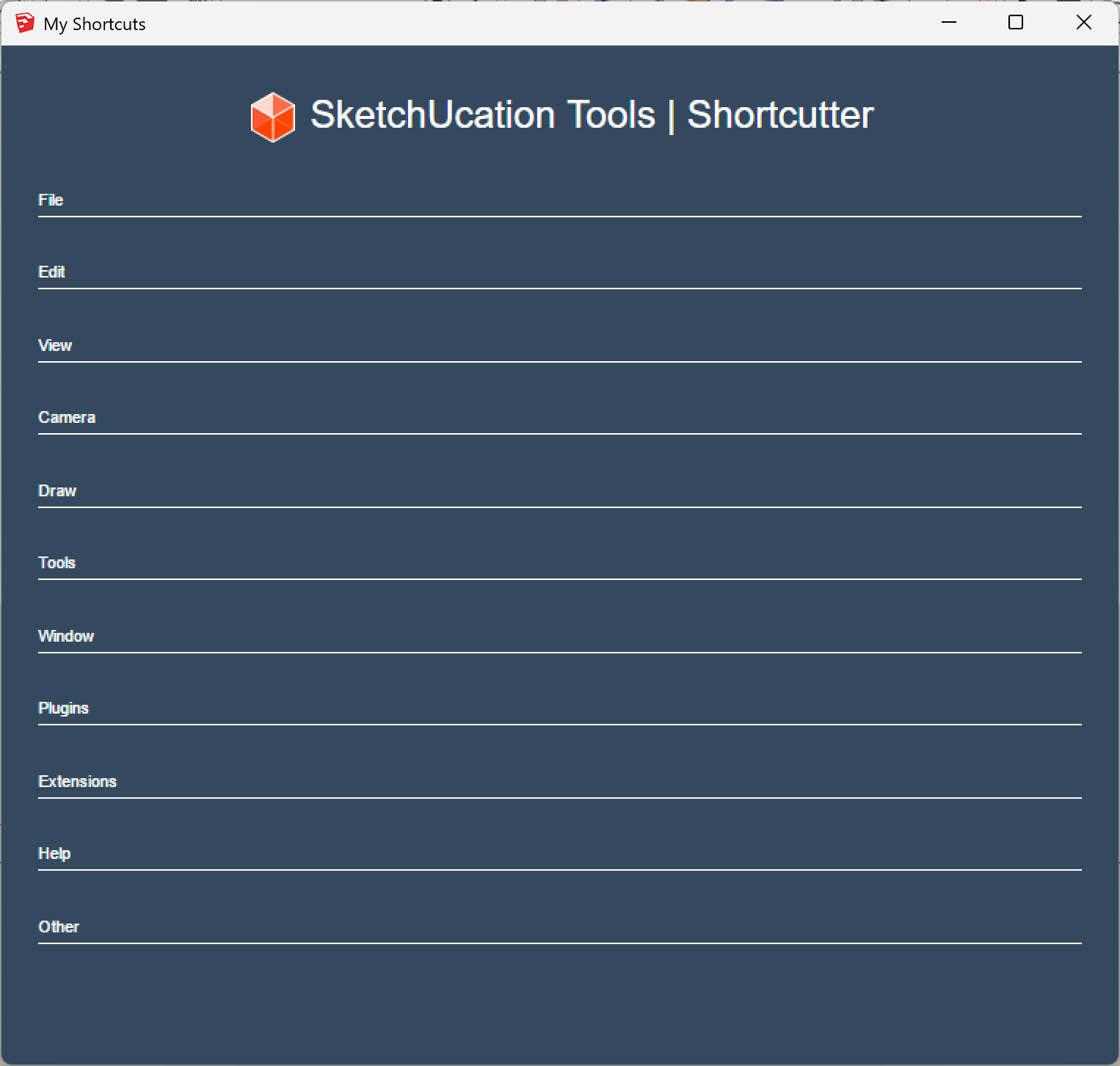

                              One more finding: The 'Shortcutter' is also empty (see screenshot of the dialog). Wasn't the case in earlier versions.

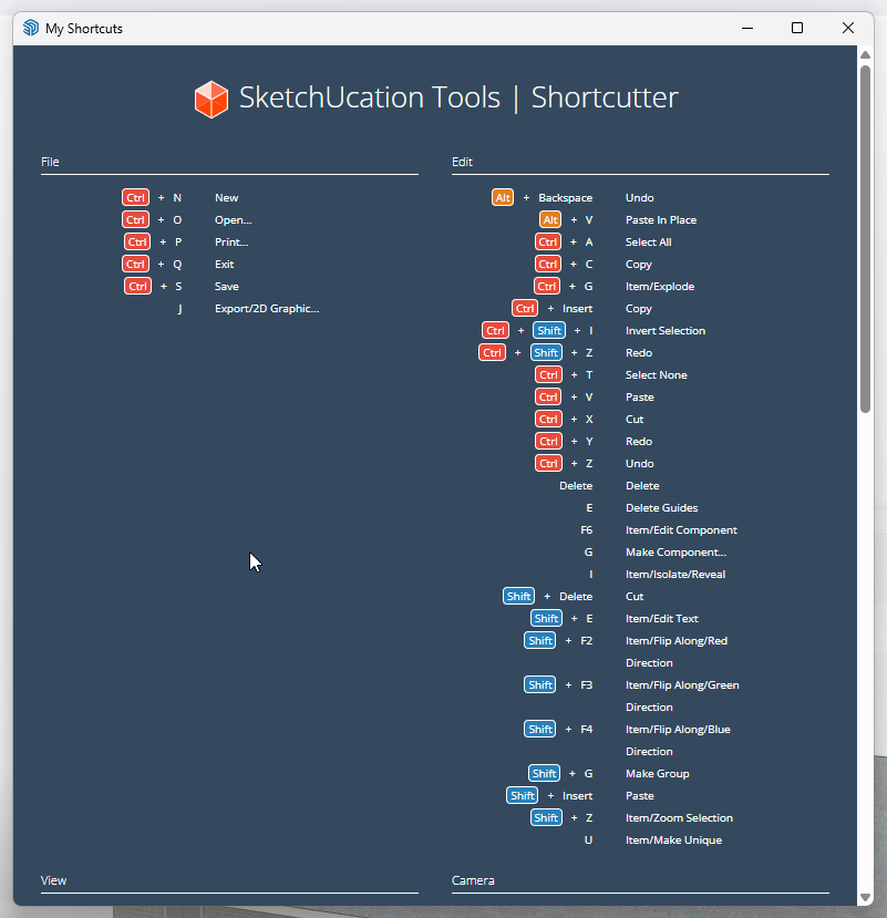

                                Dave R @i5963c
                                @i5963c what operating system? What version of SketchUp?
                                This is what I see in the Shortcutter with the current version of Sketchucation Tools.
