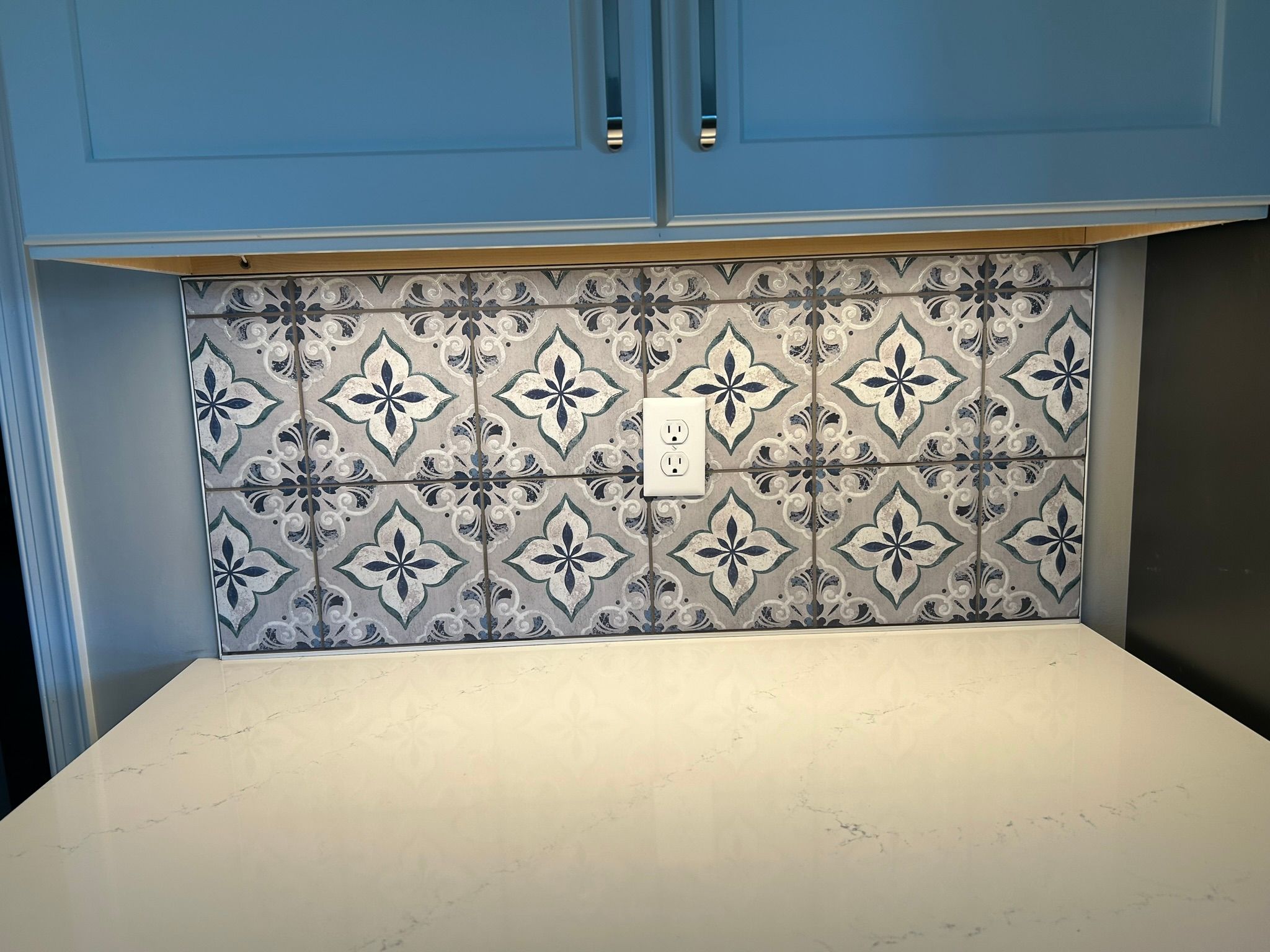

                            Finished product. The real one, not the computer graphics one. Tips too! Cabinets and walls are white.....not sure why they appear blue.TIPS FOR TILES ON A BACKSPLASH......txt
