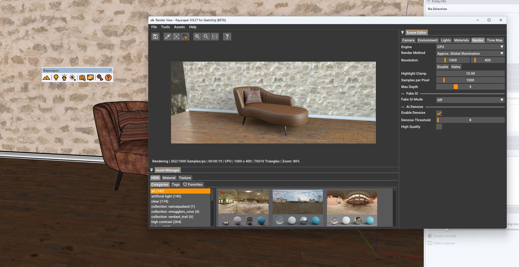

      I started with a small, simple scene, floor, wall, and comfy chair.
      Used HDRI and three directional lights.
      Picture is 1000x1000 px, GPU (GI), 1000 s/px, 1:10 min. RTX 4080 Super.
      I do tend to continue my tryout with more complex scenes when I have more time on my hands.

                  nlipovac @pixelcruncher
                  @pixelcruncher
                  When I used VRay when opening Vray Asset Editor tool you have buttons to start/stop rendering with the ability to run real-time or non-real-time rendering (push and wait to see result).
                  And since I have used it for a long time I am accustomed to that UI, your is quite good, and like I said it is just a matter of spending some time with UI to get accustomed to it.
                  For me, it doesn't save scene settings when I am done with the rendering and after reopening skp it goes to CPU rendering and pic size of my Sketchup window.
                  I use Sketchup 2024 on Win 11.
                  Please, use my picture to promote Rayscaper, this, and any I post later.
                  It is made using a model from 3DSky and Quixel textures for wall and floor.
