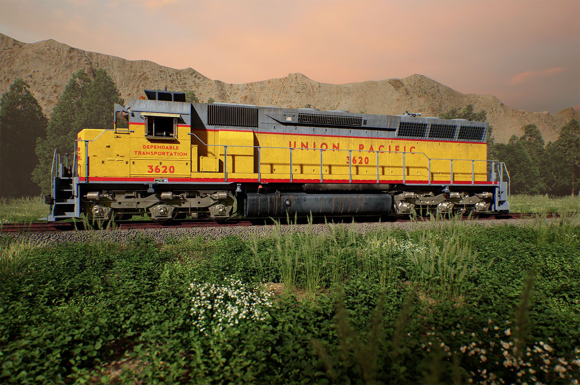

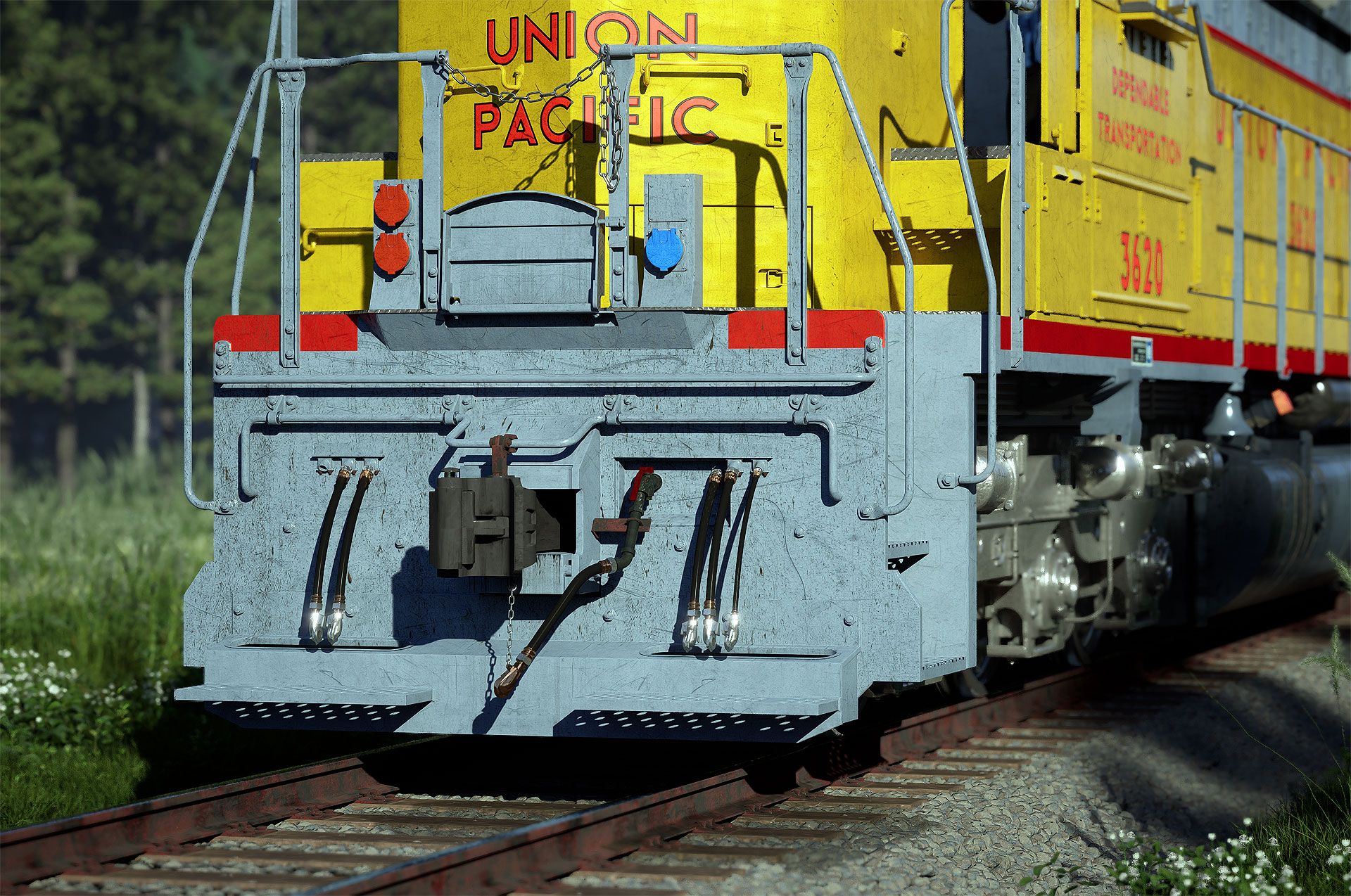

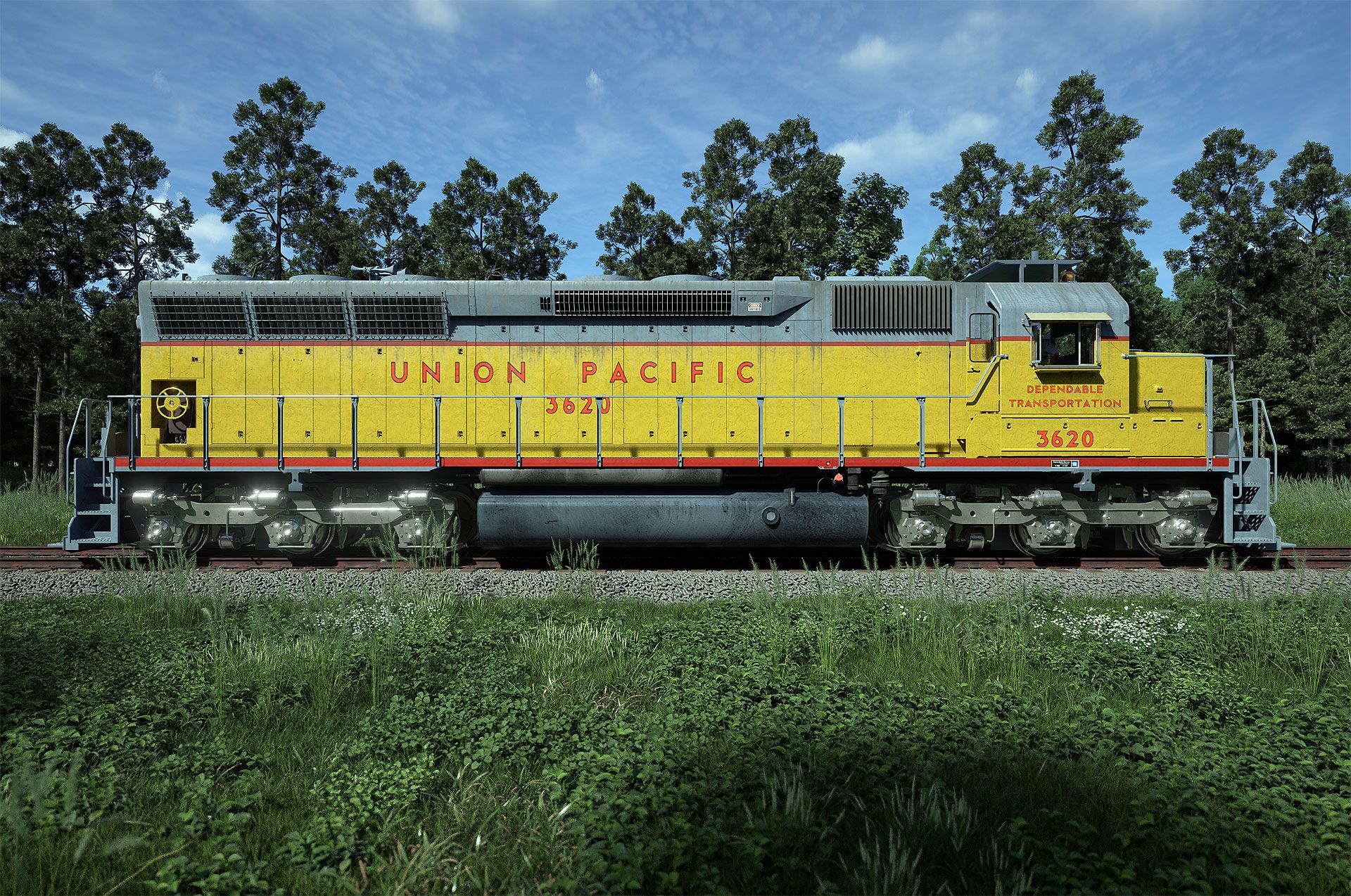

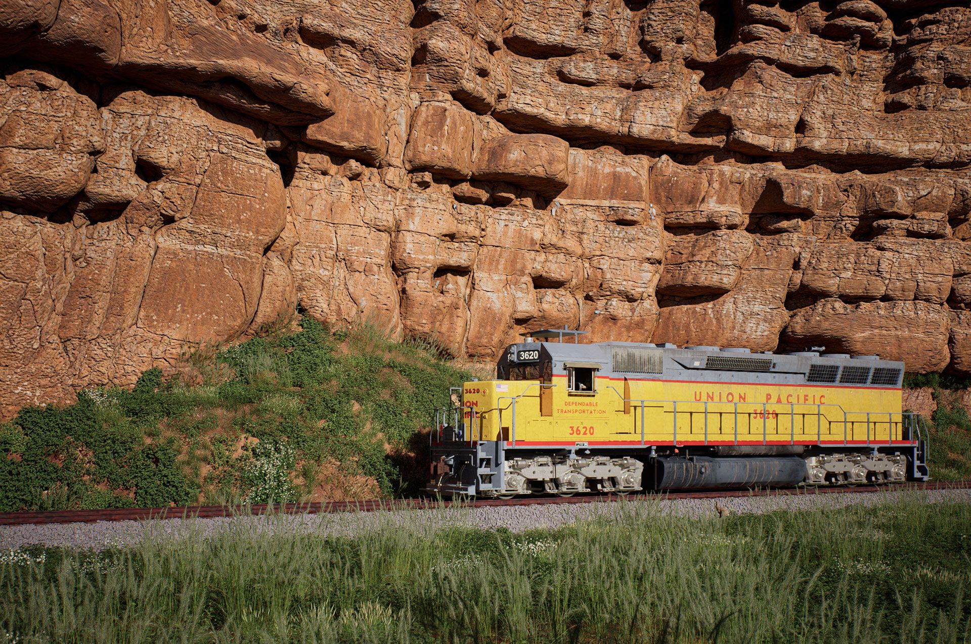

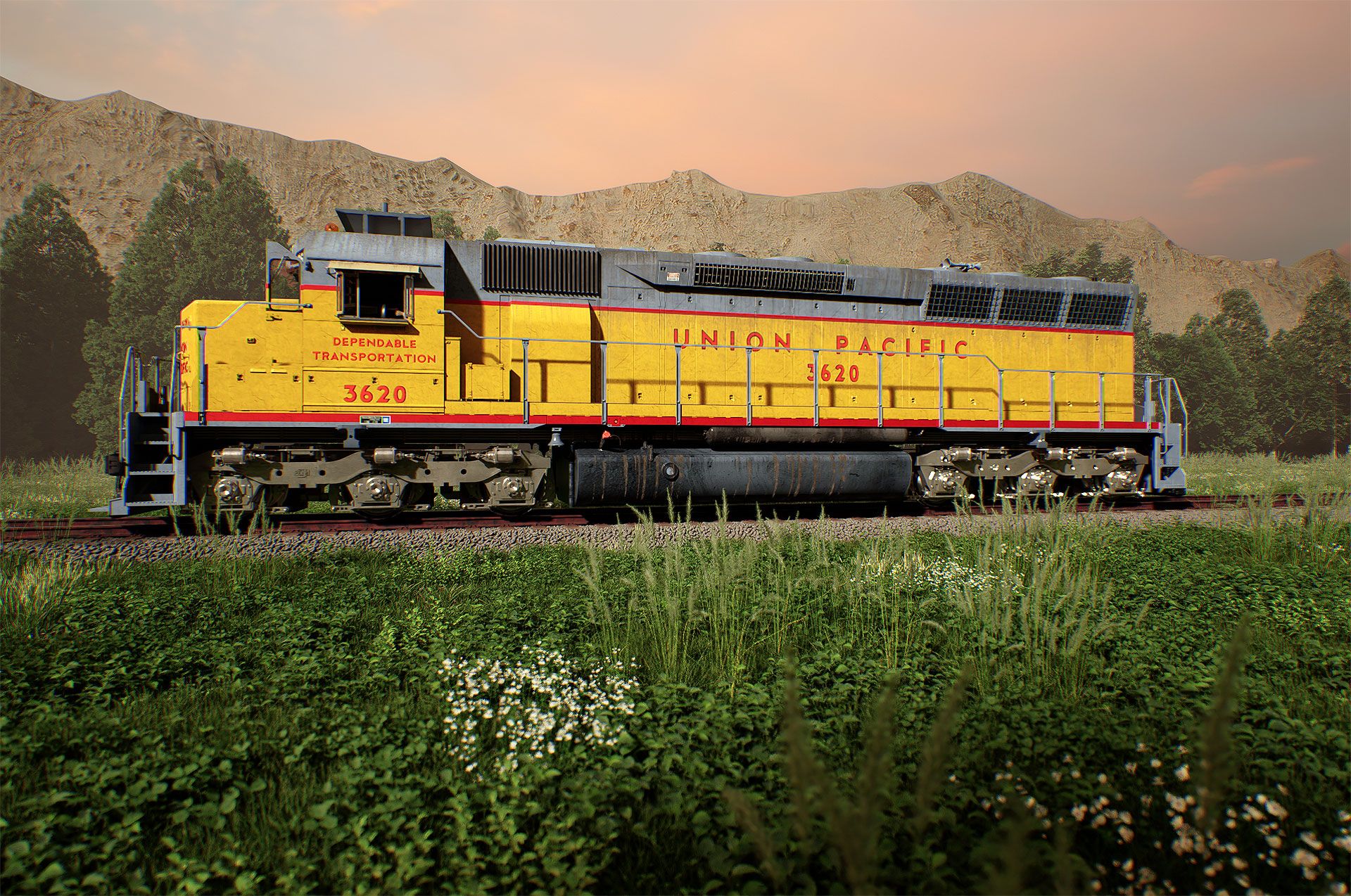

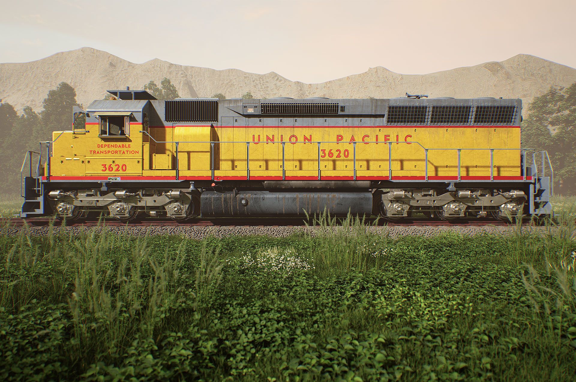

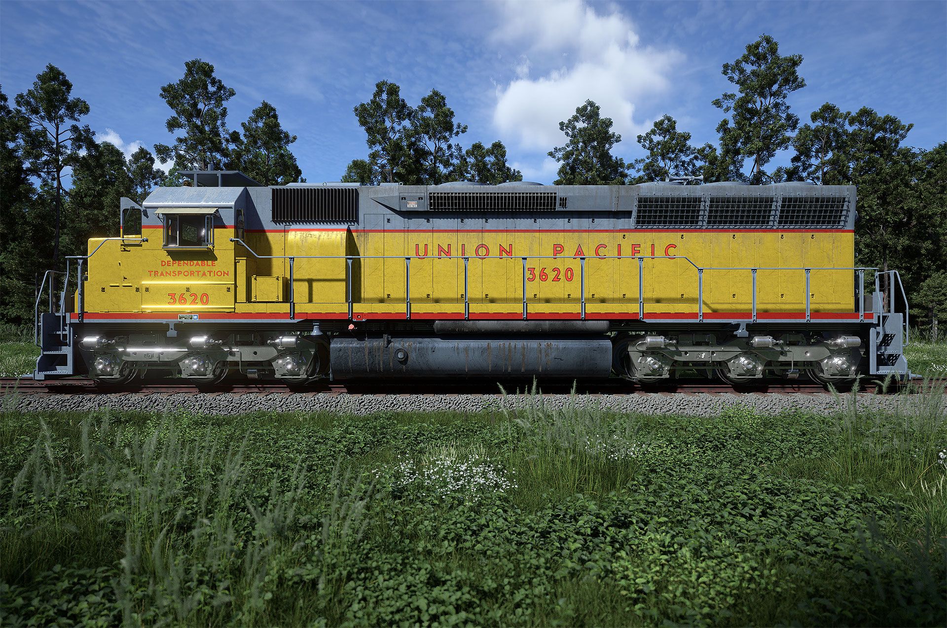

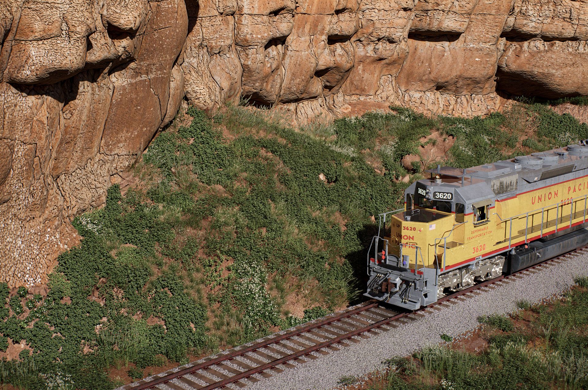

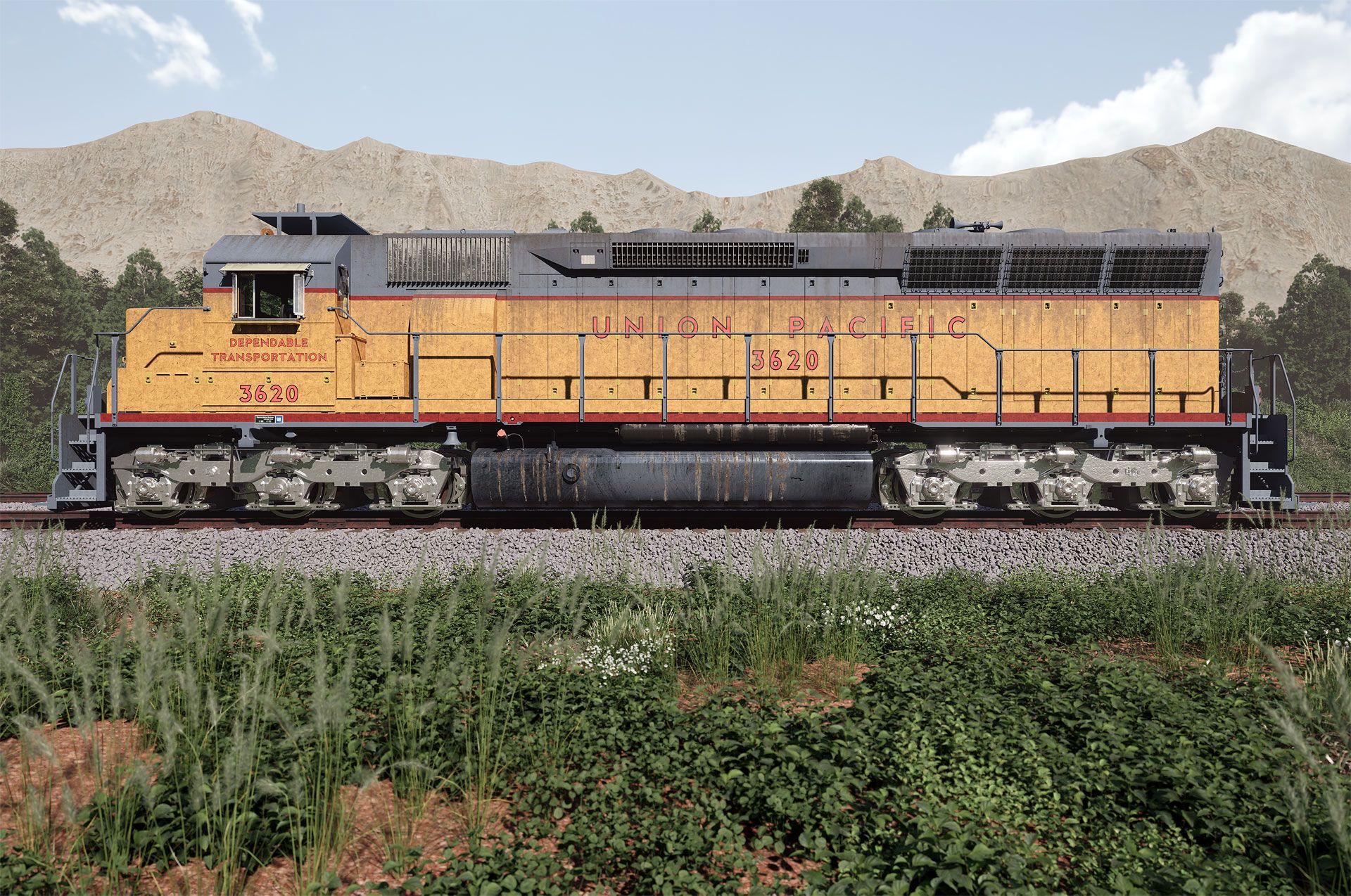

      @Bryan-K Couple more and what I posted at the D5 forum.
      "Experimenting with some new techniques.
      The cliff is from Megascans Moab Collections which I got from Quixel Bridge. Using Transmutr I created a skp file and in Sketchup I split off the portion below the cliff to create a separate area to scatter in D5 with the wildgrass pre-set.
      Rendered in D5 and applied a strong weight AI enhance on the cliff alone. Post-processing is just a resize in Photoshop. The model is the EMD SD45 by me alone with the tracks. I used D5 brush to scatter some ballast rocks outside the ballast bed.
      The cliff from Quixel Bridge is the Desert Western Cliff Layered XL 04. LOD 0. It’s free from Quixel Bridge by signing up with Epic Games.
      The AI enhance really pops out the cliff rock textures."
      www.instagram.com/gusrobatto/

        Gus, they are quality models have you thought of selling them? Bit of trickle money?
        Gus RG 1 Reply Last reply Reply Quote 1
        • Gus RG Offline
          Gus R @L i am

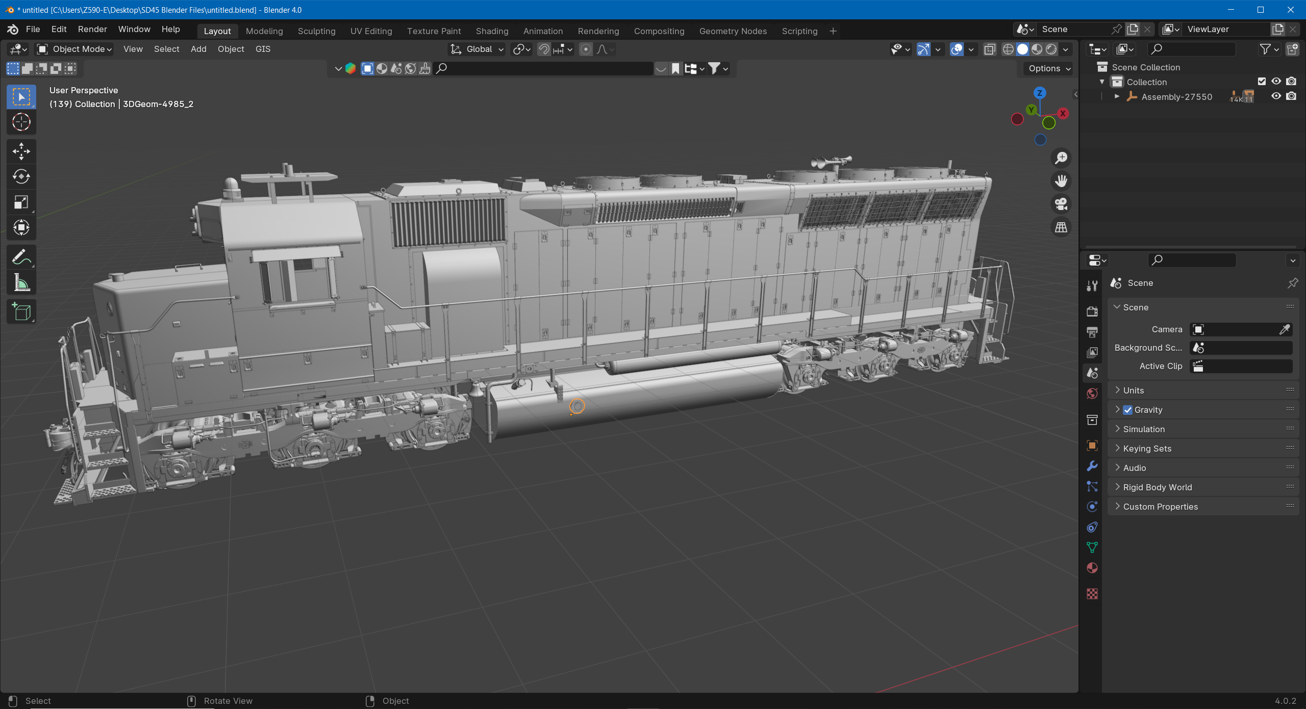

          @L-i-am I thought about that but so far it would have to be a skp file. I've tried exporting obj and dae but it crashes Blender. Same with an fbx export from SU to Blender. The SimLab fbx exporter worked but it imports the model as an object in Blender with no edit options as well as having these random dashed projected lines ending with a target at the end. I suppose that could work but it would require troubleshooting the object and projecting lines issue. I say this because I would assume that selling the model on say CGTrader would require at least having an fbx and blend file available alongside the skp.

              @Gus-R said in EMD SD-45 Union Pacific Update:
              Those are relationship lines that are not an issue. Think of them as helpers in Blender to identify if object have parents or constraints

                @Rich-O-Brien Thanks Mike, Rich. I'll consider this another project. I was able to visually hide those lines. The Sim-Lab FBX exporter works the best. This is what it looks like in Blender for now.
                Many miles to go.

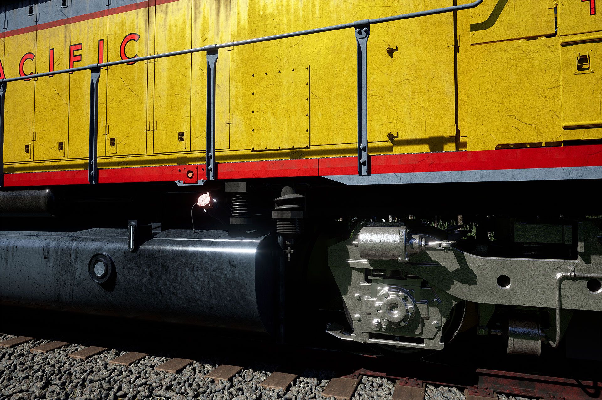

                • Gus RG Offline
                  Gus R @Gus R
                  @Gus-R Created some new body layered materials using Quixel Mixer so now there's some extra weathering. I admit I prefer a clean locomotive in the real world but the weathering here makes the process more interesting. I also started looking into materials in Blender and while it looks complicated looking all those nodes they have PBR and Node Wrangler which simplifies things. I can also sync Blender with Quixel Bridge and export a D5 model which I can import into D5 Render.
                  www.facebook.com/gusrobatto
                    Rich O Brien Moderator @Gus R
                    @Gus-R Killer job, but, like you, I prefer the less grimy version.
                    You should try Cycles and see where you end up. Having a free path tracing engine in your back pocket with procedural material generation is a good skill to add to your portfolio.
                    I know the common opinion out there is its too hard to get to grips with. But Blender probably has the largest online learning resources available. When its clicks you get hooked in.
                    Gus RG 1 Reply Last reply Reply Quote 0

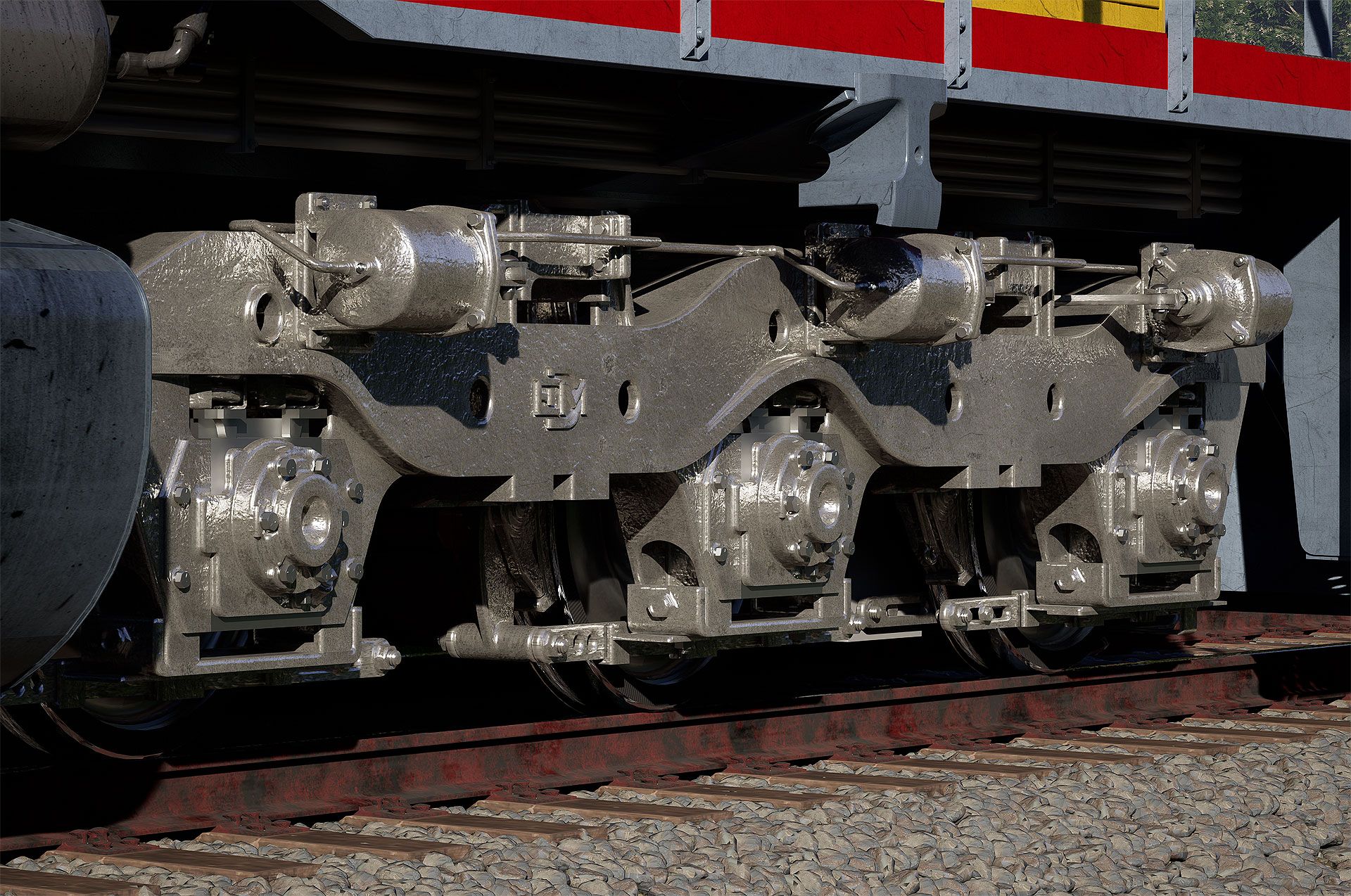

                            i am trying to make a 1:32 Sd18 that uses the Flexicoil three axle bogie as shown in your illustration. Would you be willing to sell me the file for the bogie so i could 3d print a couple for my project?

                                I don't know if I'd want to release the truck model. I may be able to provide a 3D printer service with an stl. I'm still mulling over selling the model to somewhere like CGTrader.
                                What are you looking to do? A static model or an operable model train?
                                Are you able to model one yourself? I can point you to the plans I used to develop this model from the The Norfolk and Western Historical Society.
                                You could try making me an offer I can't refuse. 😊

                                    I requested a quote from a 3D printing firm and he said:
                                    "The model comes with a lot of small thin and fragile parts. It will be risky to print this as one piece."
                                    Might not work for something that you're looking for.
                                    You can look around on CGTrader. There's a very similar model here and here.
                                    Don't forget to not only search for "truck" but also try "bogie."
