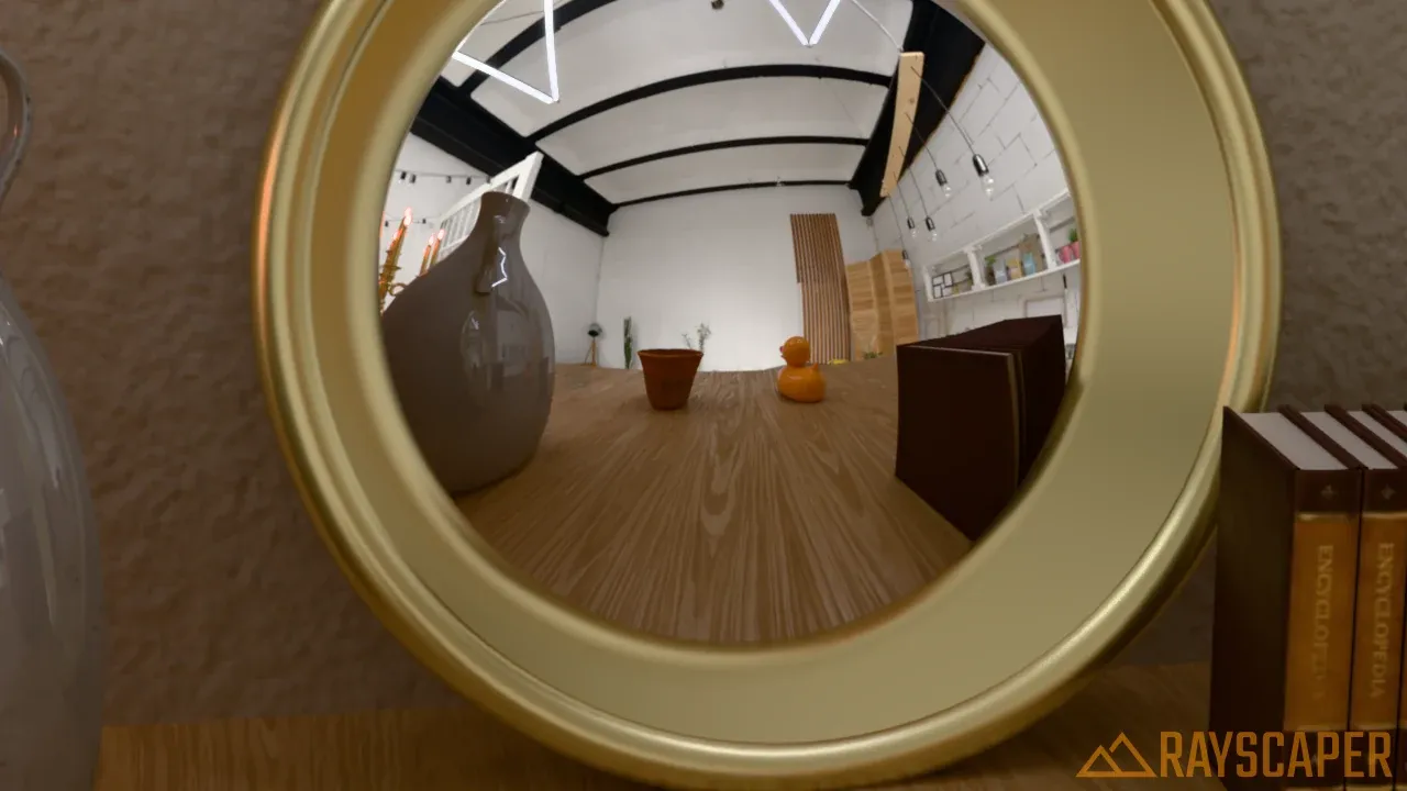

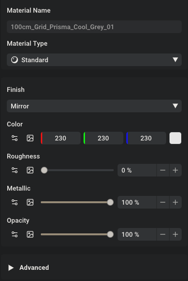

                              @Mike-Amos Mirrors are still there, they just moved! Since 0.9.99 the Mirror is a Finish of the Standard material instead of a material type of its own: select the material, keep Material Type on Standard and pick Mirror under Finish. That gives a perfect reflection, tinted by the material's color.
                              Older Mirror materials open as Standard materials with that finish, so they keep their look. There's also a ready-made Mirror and Bronze mirror in the Rayscaper material library in the Asset Manager.
                              More in the docs: rayscaper.com/manual/material-types
