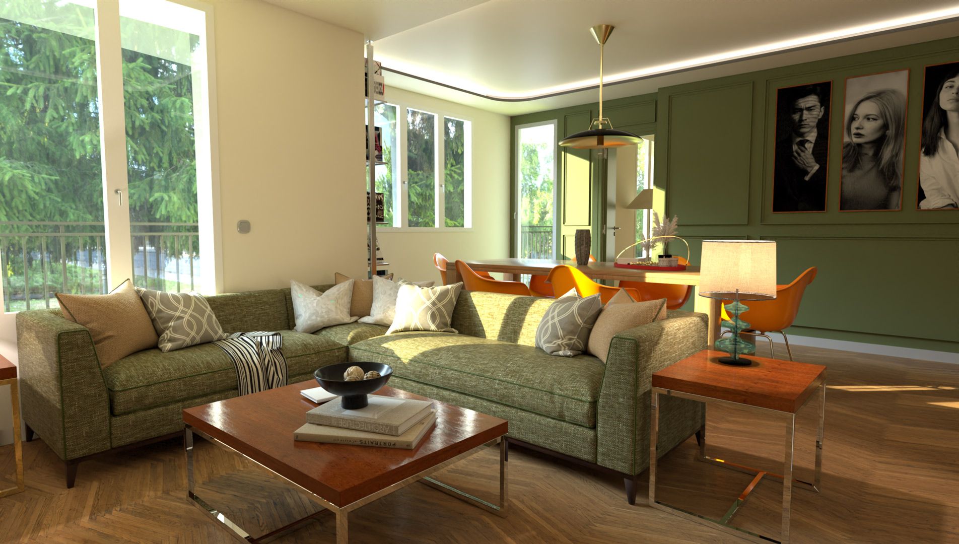

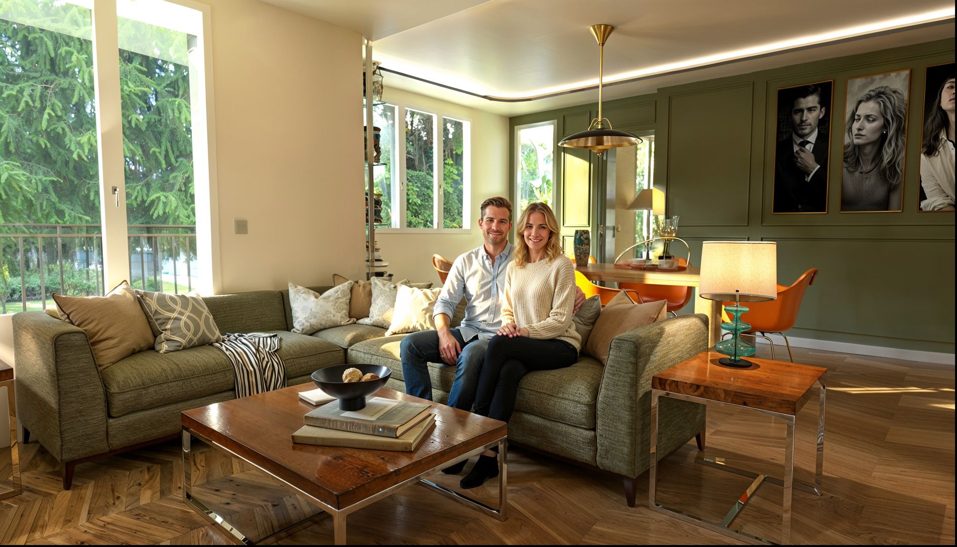

      Thomas, you asked me why I apply an upscale layer after a ray-scaping render. For scenes with windows, I have to do two renders, like a photographer: a light one for the room's exposure and a dark one to replace the "blown-out," overexposed parts of the window. D5 Render doesn't have this problem because its renders aren't truly photographic; they're a kind of pseudo-pathtracing.
      Krass
      • KrassK
        Krass
        On this page I show a comparison slider between the original rendering and the changes that Magnific Upscale adds
        Comparatif rayscaper/magnific upscale โ€“ jskup
        https://jskup.fr/wp-content/uploads/2025/12/animationsuite_0000_1.mp4 Avant Aprรจs
        jskup (jskup.fr)
        Of course, we then have to go back through Photoshop to correct the errors that the upscaling process generates.

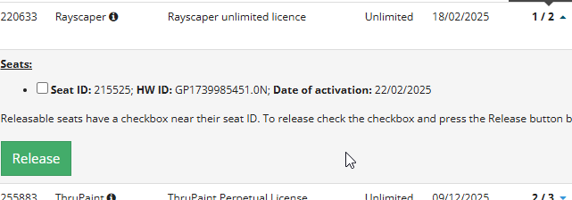

                        I reinstalled Windows; I suppose that explains the license issue I'm having? Rayscaper is installed on two machines.

                                      @Krass
                                      Have a look at this guide on how to release seats: https://rayscaper.com/faq/licensing/#how-do-i-release-a-license-seat
