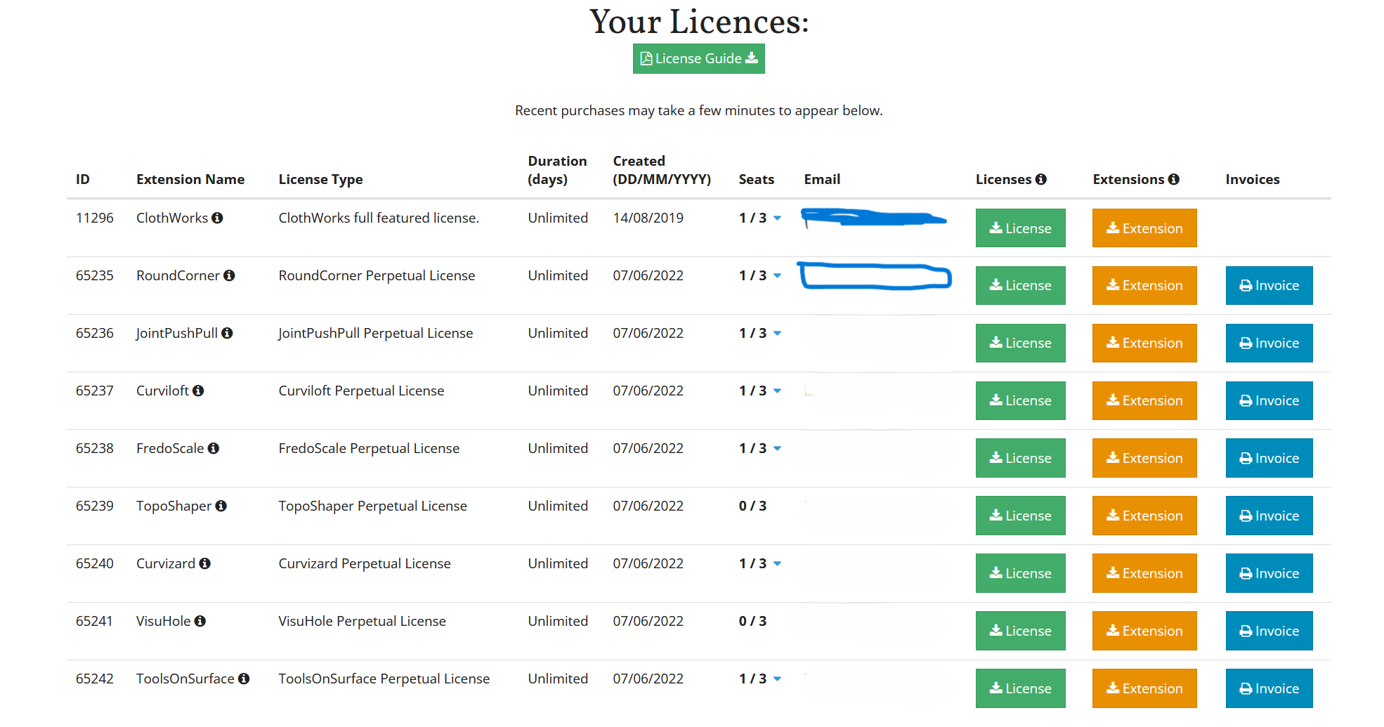

              Sica3
              erro: CODE ERROR A0B, como resolver tem as licenças os gulguis foram instalados aparece esse erro: CODE ERROR A0B
                Sica3

                      Sica3
                        Please delete your signate file at C:\Users\SomeName\AppData\Local\SCF Licenses
                        Restart SketchUpand activate any license
                          Sica3
                          Thanks for your help, they're working now. Captura de tela 2025-02-28 093535.png

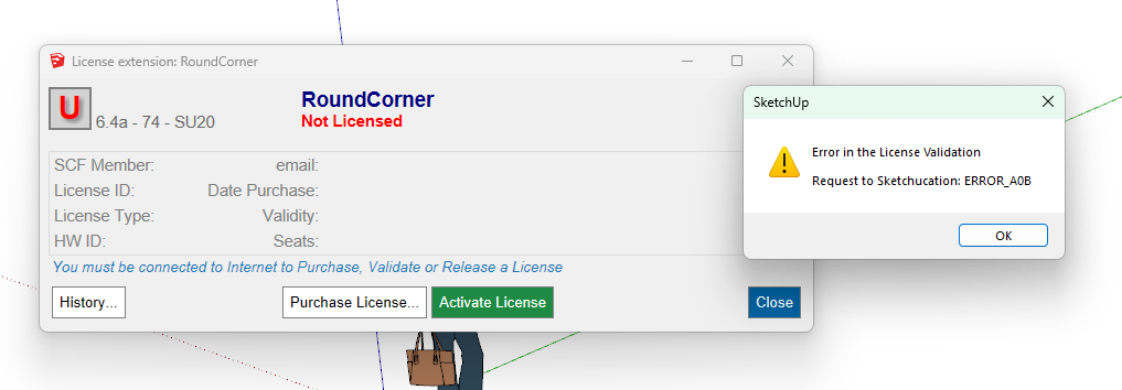

                              • P Offline
                                pavulon5
                                I have the same problem. I bought roundcourner and i can't activate license.

                                  Rich O Brien Moderator @pavulon5
                                  @pavulon5
                                  Might be a permissions issue. Repair your SketchUp install by downloading the SketchUp installer. Right-click the .exe and choose Run as Admin and choose Repair when prompted
                                  If your device is named using non-alphanumeric characters, áéíóú etc, please change it to only use alphanumeric.
                                  Other option is to go to C:\Users\SomeName\AppData\Local\SCF Licenses and delete your signature file. Restart SketchUp to generate a new one and try license.
                                  The error is related to the signature file.
