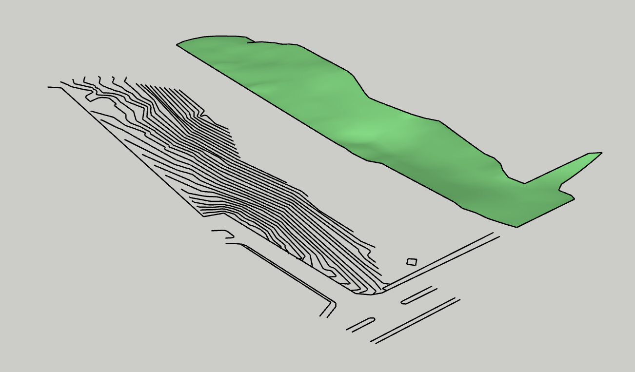

              @DenizMtly what is the problem?
              toposhaper terrain
              D 1 Reply Last reply
              • D
                DenizMtly @Rich O Brien
                @Rich-O-Brien It seems it's working with you, but not with me. Tried several times before but I'll give it another try.
                  Make sure your extensions are up to date
                  • D
                    @Rich-O-Brien They are all the recent versions. But the model I've sent was copied from another file and pasted in a new one and saved afterwards. The contours group was under another group. Therefore I was trying in that parent group and from outside contours group. After I saw you were successful, I copied it and pasted outside, then tried again, it finally worked. So it does not work if the group is under another parent group. Is that the case?
                      If your contours are nested, as in grouped in a group, then you will need to select contours after selecting the Parent group.
                      If your contours are just a single group then Toposhaper treats that as the selection.
                      • D
                        @Rich-O-Brien Thanks a lot!
