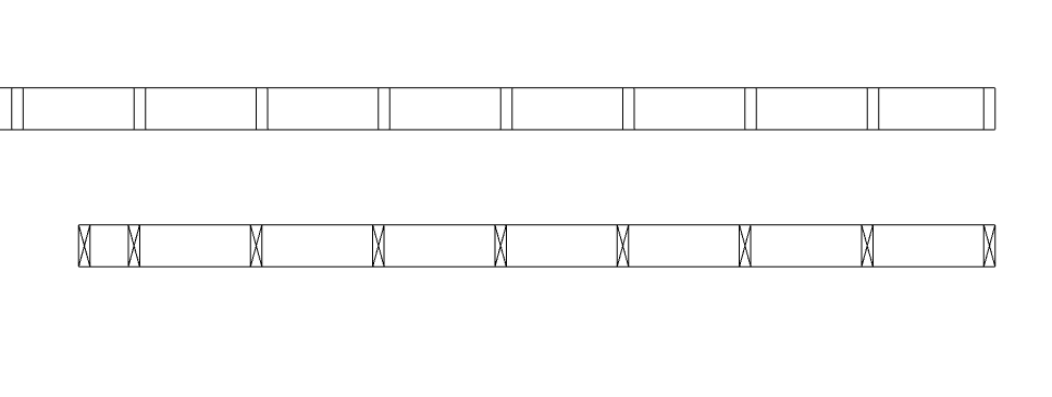

                      2nd Toolbar:
                      Like the Truss Plugin the Wall Plugin will have a second toolbar. The planned icons/tools will be:
                      • Wall Split
                      • Wall Move
                      • Window Edit
                      • Window Move
                      • Window Delete
                      • Door Edit
                      • Door Move
                      • Door Delete
                      To delete a wall it is just a matter of deleting it from the model, all windows and door embedded in that wall (group) will of course be automatically removed as well.

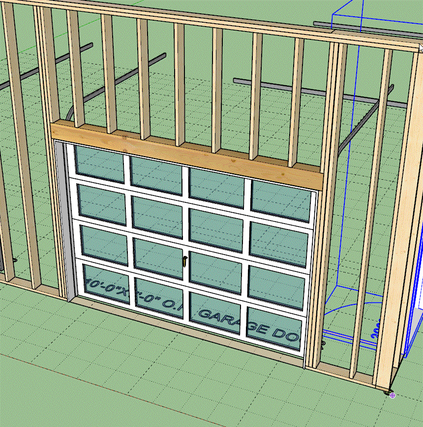

                                        Another preview showing the insertion of windows and some other features:
                                        View model here:
                                        3D Warehouse
                                        3D Warehouse is a website of searchable, pre-made 3D models that works seamlessly with SketchUp.
                                        (3dwarehouse.sketchup.com)
                                        http://design.medeek.com/resources/images/wall_su22_800.jpg
