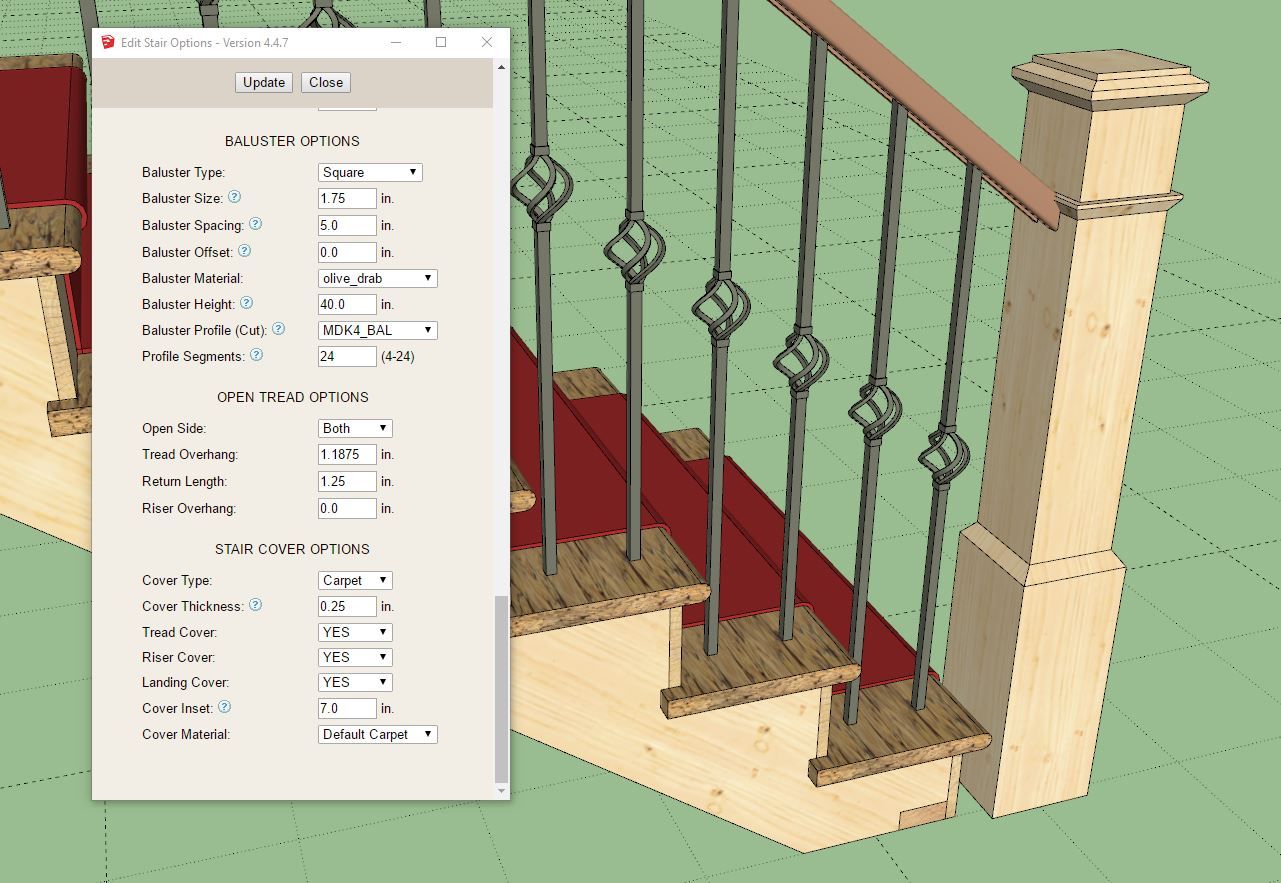

                        Version 4.5.0 - 04.20.2026
                        • Enabled custom components as posts for OTP handrails.
                        • Enabled "profile cutting" of posts for OTP handrails.
                        • Modified the bottom trimming algorithm for balusters to better accommodate complex baluster components.
                        • Added one additional ornamental iron baluster into the baluster component library.
                        • Added one OTP newel post into the newel post component library: LJ4270_43
                        I will readily admit configuring OTP handrails with their associated posts and fittings is a bit tricky, adjusting the various offsets takes a few iterations to really hone things in.
                        I appreciate everyone who has pushed me to flesh out the newel post and baluster capabilities. I feel like the stair module is a bit complicated now and perhaps even a bit clunky with so many options and variables but at the same time it is much more configurable and flexible and can I say with these new capabilities more powerful.
                        Obviously it would be optimal if I could spend some serious time and create many of the standard balusters and newel posts found in LJ Smithโ€™s general catalog so that the user would have a bevy of options to choose from without having to exert additional effort in creating their own. However, such an undertaking could easily consume two to three weeks and my development time is probably better spent elsewhere at the moment.

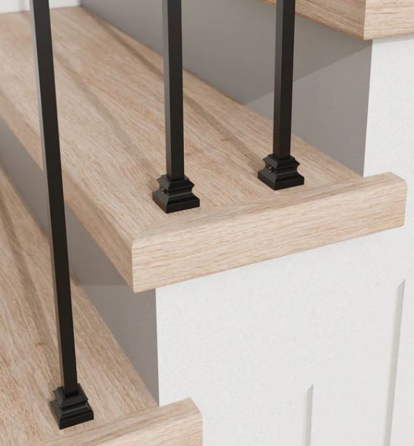

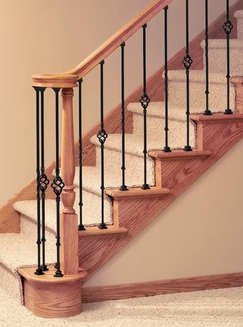

                                Well... I thought I was done with balusters and newel posts, but I'm not quite there yet.
                                The problem is that with metal or iron balusters they are often installed with a shoe as shown below:
                                My current algorithm installs balusters just like they are installed in real life:
                                First I trim the top of the original baluster component/group and then I have to trim them individually for each of their bottoms because the balusters may intersect the treads at different heights hence their heights/lengths will be different.
                                Because of this a predefined shoe positioned at the base of the baluster component may work for one location (ie. no trimming required) but then it will be removed in subsequent baluster locations.
                                What this means in practice is that a shoe (if that option were enabled) needs to be a completely separate group/component just as it is in real life. My algorithm needs to position it individually in the Z-dir just as I trim each baluster bottom individually.
                                Arguably, there is a lot going on with stairs, the guys that install these must be real craftsmen, I certainly take my hat off to them.
