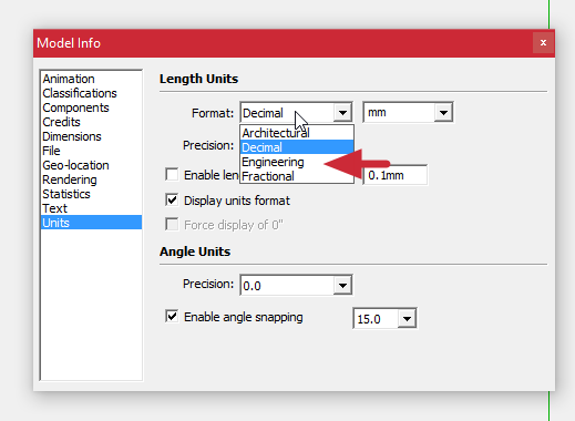

            There's only the Model Unit > Engineering in the Model Info dialog....
            But that limits you to imperial measurements.
