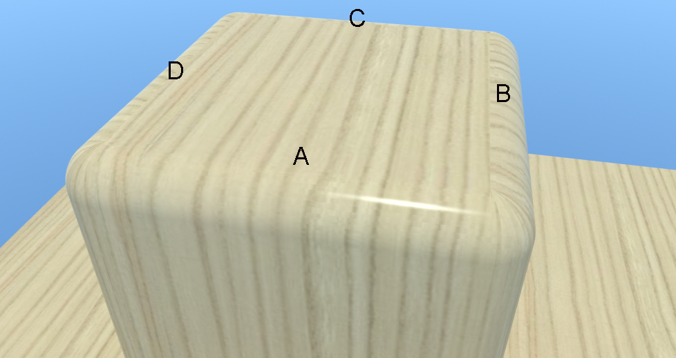

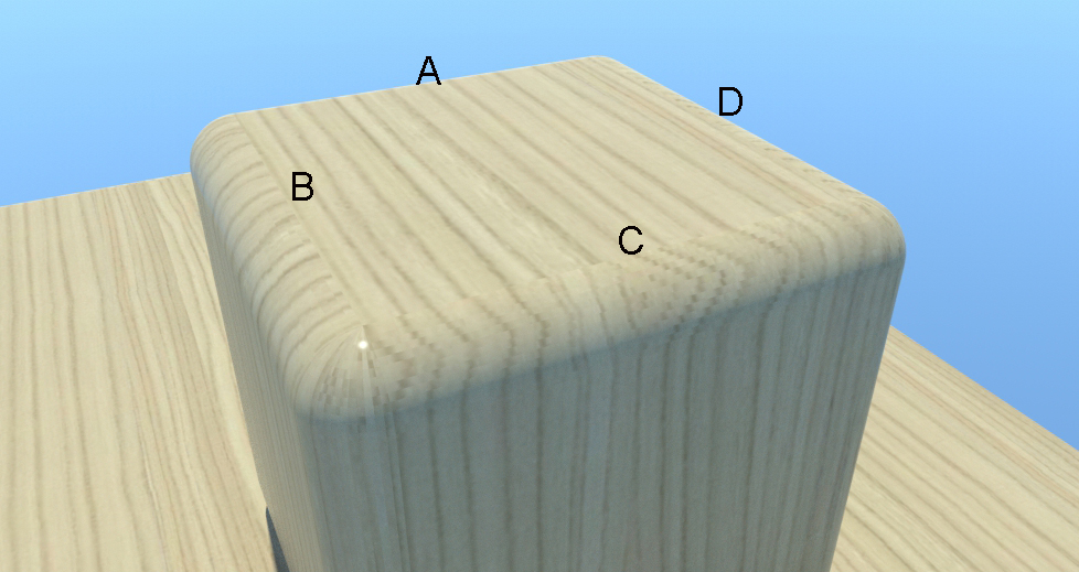

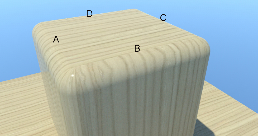

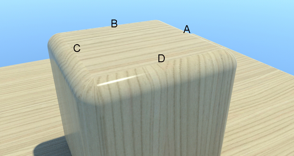

      Does anyone know how to make all rounded edges show a consistently correct applied material?
      See ther attached images. I made a box with Fredo round tool. My Steps were:
      1. Made the box.
      2. made the box a group.
      3. double clicked to open the group, used Libfredo round corner tool over entire box.
      4. closed the group, selected an ordinary material from a simple image I made into a texture from sketch up materials and painted the box (while it was an uneditable group).
      5. rendered.
      A is the only edge that follows around the rounded corner. All others have some distortion.
        ThruPaint ?

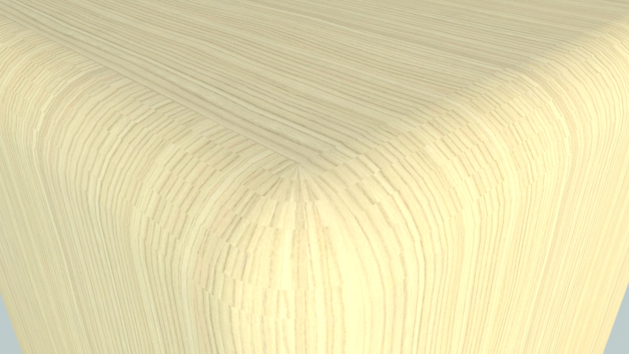

                        @dave r said:
                        @mr wolf said:
                        Hi...
                        1. closed the group, selected an ordinary material from a simple image I made into a texture from sketch up materials and painted the box (while it was an uneditable group).
                        Don't apply the material to the group/component wrapper. Apply it to the faces inside. applying materials to the wrapper means you give up options about how that material gets applied.
                        If you want the grain to run vertically on the sides of the block, you need an end grain material on the top.
                        Hi Dave R,
                        Thanks for your answer to this problem.
                        I have tried doing as you say, however, the result is no improvement. Perhaps I didn't understand what you meant? This is what I did according to your advice:
                        1. Made the box and grouped it.
                        2. opened up group, double clicked till everything was selected, applied round corner to entire box.
                        3. while it was still all selected, I painted on the material.
                        4. closed the group and rendered.
                        You can see close up the rounded faces along all the curves are still distorted. As far as the end grain goes, I understand all the grain on the box isn't matching correctly (if this was a real small block of timber), this wasn't really what I was testing or concerned about at the minute, however since you mention it, I guess end grain would be created in PS somehow?
                        Cheers!! Wolf πŸ˜„
                        Still distorted on all faces that are on the curved
                          The material can still be applied better but you'll actually be able to control it on each face. Somewhere you're going to run into a problem because the grain direction will cross.

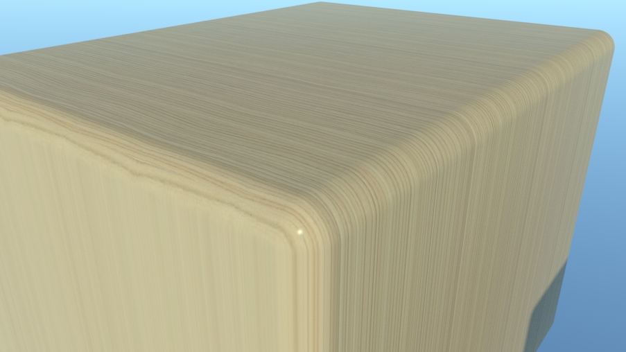

                                    • MR WOLFM Offline
                                      MR WOLF
                                      @mr wolf said:
                                      Hi Pilou,
                                      I dont think Thrupaint is available any longer. Not in the extension warehouse anylonger.
                                      Thanks Pilou!
                                      TIG sent me a link to the Thru Paint, I have been testing it and figured a simple solution out. Many Thanks for your help!
                                      • MR WOLFM Offline
                                        MR WOLF
                                        Thank you to all who helped. The Thru Paint did it perfect, just need to learn it as it has so many features.
