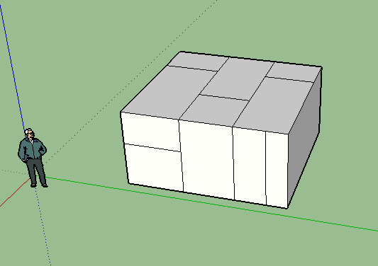

                    Groove-maker,
                    something like this:
                    • R Do not disturb
                      rv1974
                      @pilou
                      All options you mentioned aren't so suited for grooving.
                      The main objection: grooves are supposed to appear only by selected edges- no grooves in the corners!
                      And besides lattisizer and lattice maker are pretty buggy, JPP workflow demands 2D grooves to be pre-drawn manually (which is insane in the case of more or less large building).

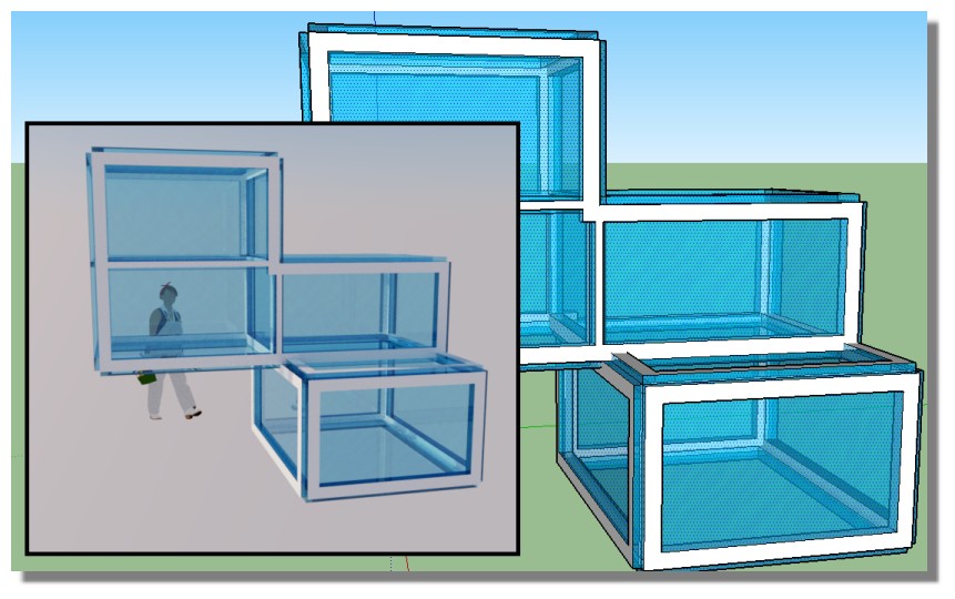

                                          • E Offline
                                            Einstein
                                            And one more question - when I make frames by selecting only faces, it nicely closes the angles. But if I have a more complex profile (that contains loose edges too) and select both faces and edges, then create the framing, it won't close gaps that appear where two lines meet.
                                            Can it be fixed?
