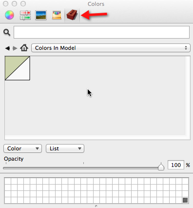

          It's different on the Mac. Here's how I do it.
          Go to the Materials window and click on the brick icon.
          Then in the List menu below the space where textures show choose 'New'. This will create a new library.

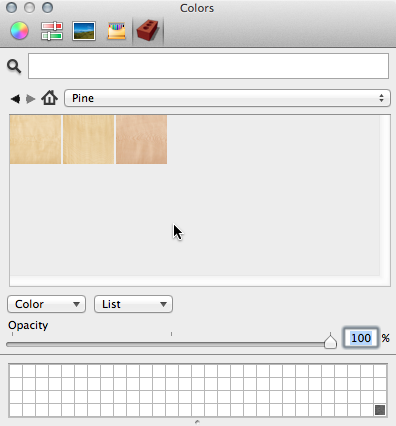

          Give the library a name.
          In the Color menu, lower left, choose 'New texture', navigate to and choose your texture image. Adjust its size as needed in the dialog box.
          Rinse and repeat for the other materials.
          Of course you can sort your materials into as many different libraries as you need.
