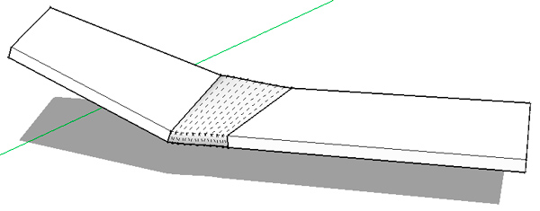

      this is what i am going for, this was sketched as an idea

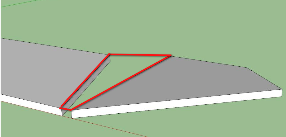

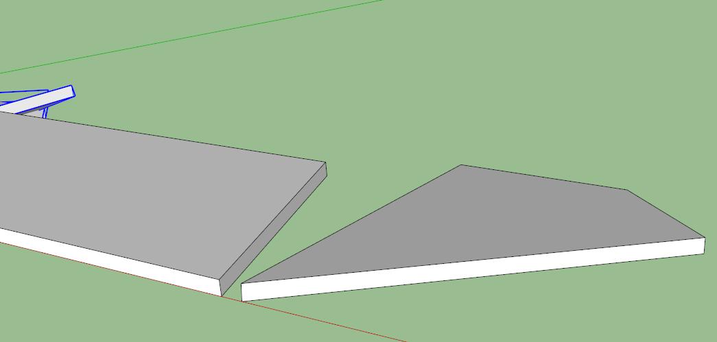

      these are the two pieces i wish to connect by another piece sloping down from the bigger piece to the smaller piece

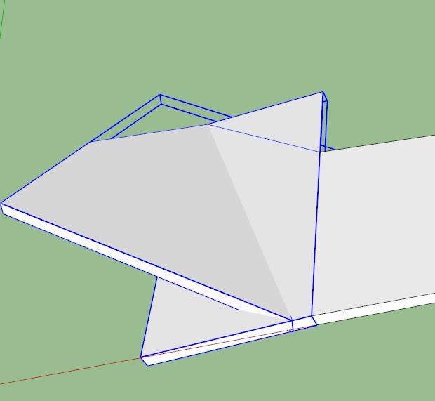

      so i have tried placing a square in between the two pieces and i cant seem to get it to work.

          CurviLoft, and a number of other tools, will give a swept transition between the two surfaces.
          However, if you want a 'straight intersection' or simply 'a third angular insert solution', then think of it as a 'hipped roof'...
          If the two forms do intersect nicely then just two lines added across the gap will make a connecting top face [repeat this for the bottom/sides].
          BUT it they are 'skewed' then you need to add a diagonal as well to form two triangular facets.
          You can smooth any edges afterwards...
            Are you planning to bend the wood or shape it to make a curved transition from one piece to the other? Or will you have three flat pieces joined together?
            If it is the latter, just use the line tool to connect the corners between the center section and the side piece. If upon completion of the loop you don't get a face, the piece can't be made as a flat piece.
