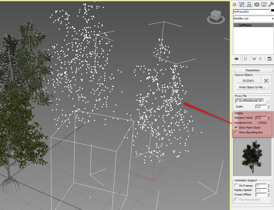

                  Got a suggestion for the proxy though:
                  Proxy display option like 3D Studio Max's mr Proxy where the proxy instance display a user specified number of vertices from the referenced model. That way you get a simple point cloud presentation of the linked geometry.
                  Alternatively, use the preview thumbnail on the proxy object. Though this means an extra material in the SU model.
                  My vote is on simple point cloud representation. One can use Contruction Points
