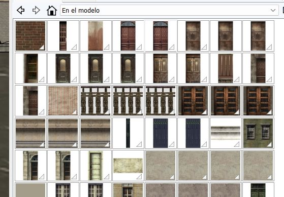

                                      • T
                                        Tom0212
                                        Hi TIG,
                                        When I use the tool, it isn't doing anything..
                                        Materials stay the same, and a consolided image is not added to my materials list.
                                        Running Sketchup 2020.
                                        • TIGT
                                          Are you sure you understand its usage...
                                          I just retested it in v2020 and it works fine.
                                          When you run it it asks if you want to set RGBA 'tolerances'.
                                          If 'No' then only materials which share the exact RGBA values are processed.
                                          If 'Yes' then you can set a +- range of values - e.g. all materials sharing the same RGB but with a varied A[lpha] transparency will be consolidated.
                                          Assuming some material matches are found, then it takes the first material in the list [alphanumerically] and makes that the 'base-material', then it replaces any other matching materials in the model's entities and within groups/components, with that 'base-material', and then it purges those now unused materials from the model...
                                          Run it with the Ruby Console open to see the report...
                                          • T
                                            Tom0212
                                            Hi TIG,
                                            I'm not quite sure I used the tool correct.
                                            Please review my attached .skp file.
                                            Not-consolidating.skp
