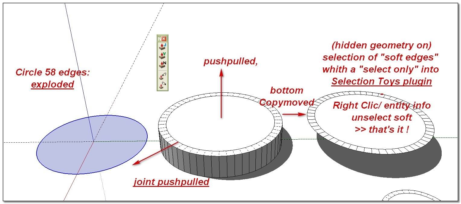

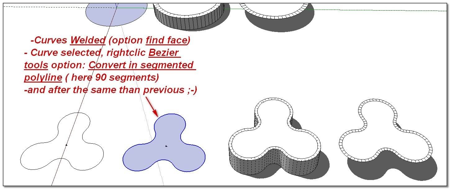

              Hi Adam (EarthMover)
              There must be various solutions for such needing: here the first solution I've in mind 😉
              http://i274.photobucket.com/albums/jj245/Spendauballet/SketchUp/EEBN001_th.jpg
              a fairly flexible method I think..
              http://i274.photobucket.com/albums/jj245/Spendauballet/SketchUp/EEBN002_th.jpg

              • EarthMoverE Offline
                EarthMover
                The extrude lines in projection tools extrudes along the vector.
                Martin, thanks for the interest. Minimally, I just basically want to be able to offset a face and have the line retained between the original and offset verticies.
                Ideally a scale extrude tool would have a broader benefit for other modeling tasks.
                I don't have a 3D example as there is no tool to do this..to my knowledge. I quickly did it in 3DS max to illustrate what I am talking about.
                EDIT - That's funny Simon, I was just sitting here doing the same thing as you are showing, but instead of JPP I just push pulled a copy up, scaled it in and then moved the new face back down, unsoften edges for the same result.

                  • simon le bonS Offline
                    simon le bon
                    HeHe, Adam and Gai..,
                    We have to do quick in this place with such many experienced users 😆
                    But I think a remark must be told:
                    On a complex curved shape,( as a letter for example) an offset doesn't give the same result as a scale.
                    And as I can understand the process, Joint PushPull works as an offset operation
                    +++Simon
