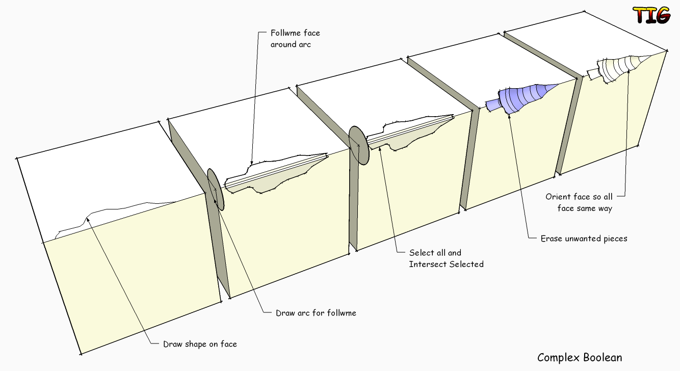

      • TIGT Offline
        • GaieusG Offline
          No, TIG, arrow heads are not circular like that. 😉
          You can start however with a lathed shape like in TIG's example model the "positive" (the arrow head) however - then remove half of it and use the scale tool to "flatten" the piece a bit.
          Still problem would probably be that the piece you place into the arrow is generally rectangular so the shape is a bit more difficult even than that. What age is it?

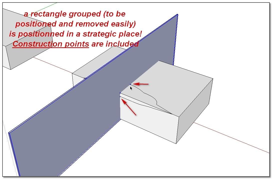

                                    • simon le bonS Offline
                                      simon le bon
                                      @ushumgal said:
                                      What I would like to do now is to remove the center line and have a cavity that curves from one line to the other so that when I mirror the block, there will be a clear arrowhead-shaped depression in the middle of it, deep along the center line and tapering to the surface at the edges. Of course, when I simply erase the center line, it just leaves a hole right now. Is this what the skin plugin is for?

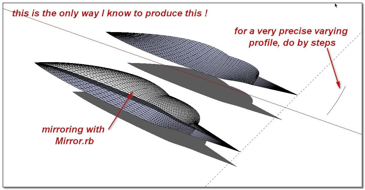

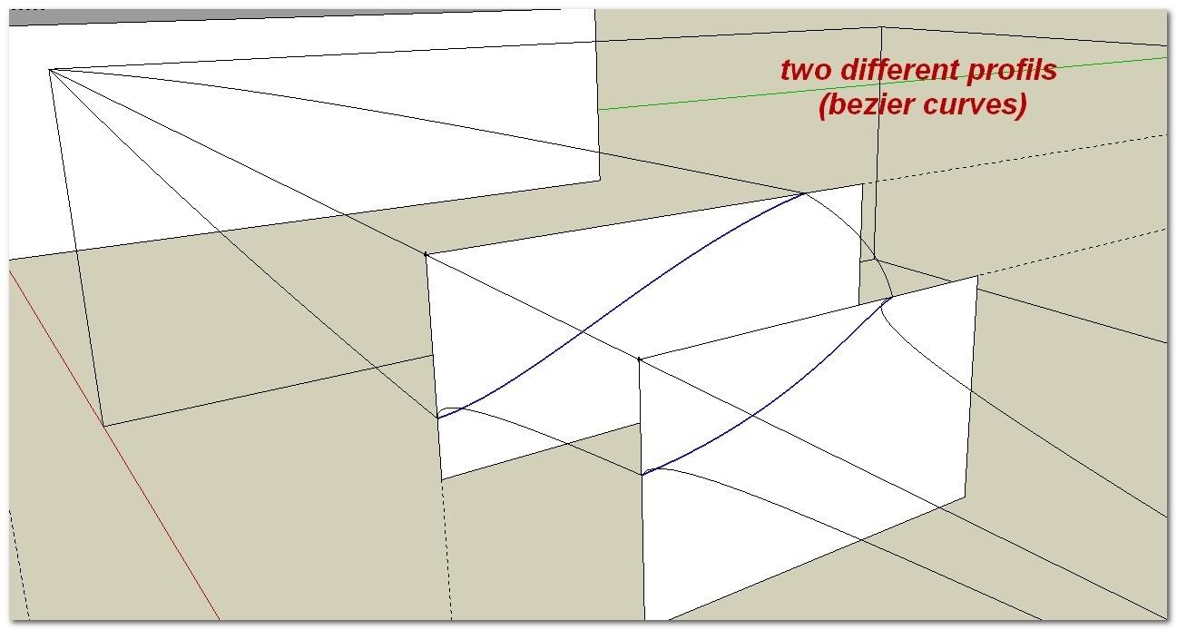

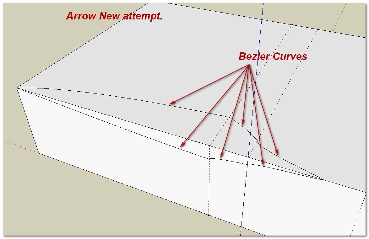

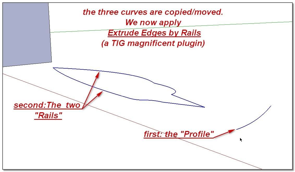

                                      Hi ushumgal
                                      As I can understand, you need round spoon shapes (I don't know better how to express 😆 )
                                      Here is a way with
                                      TIG_Extrude Edges by Rails
                                      I Have also used:
                                      RickWilson_Weld.rb
                                      Fredo_BezierSpline
                                      TIG _ Mirror.rb
                                      In your mould work, a boolean tool seems very useful
                                      Whaat_BoolTools (commercial)
                                      http://i274.photobucket.com/albums/jj245/Spendauballet/SketchUp/Arrow001_th.jpg
                                      http://i274.photobucket.com/albums/jj245/Spendauballet/SketchUp/Arrow002_th.jpg
                                      http://i274.photobucket.com/albums/jj245/Spendauballet/SketchUp/Arrow003_th.jpg
                                      http://i274.photobucket.com/albums/jj245/Spendauballet/SketchUp/Arrow004_th.jpg
                                      http://i274.photobucket.com/albums/jj245/Spendauballet/SketchUp/Arrow005_th.jpg
                                      http://i274.photobucket.com/albums/jj245/Spendauballet/KerkyThea/arrowKT001_th.jpg
                                      http://i274.photobucket.com/albums/jj245/Spendauballet/KerkyThea/arrowKT002_th.jpg
                                      😉 simon

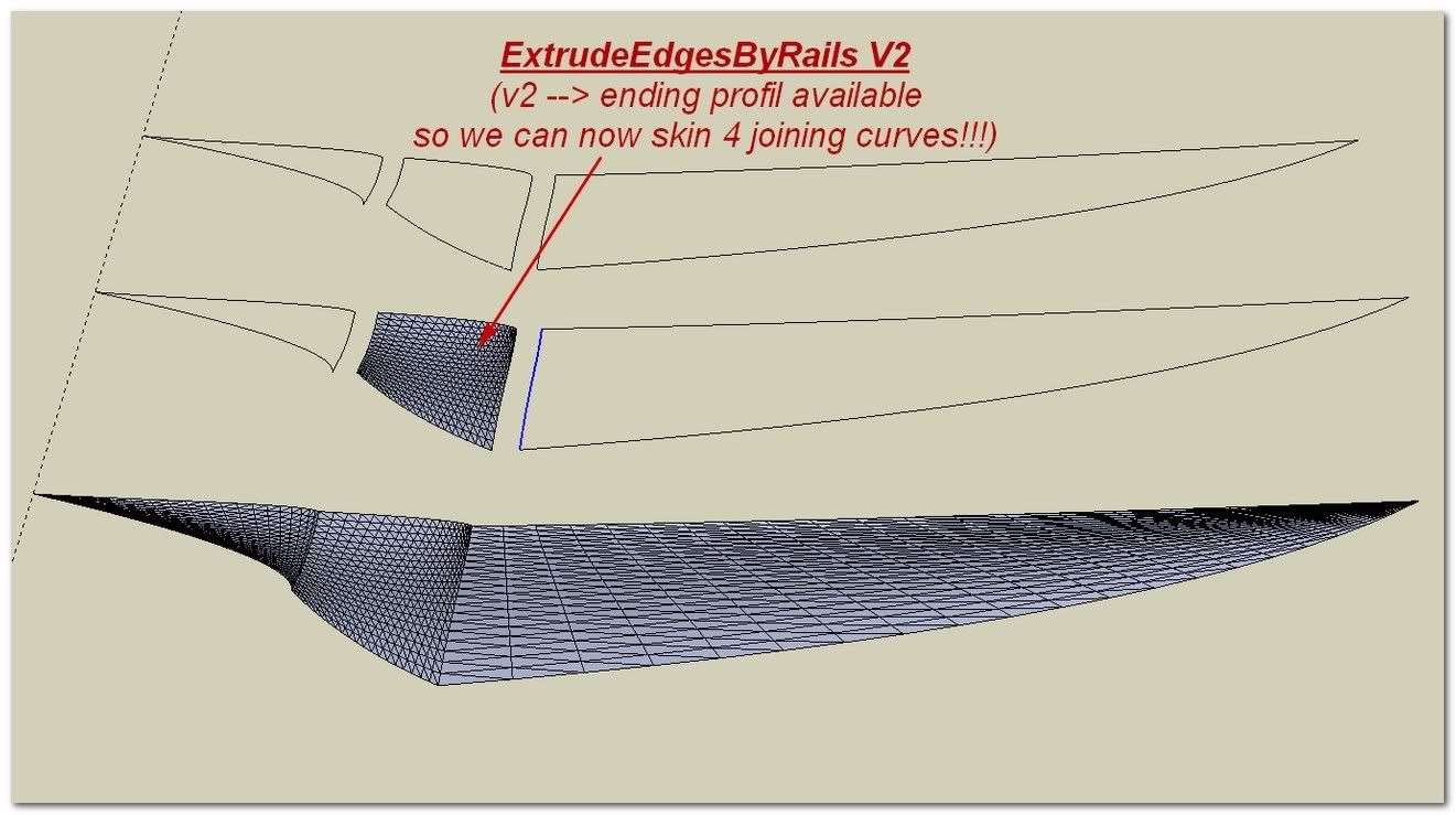

                                            Tig has is own explanation about that: Here

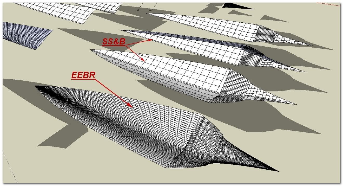

                                            But In fact it was very uneasy to skin the middle segment with EEBR for it was not possible to skin directly 4 joining curves.
                                            I said "IT WAS" because ExtrudeEdgesByRail V2 is out and this limitation has now expired 🎉
                                            Segmented arrow:
                                            http://i274.photobucket.com/albums/jj245/Spendauballet/SketchUp/Arrow2nd_001_th.jpg
                                            http://i274.photobucket.com/albums/jj245/Spendauballet/SketchUp/Arrow2nd_002_th.jpg
                                            http://i274.photobucket.com/albums/jj245/Spendauballet/SketchUp/Arrow2nd_003_th.jpg

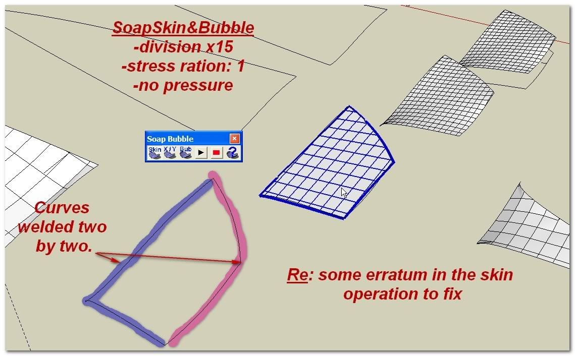

                                            You can also use Soap Skin & Bubble
                                            Which add the possibility to inflate or depress the skined faces.
                                            The process need to be initiate with Weld operation for SS&B works with two joining curves. Some small fails may happen and need to be repaired. Something a bit difficult for newbies.
                                            http://i274.photobucket.com/albums/jj245/Spendauballet/SketchUp/Arrow2nd_004_th.jpg

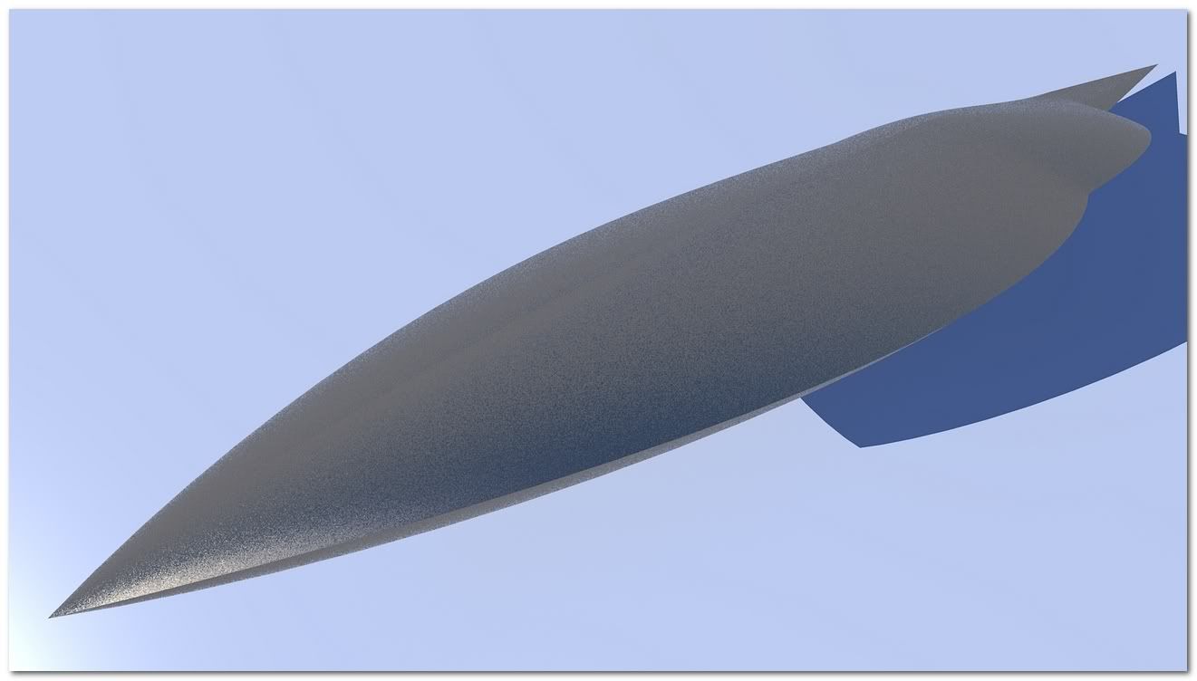

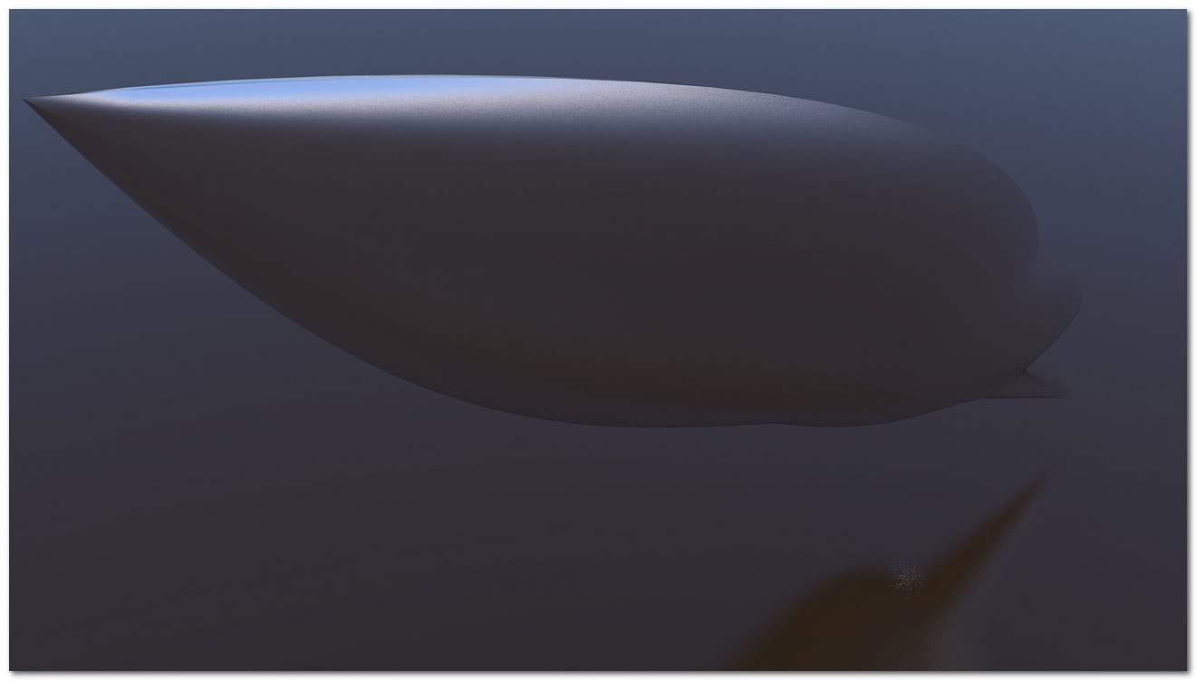

                                            The two different skins:
                                            http://i274.photobucket.com/albums/jj245/Spendauballet/SketchUp/Arrow2nd_005_th.jpg

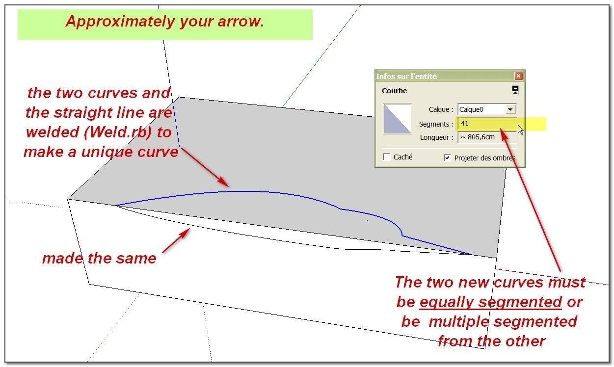

                                            I see you are doing skins manually to join your curves (good thing). This can be made with plugins. Unfortunately, powerful ArchitectBoy's Skin.rb (& see also& skin thread) only skin separate curves, but Rick Wilson Curve Stitcher does it very simply
                                            (you can throw a glance on my little skin reminder here even if it must be updated)
                                            ++simon
