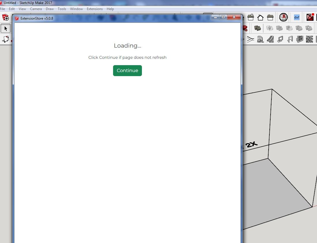

                            Bublifuk21 @Dave R
                            @Dave-R unfortunately, it does not work for me. I have installed Extensionstore v5.0.8., but I see only button continue, but it not work. I think, there is problem may be with firewall, or something like that, because my PC is in domain, which is not directly on internet. But all other updates are function normally. Sketchucation.jpg
