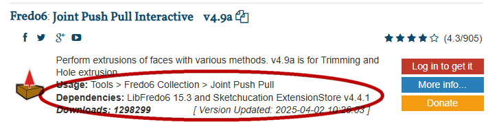

                Hey, this version seems to be crashing Sketchup on SKP 2023. Crashes anytime I try to apply the extrusion by pressing enter. Any ideas what's up?

                  @bzqp use the current version of Joint Push/Pull. Theold version is not suitable for SketchUp 2023.

                  Make sure to also install the latest version of LiFredo6 and the Sketchucation ExtensionStore which are both required.

                    Hmm, the starting post states LibFredo6 is not required and the classic version works with all Sketchup versions. The new version seems to be paid from what I see, I'd very much prefer the free one.

                      @bzqp The first post in THIS thread was last updated in 2017. SketchUp has changed since then. I gave you the link to the version of Joint Push/Pull which works in newer versions of SketchUp.
                      The current version of Joint Push/Pull requires LibFredo6 and Sketchucation ExtensionStore..
                        Classic JPP fails on SketchUp 2018 and above because of changes to the ruby API. It is available for anyone on older versions of SketchUp.
