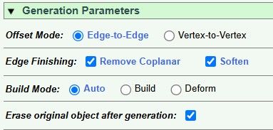

                        Fantastic Plugin and a great addition to my work flow. It's really cool that there is a way to use it and preserve the quad layout for Sub D workflows. It works well when using the main path based bending but unfortunately the Circular and Dome tools don't seem to work as well. They unsoften the triangulated edge. May well be in development for a future release but I though I'd mention it in case you were not aware.
                        • fredo6F
                          fredo6
                          It would help to see the model.
                          Note that there are options to prevent auto-smooth
