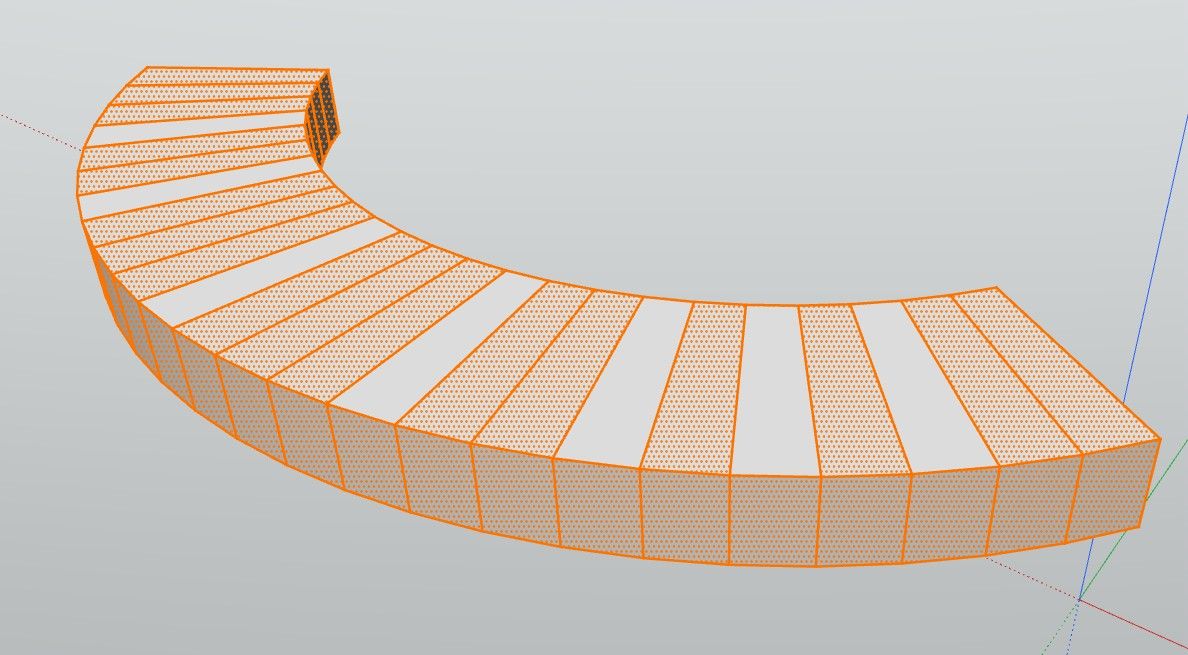

                                            @pilou About your request for a sweep between 2 profiles and 2 rails: is it something like this?
                                            You pick a start profile, an end profile and two rails. The section blends from one profile into the other, and the rails set where each section sits, how it turns and how wide it is. Closed profiles get capped, so you end up with a solid.
                                            Mind you, this is just a demo: a vibe-coded plugin to explore what we can do with the plugin API, not a fully fleshed-out tool. But I think it could become a nice plugin. Let me know if this is what you had in mind, or what's missing.
