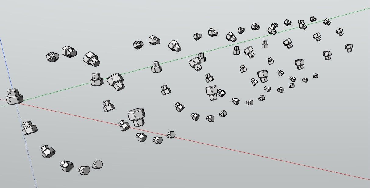

                        • pixelcruncherP
                          New in Modlumi: copy arrays with progressive scaling
                          You can now combine Move or Rotate with Copy and scaling to create progressively smaller or larger copies.
                          The GIFs show two examples:
                          Move + Copy: enter x6 80% to create six copies, each 80% of the previous size. The spacing scales too.
                          Rotate + Copy: make a first copy at 30Β°, then enter x12 90% to create twelve copies that shrink around the same pivot, forming a spiral.
                          Tap Ctrl while using Move or Rotate to enable Copy, place the first copy, then type the count and scale and press Enter.
                          Curious to see what you’ll build with it!
                          • KrassK
                            Krass
                            perfect!
                            Krass
                              Very cool and absolutely necessary! Bravo! (special copy)
                              With that, infinite space geometry is open!
