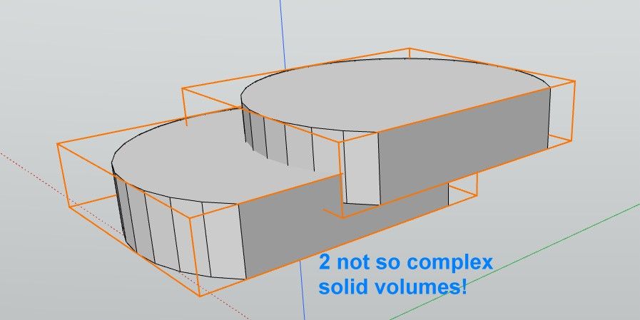

              What a reactivity! ๐Ÿ™‚
              But sorry this one is always a bug for me ! V 0.11
              • pixelcruncherP
                pixelcruncher Extension Creator @pilou
                @pilou Yikes, I thought I fixed this. Will have another look at this one. I'm already cooking up v0.12, so this will be fixed in v0.13 or later. Desktop release is also coming soon.
