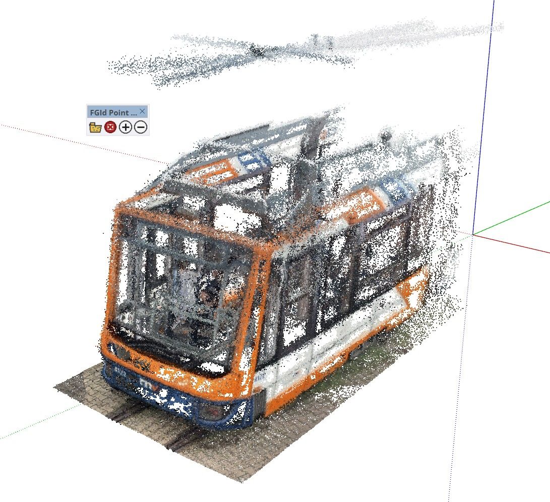

      Hi everyone,
      I’ve been working on a lightweight point-cloud solution for SketchUp called FGId Point Cloud.
      The goal is to display large point clouds directly over the SketchUp viewport while keeping SketchUp responsive, with the longer-term ambition of providing a lightweight alternative for point-cloud workflows.
      The current Windows test version supports:
      PLY
      LAS / LAZ
      E57
      RGB point colors
      GPU rendering
      Up to several million displayed points
      Point-size adjustment
      SketchUp geometry occlusion
      Point-cloud snapping / drawing tools currently under development
      The point cloud is rendered by a separate GPU renderer synchronized in real time with the SketchUp camera. The latest version uses an OpenGL offscreen renderer and a native Windows transparent overlay.
      I’m currently looking for a few people willing to test it on different Windows machines and GPUs.
      This is an experimental beta, so feedback about compatibility, performance, E57/LAS files, GPU behavior and crashes is particularly useful.
      Windows only for now.
      Download:
      https://nexdata.tarn.us/downloads/FGId_Point_Cloud_v3_15_9_Trial.rbz
      If you test it, please post your SketchUp version, GPU, point-cloud format and approximate number of points along with your feedback.

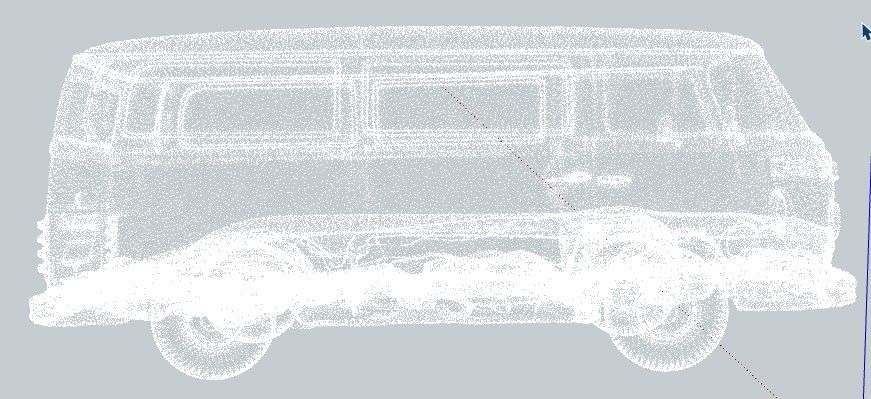

          I'm seeing the white points, but no color, even though the JPEG file is in the same folder as the PLY file. I'm using SU 2024.
          Krass
          juan974J 1 Reply Last reply Reply Quote 0
          • juan974J Offline
            juan974 @Krass
            @Krass , hello,
            that's because points can't handle textures, it's RGBA only.
            For your PCD you need to transfert texture to points.
            Try an las/laz or e57, ply can handle mesh and points, you imported a mesh's points.

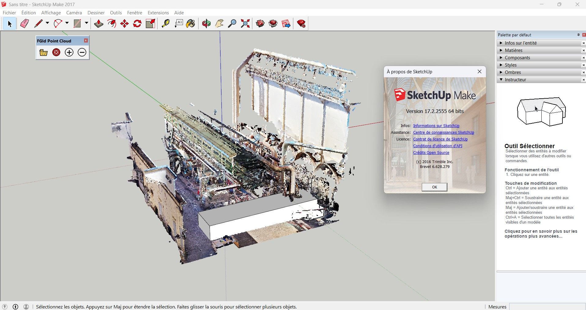

            I noticed it works in SU2017 :

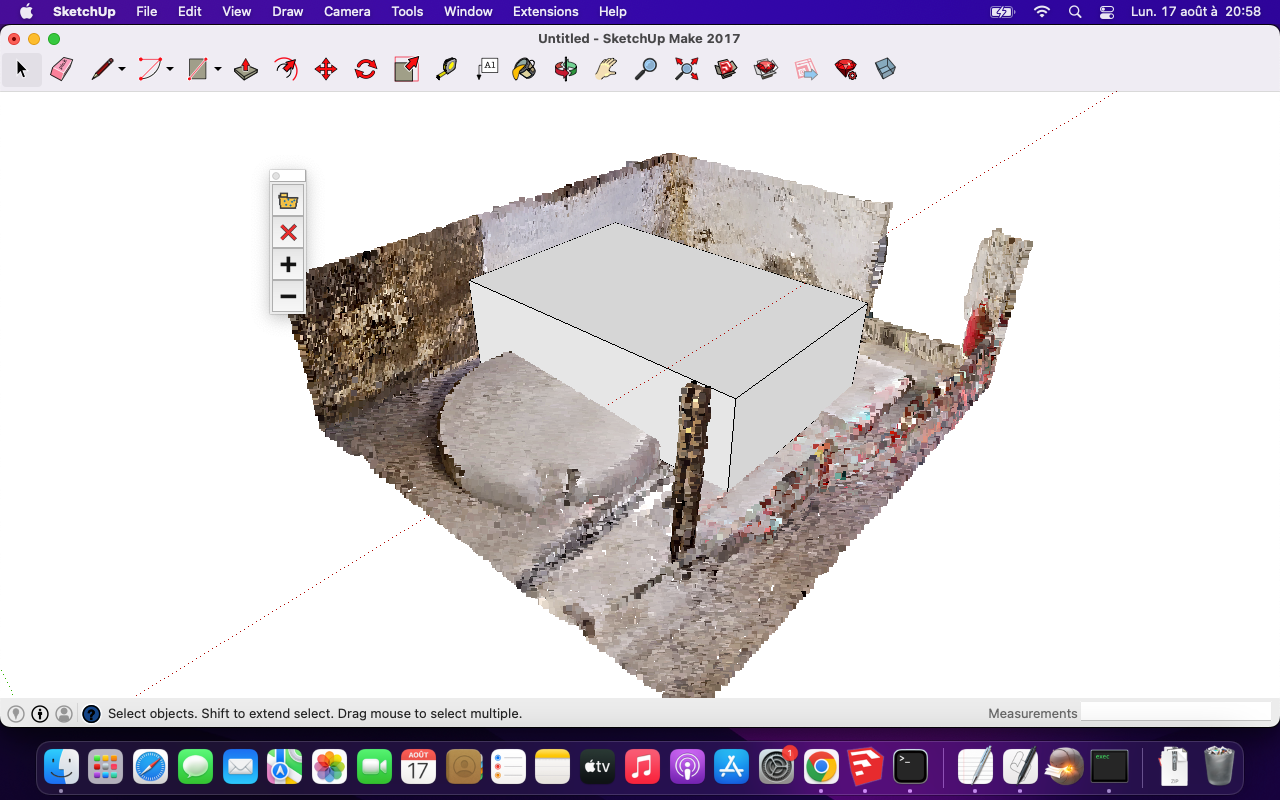

                Hi everyone,
                I dug out my old 2012 MacBook with SketchUp Make 2017 installed on it.
                I managed to compile a compatible macOS version of the plugin.
                Here is the RBZ file if anyone wants to give it a try : https://drive.google.com/file/d/1g55f7ezASR1dv0hSU-Dka6NwXQyiJAoi/view?usp=sharing
