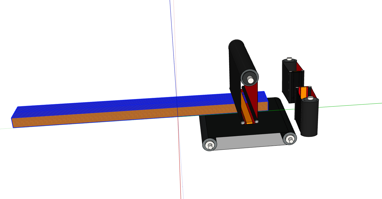

      I have a SketchUp model of a glulam beam sanding machine. The machine itself remains stationary, and I simply want to animate a glulam beam moving through the machine.
      My objective is:
      Beam starts at the machine entrance.
      Beam moves through the machine.
      Beam exits the machine.
      Eventually I would like to rotate the beam 90° or 180° and run it through again to demonstrate different sanding processes.
      The beam is a separate SketchUp Group and can be selected independently from the machine.

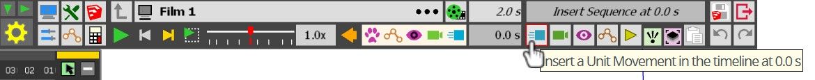

          You need to use the Clip Editor (first icon on toolbar) to use the GUI to add a Movement
          • E
            ericdjohn
            Thank you, but how do you select the object to move
              Did you click New Movement?
              It will refactor the GUI to a dedicated Movement panel.
              The order of operation would be pick your transformation choice then select the object to apply that transformation to.
              You don't pre-select objects. Pick type then object to apply type.
