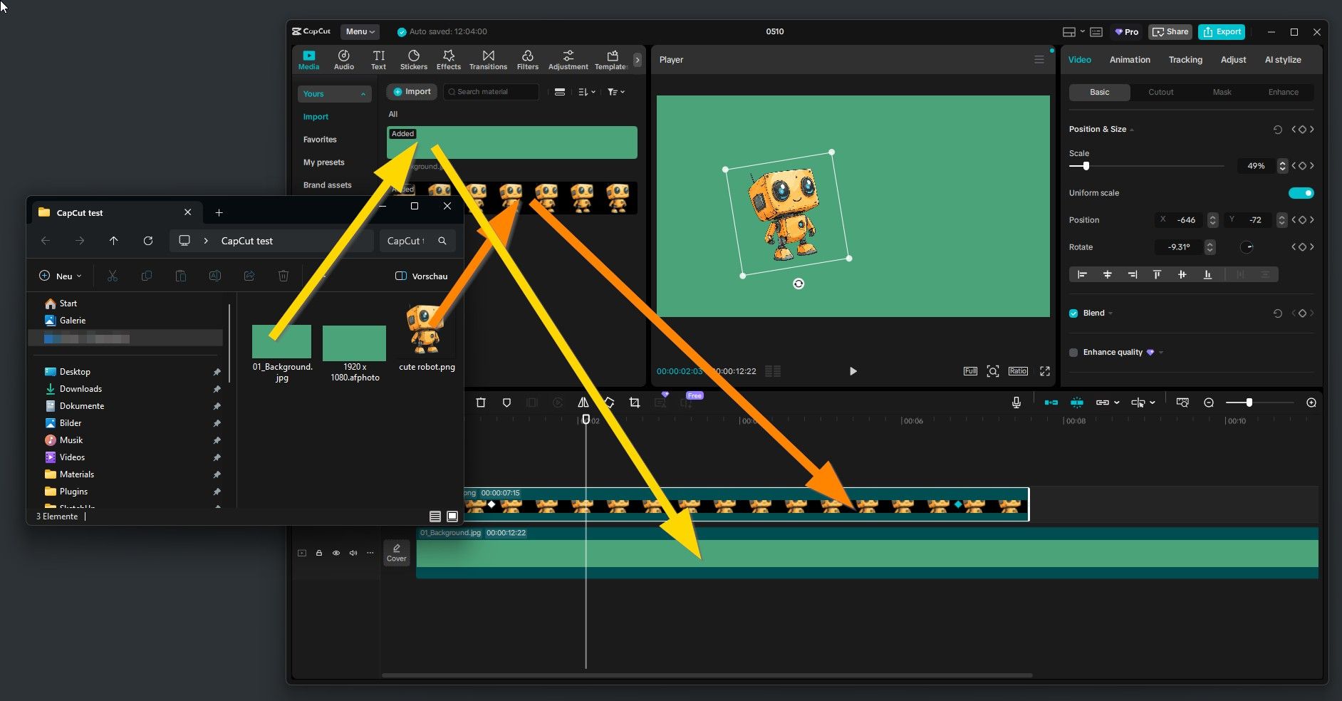

                      • HornOxxH Offline
                        HornOxx
                        Hi again 🖐️
                        even though I don't exactly understand what kind of result you're aiming for, maybe these tips will help you:
                        To create my own custom background, I edit my own HD JPG (1920 x 1080 px). In my example, a simple green JPG created using any image editor. This way, I set the video format in advance.
                        This JPG can be a custom background color or even the family photo from last Christmas. This background image spans over the entire duration of the video and is located on the lowest video track!
                        In the video tracks above it, you can play around with your content: You can make text or other image files fly across the screen, or simply fade them in or out at your desired speed, or animate them, or or or... (In my experience, less is often better than too much.)
                        Your slideshow in the track editor will probably end up looking something like a staircase that rises diagonally upward to the right 😉
                        Once you figure out how to create a nice transition or a keyframe animation, capCut is actually pretty simple and straightforward...
