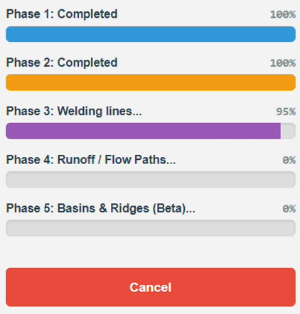

            My main motivation for writing NnC SurfGen Pro wasn't to reinvent the wheel, but rather to create something entirely standalone, extremely easy to learn, and focused purely on speed for rapid conceptual work.
            As a civil engineer, there are many times when I open SketchUp and just need a quick, realistic terrain to start testing a layout or doing a preliminary study, without having to import external heightmaps or navigate complex toolbars. I wanted a "plug-and-play" tool: you open a simple UI, click a button, and instantly get a surface and its contours ready to work on.
            Also, I've programmed a small additional workflow feature: the birds-eye-view animation you see in the video is generated entirely within the extension. I wrote an automation tool called NnC OrbitShot Fast, which allows me to set the focal point and duration of the movement. It then creates the necessary scenes, allowing me to use SketchUp's native animation feature to generate that smooth orbiting effect in a single step.
            It is built exactly for those moments when you need quick context to start a job fast and friction-free.
            Since you know the plugin landscape so well, do you think there is still an appetite in the community for this kind of "quick-start / all-in-one" approach?
            Thanks again for taking the time to take a look!
