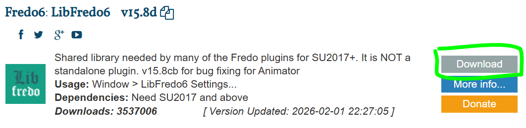

              That is what I have downloaded.
              I still have not been able to get it working.
              Even when I have gone through the uploading process through Sketchup Extension Manager, I am still getting this error
              I have many of the Fredo extension, and this is taking a lot of my time.
              Will I have to remove Sketchup and reload just to get this to work?
              Not sure what I need to do

                I was able to solve it my self.
                I went into the Sketchucation Root Directory Plugins installer and removed all earlier versions of the Libfredo,
                Closed down the program
                Opened the program
                Reinstalled the current version libfredo through Ext. Mng.
                Closed program
                Opened program
                Topo Shaper is now working
