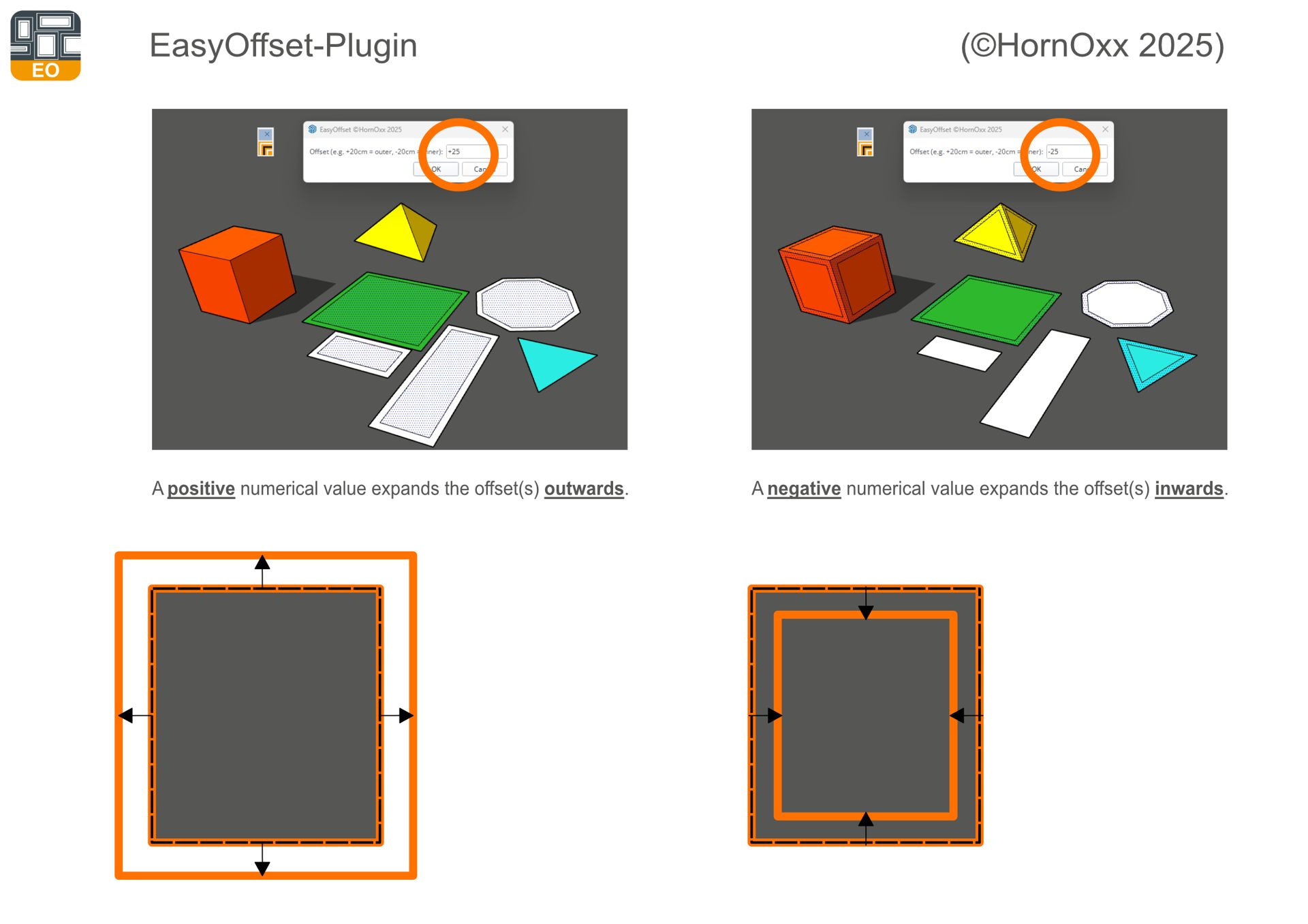

      Hello everyone, just to let you know,
      I have just released my third plugin, β€˜EasyOffset’.
      It is another very simple offset tool that joins the ranks of existing offset tools that I also use all the time.
      EasyOffset creates offsets for one or more selected faces: outward by entering a positive numerical value or inward by entering a negative numerical value – nothing more, nothing less, robust and fast, no smart features or multiple offsets at the same time. Not necessarily the reinventing the the wheel πŸ˜‰, but again free and still good enough to share here and for me the first time I had ever created an icon bar.
      Like my other plugins, it was developed over the last few months based on my everyday tasks.

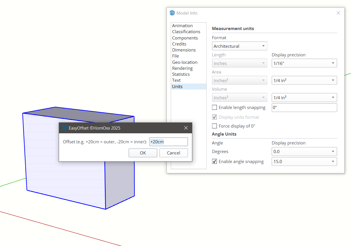

              • G Offline
                Glenn at home
                Very nice. Any way to change units?

                  • HornOxxH Offline
                    HornOxx @Glenn at home
                    @Glenn-at-home said in EasyOffset / my new plugin #3:
                    Hi Glenn-at-home, Thanks!
                    The plugin should work correctly in your preferred unit format (or doesnΒ΄t it?).
                    (yes, the +/- sample default-text in the input window may be or is a bit confusing though because of the cm and I only realise that now because of your question)
                    never trust a skinny cook
                    G 1 Reply Last reply Reply Quote 0

                      • G Offline
                        Glenn at home @HornOxx
                        @HornOxx Hey and thanks for getting back to me. It's defaulting to the units of my model. Not in 2025 nor 2026.
                        Thanks
                        SketchUp Pro 2025/2026 Dell XPS 8950 i9-12900K 64GB Ram RTX 3080
                        HornOxxH 1 Reply Last reply Reply Quote 0
                        • HornOxxH Offline
                          Thanks for your feedback Glenn-at-home
                          Hmm, strange. I used also an inches default Master for testing. For me, entering inches (for example) works without any problems in the SU versions mentioned. Is there perhaps something wrong with my inch measurement entry and doesnΒ΄t correspond to practice? For example: for 15 feet inward,would you write " -15 " or " -15' "?
