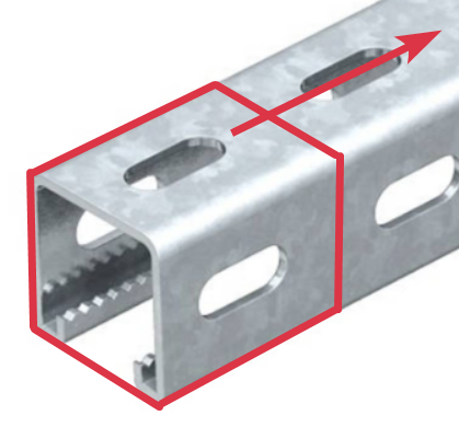

      Is it possible to create repeating cut holes in a ProfieBuilder profile? Trying to recreate this attached ref.
      Have created the profile in PB4 without issue. Just the pill-shaped cutouts are trickier to create in a repeating manner.

        I'd used a texture rather than actual geometry.
        Otherwise it needs to be an Assembly where you array it end to end. That wouldn't work for curved paths though.

          The profile would only be on straight edge paths.
          How would you achieve it as geometry? Itโ€™s likely Iโ€™ll need to export geo to another app at some point.
          • Rich O BrienR Online
            I'd make this section:
            Then use that to make an Assembly
