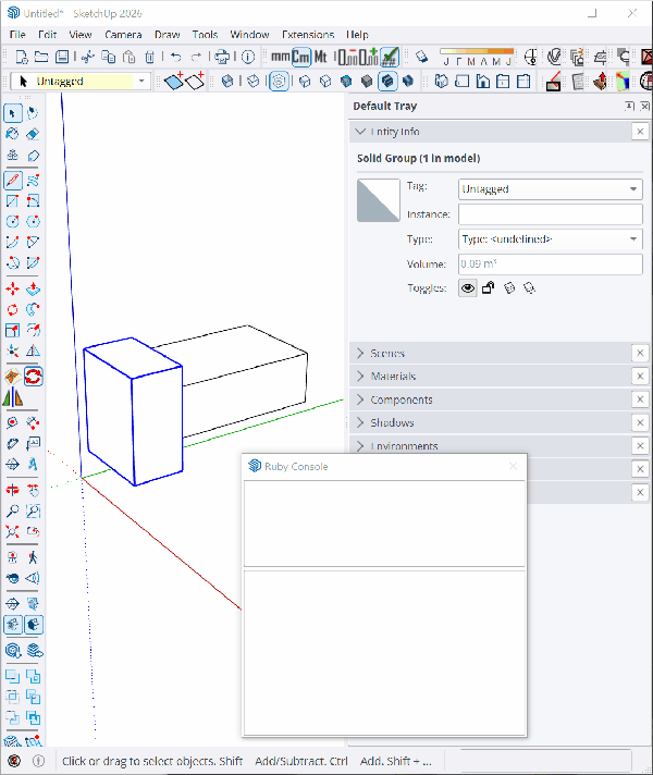

      Hello, in the Sketchup 2026 version, the tab command, expanding an object with entering exact values, behaves abnormally.
      The tab command responds very poorly, I have to press the button several times before the window for entering dimensions opens.
      Can you please advise me how to fix this problem?
        I guess you refer to FredoScale Box Stretching.
        I am not able to reproduce any issue with TAB on Windows and SU2026.
        Can you give more details on your environment. Also, keep the Ruby console open to catch possible errors.

            cesaro36
            Same experience here as @szabo
            After some search and some test i fount that by pressing tab the sketchup window cycles between the gui model, then the side tray, then something else and then back to model. That's why several plugins doesn't behave as expected, previous versions didn't have this behavior.
            I didn't find any solution. So annoying.

                        Confirmed it happens here on 26.0.429 Win 64-bit (which is the latest version according to the site) Windows 10 with the latest updates installed.
                        I've been doing some tests and it seems like the TAB key is making random stuff get focused inside Sketchup itself, like the Tags toolbar for example. Here's a gif showing the issue. I'm pressing TAB and space to make the Tags toolbar pop up.
                        EDIT 1: Here's a gif showing the error. I hope it helps.
                        EDIT 2: I think I've nailed it down to the toolbars. When I hide all the toolbars, it works on the first TAB.

                              Maybe you could just disable the Tag toolbar (with its dropbox). I can't reproduce it myself, but there might be some interferences, and this is new to SU2026.
                              pilgerP 1 Reply Last reply Reply Quote 0
                              • pilgerP Offline
                                pilger @fredo6
                                @fredo6 Yes. Disabling the toolbars fixes the issue.
                                At least on my setup, the TAB cycles through the Tags and Shadows toolbars. Disabling them both makes the New Dimensions dialog opens on the first TAB.
                                But I kinda use those toolbars 😓
                                I guess I'll stick to having to press tab a lot for now. Or right click and go on with the context menu option.
                                If is there anything I can do to help fix this, shoot me a msg.
