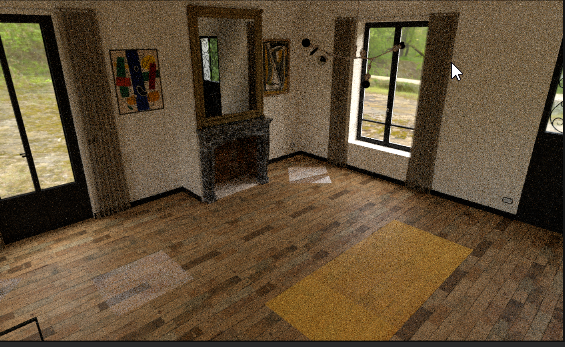

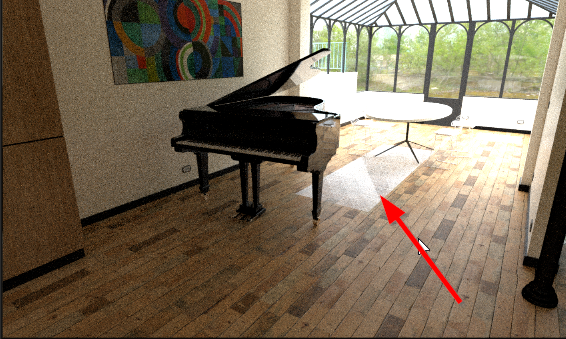

            Many thanks for introducing me to this extension which allows me to edit materials on faces deeply buried in groups or components.
