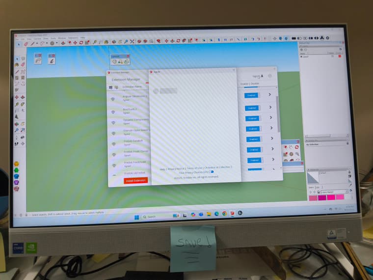

      Apologize in advance for the long-winded explanation. I recently was having issues with my 2017 sketchup issues where when I would use a command any command such as move, rotate and so forth in the middle of the operation it would lose its command, and stop, I would have to go back hit the move button again to move the object sometimes it works most the time it stops I didn’t know if that was memory, having said that I wanted to start a new account on my computer and see if I was having the same issues also wanted to load all my plugins that would also determine if I’m having issues with a memory. So that’s why trying to log on to SketchUcation in sketchup it would just show a spinning (not connecting) and as I was trying to say earlier I was logged on on my other account didn’t know if you can only be logged on as one user ID.
      • G
        Gábor
        Exactly where do you want to log in to? Could you send a screenshot of the login screen you want to log in? And also the spinner screen?
          So this is as far as I get. Trying to get my plugins mainly Fredo the few others loaded, Helix along curve, true bend, loaded. Curvaloft is what I was going for I've already paid for it a while back and it works on my other account on the same computer. My original account that I had mentioned they all work I considered signing out but it would not let me so I gave that idea up worried I couldn't get back in. Thanks for reaching out and trying to help me John

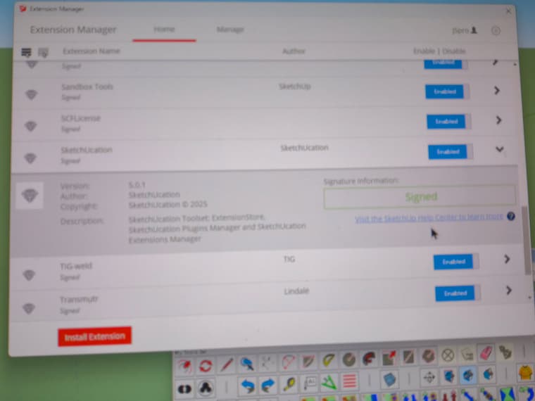

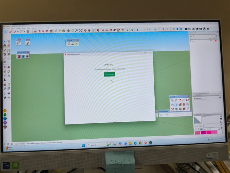

                @TIG appreciate your help and guiding me. So I did download and update the extension store successfully I hope, because it showed up on my desktop on SketchUp but when I go to click the store it just says click continue if page does not refresh but it does not get me to the store. Also I would like to note that once I did that I was able to get curvaloft from Fredo to work but without the store I cannot download future plugins I will send you a screenshot of the extension store V5.0.1 if you could help me through that. Thanks John2247.jpg

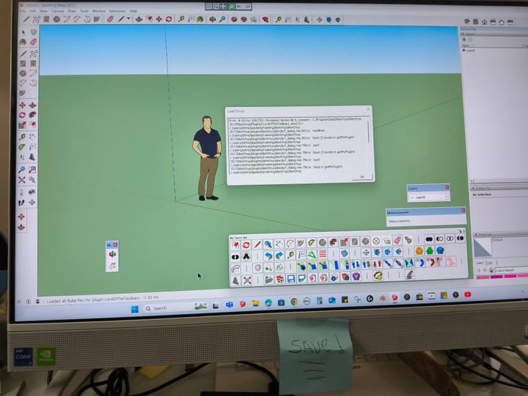

                  So now I'm really in trouble I believe now I went to my original account to try to update the sketchucation store and now I'm having issues with the store The icons that appeared as red squares have turned into round excess showing me that it's not working I tried to get rid of them and now this air appears which is in the screenshot looking for help.

                    Gábor
                    @Jspro
                    Thank you for the screenshots. It looks like you have permission issues, SUCTools can not read one of your files in the plugins folder. We need @TIG to look into this.
                    • TIGT
                      @Jspro
                      All or the files and subfolders in your plugins folder [path in the error messages] should have appropriate FULL permissions.
                      Try the following:
                      Select the 'plugins' folder's icon, right-click > 'properties', then 'security' tab, your user-name should be listed, choose the 'edit' button and ensure that you have 'full control' set up. Choose 'apply', then OK.

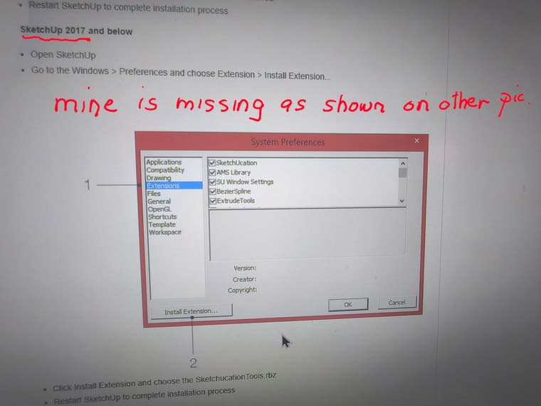

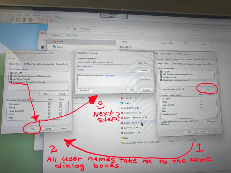

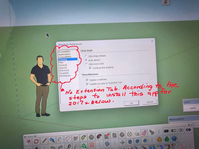

                          Thanks for all your help. In the last picture with the question mark is where we are at a loss to know what to do to grant permission. Picture 2 show all of the users, all have the same permissions but they are grayed out and I can't edit. According to the steps that I need to take to install sketchucation tools for 2017 it shows under the windows preferences preferences an extension tab which I don't have. Again thank you for helping me.2276.jpg [2276.jpg].(/assets/uploads/files/1759067529540-2276-resized.jpg) 2277.jpg 2278.jpg
                          • TIGT
                            Late on in 2017 they changed the menus etc.
                            Preferences no longer linked you to Extensions.
                            The equivalent Extensions Manager then appeared under the Windows menu,
                            later on this migrated again - this time into the Extensions menu.
                            The Extension Manager has its own dedicated dialog,
                            with an Install Extension... button to do exactly what the earlier way did.

                              Sounds good, did you have any thoughts on my other issue you were helping me on the picture that I posted for you in trying to log on to the sketchUcation?

                                Jspro @TIG
                                @TIG Sounds good, did you have any thoughts on my other issue you were helping me on the two pictures that I posted for you in trying to log on to the sketchUcation? I meant to attach the picture where I followed the steps and the results. I'm at a loss to know what to do from here. Really appreciate all your help2276.jpg

                                  TIG Moderator @Jspro
                                  @Jspro
                                  You are NOT getting the properties of your *Plugins folder - that's the SketchUcation.RBZ !
                                  In any case your user account was not highlighted in the dialogs that you snapped.
                                  If that* was and has checked 'Full' [first item], even if it's 'greyed' it should be OK.
                                  Can you please learn how to make PC based snapshots of your screen or dialogs without resorting to actual photographs - it makes reading this very awkward...
