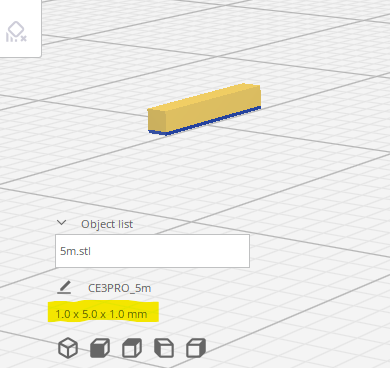

                        Dave has explained this many times, if you are doing this for 3d printing there is no need to scale down.
                        In this image you see what was a 1m by 5m shape exported as 'model units' when opened in Cura you see that it has read that as 1mm by 5mm.

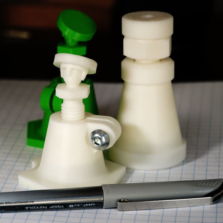

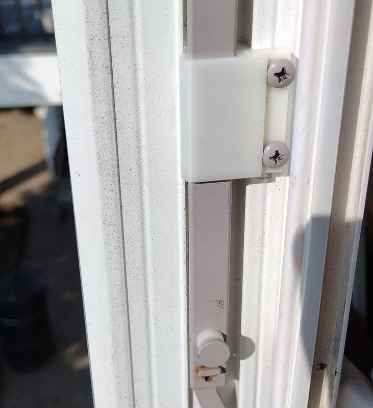

                          I've shown examples like this before. The SketchUp model:
                          And the 3D printed object.
                          No scaling of the model required. The .stl file was exported at Model Units (meters). but the slicer reads the dimensions as millimeters.
