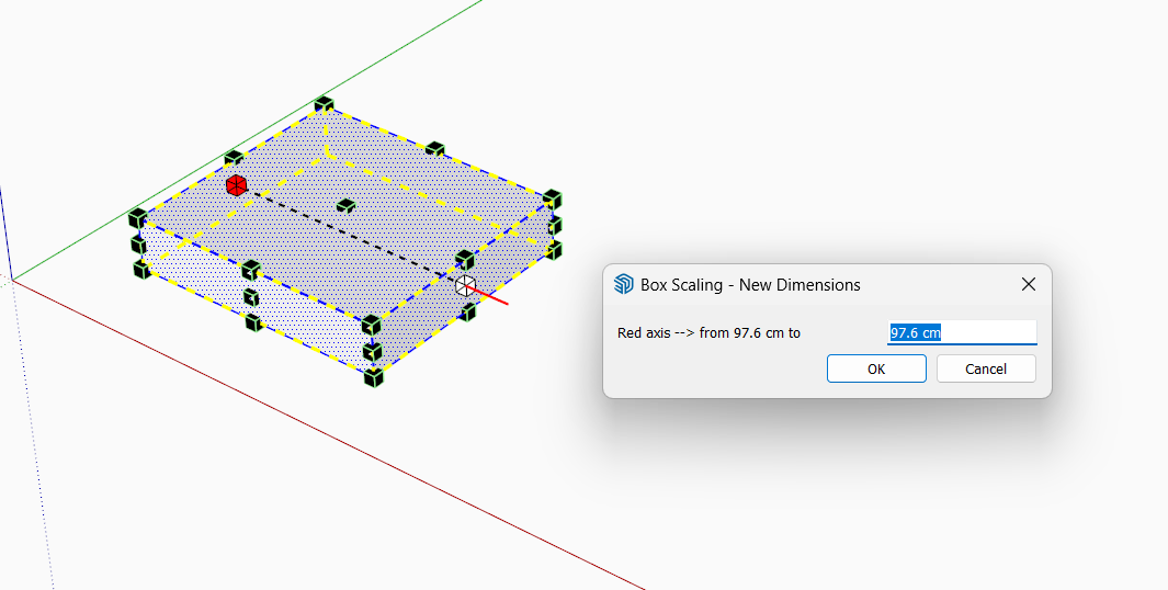

        If I understand you correctly, because I'm not sure what a cold skate is, you want to scale using measurements rather than scale values?
        Pick a handle and press TAB to launch the Box Scaling by Dimensions...

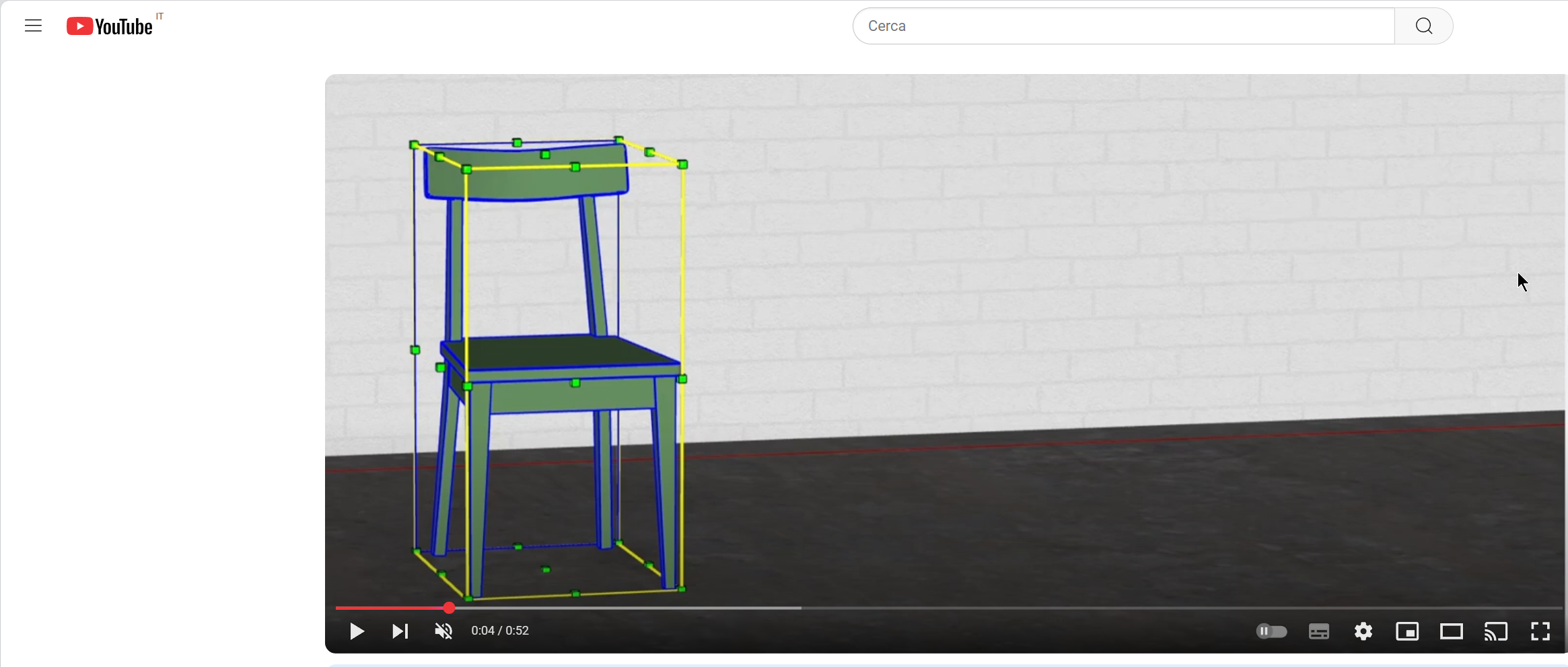

          @Rich-O-Brien Sorry for the English translations anyway, but looking at your picture, you are forcing the scale measurement only on that axis. I wanted that, as in the standard scale, by pressing the Shift key, not only the size of that axis changes, but the entire element scales proportionally
          Video -->>

            Yeah, I understand the request now. Don't stress the translation issue as we got there in the end.
            A uniform scaling from about a point or handle. Something similar was requested for Axyz. It's a good request.
