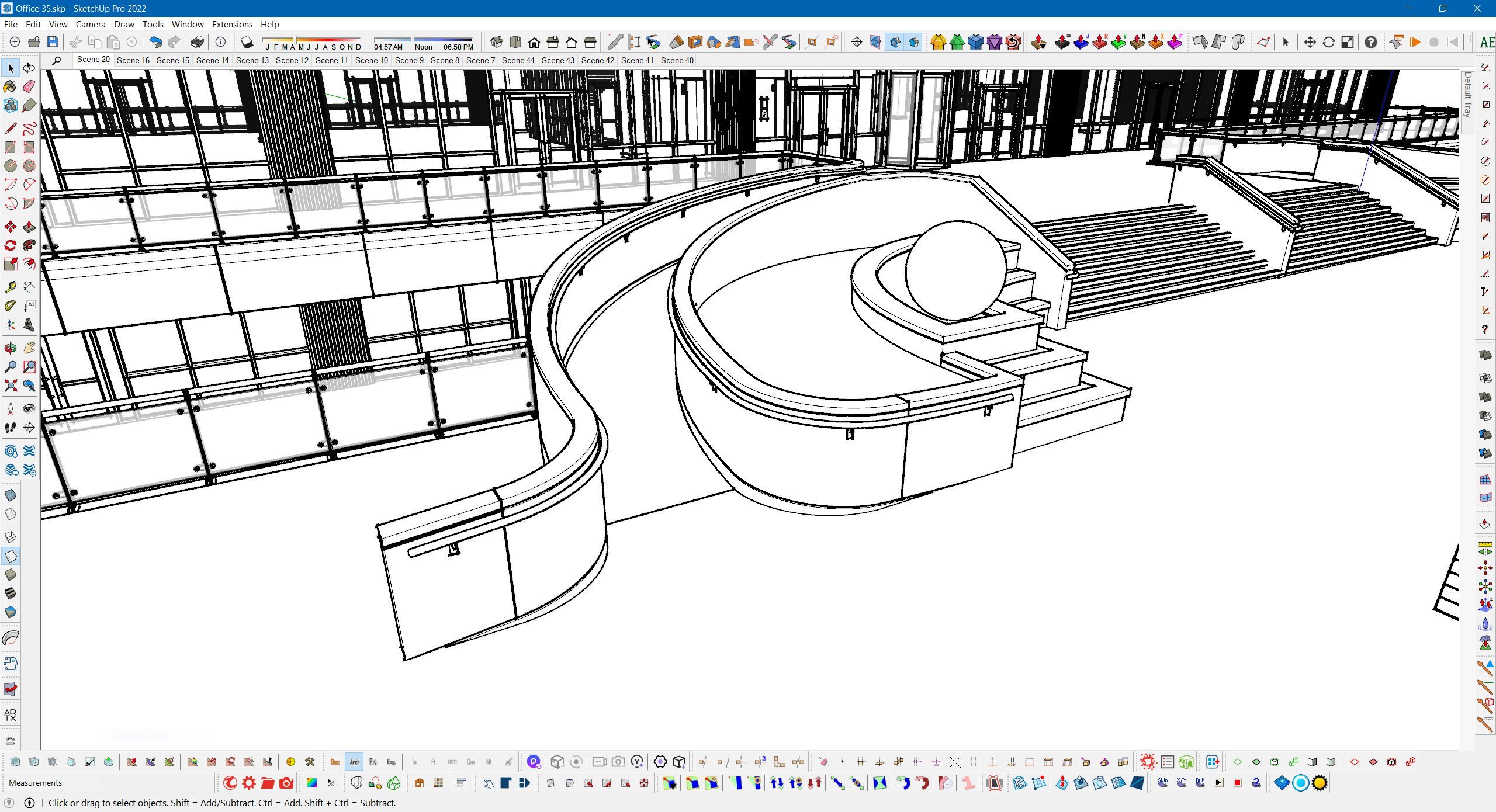

                • Gus RG Offline
                  Gus R
                  I used CurviShear on the plan view for the curves here then extruded with Eneroth Upright Extrude for the wall. I think your curves might be more helical.
